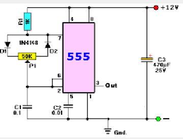

No. The 555 still behaves as an oscillator, but the On and Off times can be independently adjusted to give a PWM output with a duty cycle variable from typically 5% to 95%.
Here's the circuit configuration that Alec is referring to:
Pot P1 allows adjustment of the output duty-cycle over a wide range.

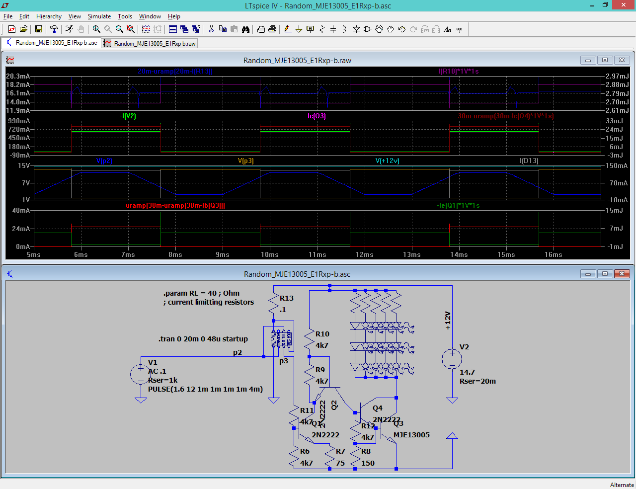

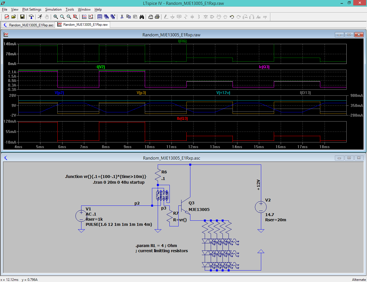

found 13005 model ,
.model MJE13005 NPN(IS=2.58674e-10 BF=34.4393 NF=0.85 VAF=23.8713 IKF=4.47595 ISE=3.99999e-12 NE=3.5 BR=2.23806 NR=0.75 VAR=2.31727 IKR=9.69329 ISC=5.5e-13 NC=3.9375 RB=2.24801 IRB=0.1 RBM=0.1 RE=0.000429335 RC=0.105551 XTB=0.150853 XTI=1 EG=1.05 CJE=1.38055e-09 VJE=0.4 MJE=0.354762 TF=1e-08 XTF=0.05 VTF=0.1 ITF=142.836 CJC=1.68882e-10 VJC=0.4 MJC=0.347144 XCJC=0.1 FC=0.8 CJS=0 VJS=0.75 MJS=0.5 TR=1.91316e-06 PTF=0 KF=0 AF=1 Vceo=400 Icrating=8 mfg=On_Semiconductor)
, did some tests 555-v-13005-Rxp.png 555-v-13005-Rxp-b.png i can't see anything critical unless
  • the resistors are way lower than 40Ω
  • the led-s have a dropout below 3V
  • the switching speed or too slow transitions causes timer chip to overheat
  • or using the 13005 without appropriate heat sink ? significantly increases it's base current ?
  • in common emitter configuration the 13005 requires near-greater-equal but not less than 150Ω shunt from B to E
    -- see update @ #31
    -- i haven't used this particular bjt model in common collector - so i can't make guesses about
found 13005 model , did some tests View attachment 106106 View attachment 106107 i can't see anything critical unless
    -- see update @ #31

i attempted to set up the 13005 based dimmer when i realized that the common collector e.g. an emitter follower setup is not good for current limiting/regulation
  • you can always make sure your led-s not over loaded by choosing the proper resistors **for max Vcc
  • but it's likely more reasonable to build your thing up from 2 modules
    1. a dimmer (generating proper waveform for ↓2.↓)
    2. a led switch (controlling the LED-s current) -- would also ensure enough brightness running from battery only**
as your next concern may turn out the LED-s not holding up
