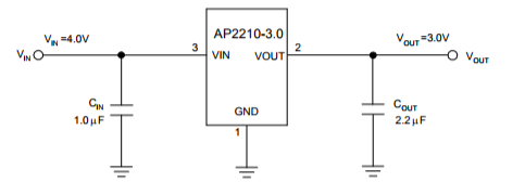

The difficulty seeing the traces is not the picture. They are just hard to see. Here is how a typical 3-pin voltage regulator is connected:
Pin assignments can vary. Here is one arrangement:
See if any of the surrounding capacitors are connected directly to the pins and to ground. One pin should be to ground or to a resistor. Your pin numbering should be the same. That is, the pin on the side by itself is pin 3. But, the functions of the pins can be different.

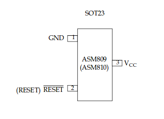

Using the sot-23 drawing above, the #3 and #1 post shows a ground, the 2 post shows open to ground.
The #3 and #1 shows a short to several pins on the U201, The top right U201 closest to the bad chip, pin 1 and 2 gets s ahort beep pin 3 or the third pin down show s short to ground.
On R250 the empty top post shows short to ground eth bottom post gets just a beep. It may be empty like R217. I don't think a resister was in R250, since the lower solder is still a clean ball.
You can clearly see the black plastic has over heated on NEQ2, some black flowed out on to pin #3.
Does U202, supposed to have a hard short to ground on 3 and 1 while the board is not powered up?
A voltage regulator (or transistor) will often have one pin a dead short to ground. Shorting another of its pins to ground (e.g, the output) may be why it failed.
See if you can trace out where those 2 pins go. An intended ground may be to a large "ground plane." A fault to ground would not show an obvious connection to the ground plane. Connection to a capacitor will show a open, but it may show an initial connection that then "opens" as the capacitor charges up.

It appears to be a reset power switch. Could be a random failure or due to a voltage surge, but it also could have acted as a fuse for something downstream that drew too much current..

I believe I just ID'd the part in question
PARTS#: EM6353BX1SP3B-4.6
BRAND: EM MICRO
PACKAGE: SOT23
DESC: 4.6V Reset IC with Fixed Delay
I'm ordering a set.

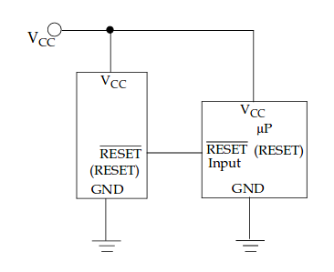

The equivalent part is MAX809, perhaps less difficult to find.
That U202 supervisory chip resets the microcontroler after power is sensed good at powerup. Being fully shorted should not have damaged the microcontroller U201 as its reset pin would only be +Vcc, same as 'not reset' condition.
What I would do is remove U202 from the board, turn it on and after probing Vcc to have a valid voltage, then ground the reset trace that was connected to U202 pin 2 to turn the monitor on.
In other words, if power Vcc is measured healthy, ground pin 2 trace firmly to pin 1 trace and the monitor should resurrect. Have video in when doing that.
'Healthy' means well filtered, no spikes and steady. If an electrolytic went kaput causing all this; replace first.
