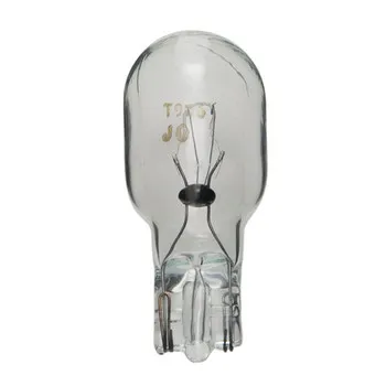

Can it be a 300 Ω resistance from a 0.48 Watt 0.04A 12 V lamp instead ? As an automotive incandescent light bulb ?
Where is the mental fart ? Wattage must be the same ? Bulb has to be able to work on the 120VAC drop voltage ?
240V-------------------------12Vlamp300Ω---------------------------Fanmotor-----------------------neutral
The resistance of the bulb of 300 Ohms would only be at 12 volts.
For other voltages:
At 1v: maybe around 30 to 40 Ohms.
At 12v: 300 Ohms.
At 120v: infinite resistance because it blew out.
This is fairly easy to imagine.
If you want to drop 120v, then whatever you put between the wall socket and the fan must be able to handle 120v. A 12v bulb can not handle 120v or even 24v without blowing out rather quickly.
On the other hand, if you want to use it for a flash bulb for taking pictures in a dark room then maybe you are on to something :)
