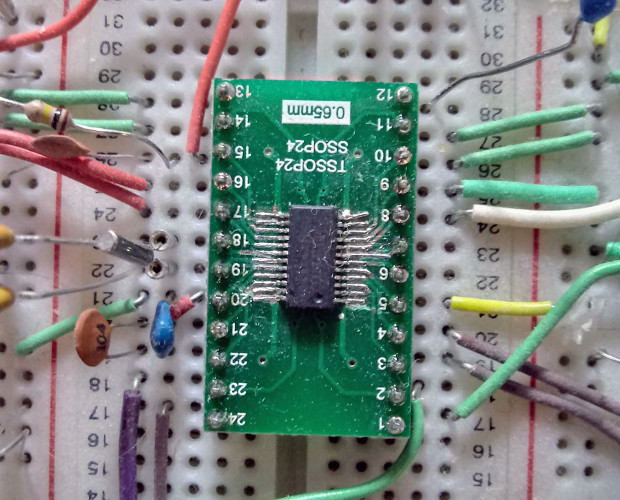

I did this 24-pin SSOP with the same (or similar) land pattern width over three years ago - I was really proud. I took a long time and I was dragging beautifully - did not have to use any braid at all!
119487

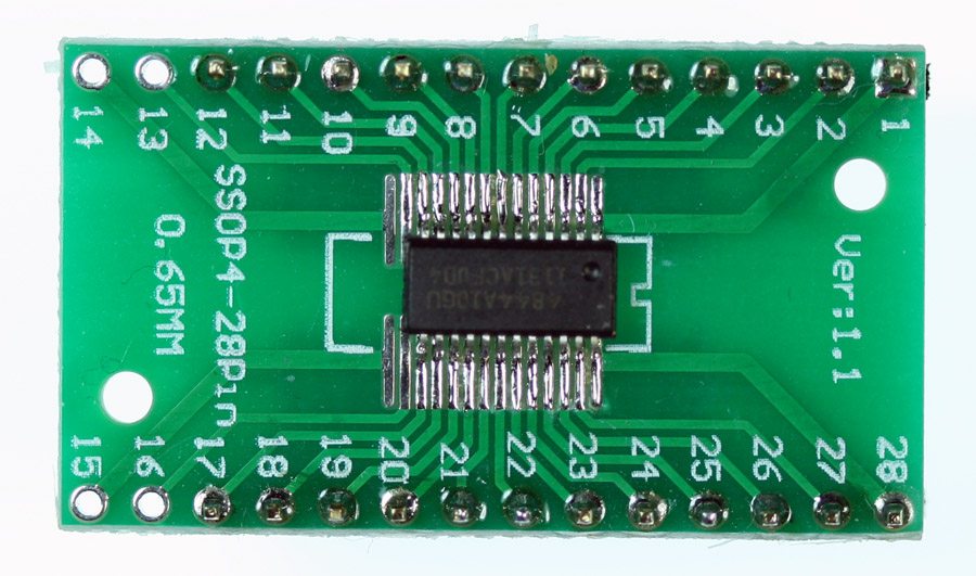

Advance the clock to a couple of months ago and I did this one and made a mess of it! I had to use braid and I was very frustrated. Granted, I did not have the thinner solder as with the first time (I rectified that). Well, it worked, eventually, but ugh.
119489
In both cases I used magnifiers (like this one).
I have one more like this to do and I hope I am as neat as with the first one.
So, could I do it - yes, I think I could IF I was using a breakout board as shown here with those nice long pads. If it were on a circuit board proper, maybe not.
DrG, looks like you need more flux and maybe turn your heat up a little (or clean your irons tip)

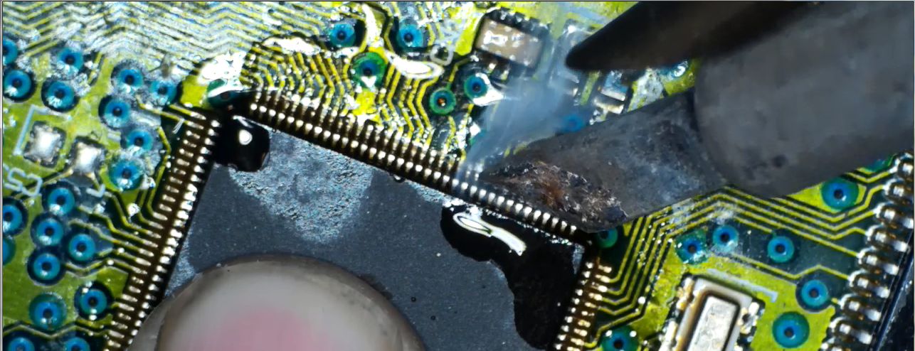

here is a 9s12 LQFP144 I just did last night
My hat is off to you...you could add "younger eyes and hands" to the list as well. More seriously, I always worry about lifting pads with higher heat. Moreover, and frankly, I would simply not attempt what you are showing there....maybe with a hot air gun and paste like is used in those home-made toaster-oven SMT board makers...but that is "on the list". For now, I was successful in both tries...that will have to do...for now ;)

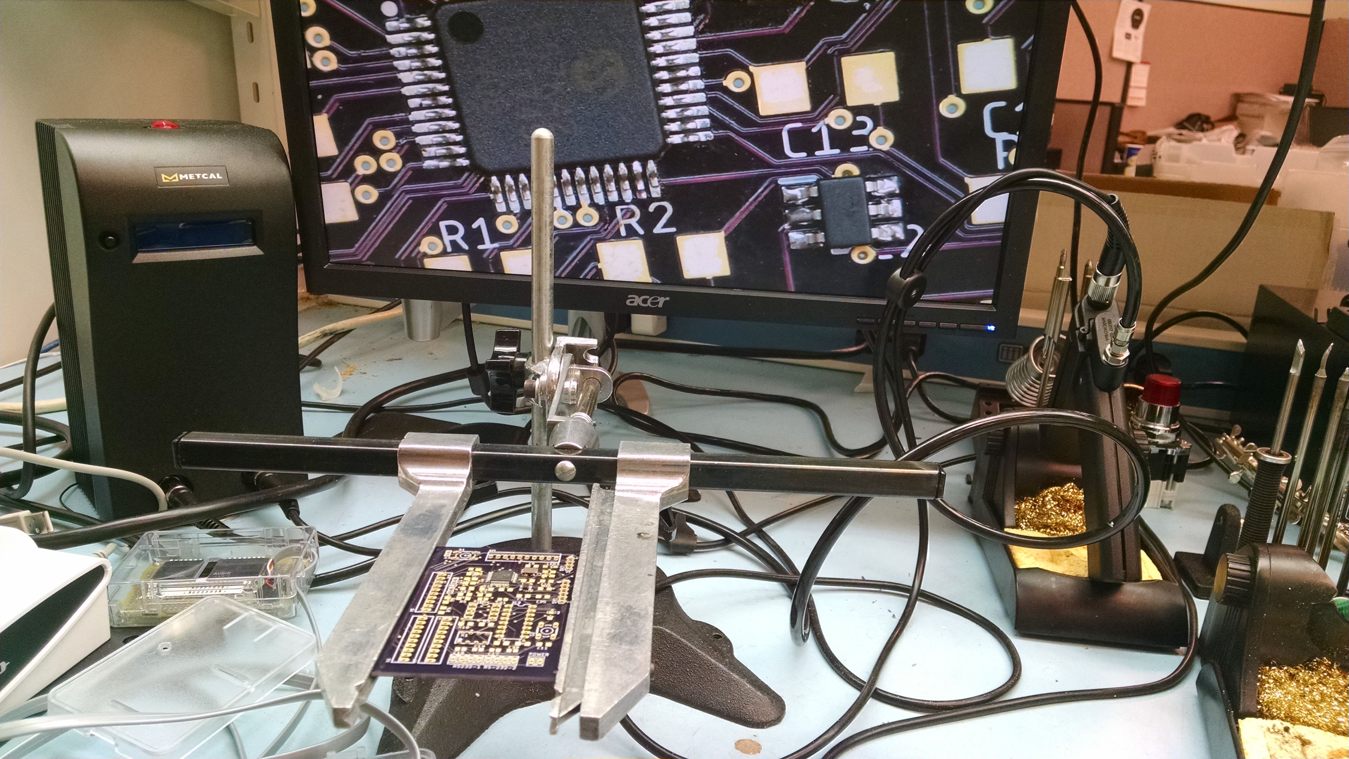

I used to could do these with out magnification but not as well anymore. I use a setup similar to spooks with a 20x-100x scope.
I like to solder hot and quick. Usually around 320-360c. Long as you don't spend to much time in one area you shouldn't hurt anything.
Pick up a cheap hot air rework station. You can get ones at around $50 that work just fine for light duty/hobby work. Your second photo would have cleaned up beautifully with a little reflow using flux and hot air.

I found , solder braid ( mop ) essential to remove excess solder and bridges .. I have a desk mounted magnifier and lamp ... on 4 sided chips after a corner tack I do one side at a time , and wait till chip cools, i dont have a temperature controlled iron just a Antex 12 watt ... with .5mm point
Do you have one? What's the mag power? Cost?
What I have is toooo much money and very old. I like that I can have the magnifier up out of the way then by shaking my head the glass falls down over my eyes. My problem is that it takes one hand for the solder, one hand for the iron, one hand for the solder wick, I hold the part down on the board with my tail, then just as I get near the part I need to hold the magnifier glass. All slightly above my pay grade.

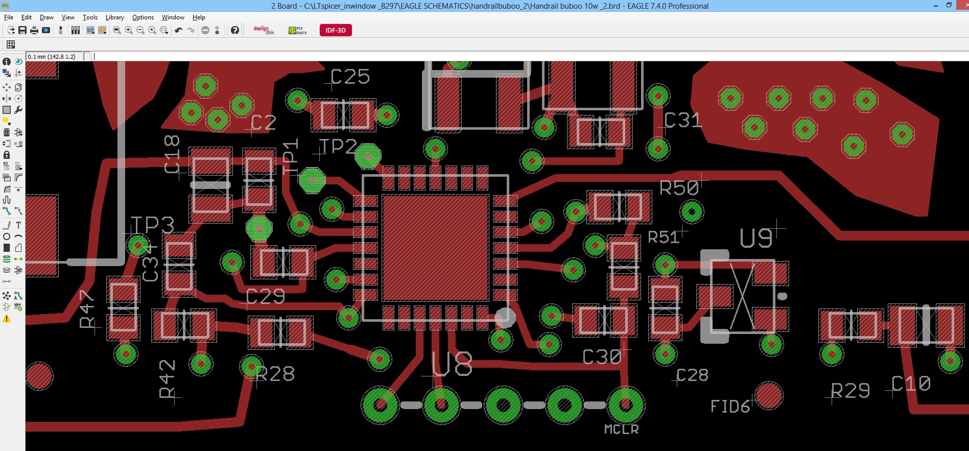

Thanks for all these great replies, I think we will just have to end up trying to solder it without soldering the centre pad, as some of the small pads of the QFN achieve a ground connection anyway.
The footprint pads emerge 0.3mm outside the QFN body outline all the way round.
We have got a hot plate but I am not convinced a great deal of heat will conduct through the 4 layer FR4 PCB. Some other components on the top side are already placed, as we needed to run the board manually (without the micro) first.
Hot air-gunning i think is best if you actually aim it at the dead centre of the chip and try and "burn" it on through to the tinned solder pads?
