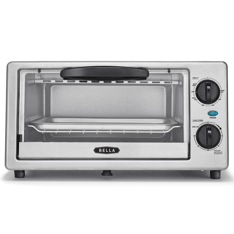

I use a oven to heat up the entire board at one time. The center pad will solder well that way. I payed $5.00 at the used appliance store for the oven. It takes about 10 minutes to solder a board. Bring up the temp slowly and watch the heat level.

Thanks, and i like the idea of the bella oven to actually do a reflow , having stencilled in a solder flux pattern on the footprint.

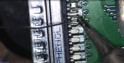

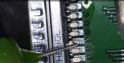

Do you think its possible to hand solder the 28 pin , 6x6mm QFN version of the PIC16F18856 by hand soldering? Eg…dragging solder along the pins, then mopping the excess up with braid?
I've done it a bunch of times. The secret is to use plenty of good flux, good quality solder, and a soldering pencil at the CORRECT temperature. You shouldn't even have to use braid to clean it up. There are many demonstrations on YouTube.
