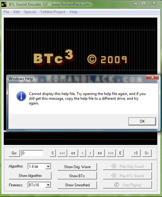

Wombweller - Hmmm can't open the help file in Vista?? I use the Microsoft Help Workshop to create the .HLP files. You think that Microsoft's Vista would open help files created in their own help file workshop program... :(
But I guess Microsoft make billions from releasing new software that causes problems with their old software. ;)
I wonder if it's because I used the compress option to keep the .HLP file smaller?

(edit) I just put up the help file, this time it is the uncompressed version. Maybe this one will work with Vista? The 2 files needed are in this .ZIP file;
https://www.romanblack.com/BTc3_help.zip
Mr RB, thank you so much for the talkbot! I just got it today and wow, its all set up and ready to go. Just be careful guys, don't erase the file in the first 5 minutes like I did :p
Has anyone with Vista tried the new help file I put the link to in post #55?
Hi Mr RB.
I have tried and it's the same result.Attached is a copy of the message.
The problem lies with the WinHlp32.exe as Vista does not come with this loaded as previous products did.
I down loaded the exe and now I get what you see in the message.
I cannot open Help files that require the Windows Help (WinHlp32.exe) program
Oh you get the same message even when not trying to open via BTc.
Hope this helps.
You got any advice on writing a C code with the serial commands in? website tutorial or anything?
Any other methods of sending the serial commands to the Talkbot?
Regards
