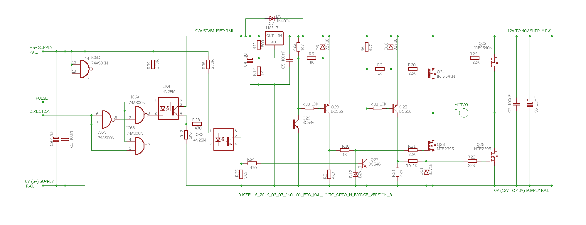

Q35 should not affect how fast Q27 turns on based on where Q32 is placed in the circuit. R24 will get V+ directly through the opto and if we're talking 40V then it will be 39.40V/470Ohms = 83mA and 3.27Watt. (even at 24V+ it's more than 1 Watt)
Well you certainly know your way around a data sheet kal. You are quite correct- sloppy design by me.
Also for a 40V+ supply, I will be exceeding the absolute maximum voltage of the Opto detector Vceo of 30V.
Nice bit of data sheet sleuthing again kal. You have just detected a bit more sloppy design by me. I just looked at the first part of the data sheet and saw 70V max VCE when that was the 'not to exceed without damage VCE' rather than 'operate OK VCE', which is 30V as you say.
If any of this is correct, I could place R35 higher (before R24) which resolves the current issue and add a resistor to pull down the base of Q27 to turn it off quicker.
You are on the right lines but there appears to be an error on your schematic in that the input signal for QN1 is connected to 0V.
But there will still be the issue of exceeding the voltage rating of the opto detector.
For that I could put a voltage divider and everything would look like **broken link removed**but I have concerns about the lack low current in case of 12V+ supply.
Once more, you are on right lines but the voltage modulation caused by the resistors in the collectors would slow the opto receiving transistors down a bit.
Post #88 shows a revised schematic of the H bridge which I hope takes care of the problems you have highlighted.

Here is a revised schematic of the 12V to 40V H bridge.
(1) I have dropped in an LM317 three terminal voltage regulator to generate a stabilized 9V voltage line for for the opto receiving transistors. I tried out a few other approaches but a voltage regulator is the simplest, cheapest and easiest approach I could find quickly.
(2) You may be wondering why 9V rather than 11V which would have been optimum for the opto receiving transistors, when you take into account the approximately 1V drop in the emitter circuits. The reason is practical: the LM317 voltage regulator has a minimum drop-out voltage of 3V and the minimum H bridge supply line voltage is 12V (12 to 40V) so 12V-3V= 9V.
I could have designed a circuit that would produce 11V from the 12V supply line quite easily, but it would have been more complicated. I could have used a low dropout (LDO) voltage regulator, but they are less common and more expensive, and finding an LDO regulator that would stand a 40V input requires a bit of research.
(3) You may like to investigate a suitable three terminal LDO regulator if you have the time. Go for one with at least 100mA current capacity. Linear Devices, Micrel and Maxim have some good LDO regulators, but you need to ensure that any part you choose, is well behaved, available, cheap, and is going to be available in the future (main line product) or a suitable functional replacement is going to be available in the future. With three terminal voltage regulators you have no worries in this respect because they always will be available, besides which, if push came to shove, you could even roll your own three terminal regulator.
(4) There is a major goof on both of my previous H bridge schematics in that the OV of both the 5V and the H bridge voltage rails are connected. This has been corrected in the ERRATA for both schematics.
ERRATA
(1) 9VV STABILISED RAIL should read 9V STABILISED RAIL. (typo only)
(2) Zener diodes type should read BZX79-18, not BZV18.
(3) R12 should read 1K1 not 1K
NOTES
(1) C6 value, (10 mF) means 10,000 uF
(2) The value of all capacitors in this circuit can be increased provided the same capacitor type is maintained. Normally capacitor types are low frequency decouples (aluminum electrolytics) or high frequency decouplers (ceramic, polycarbonate).
(3) Capacitors can always be wired is parallel to make up a particular value, but they should not be wired is series.
(4) Component tolerances should be +-10% or tighter unless otherwise stated.
(5) D5 can be any 1N400x, where x is 2 or higher or any other rectifier diode with a forward current of 1A or more and a peak inverse voltage (PIV) of 50V or more.
(6) It is advisable, but not essential, to use metal film or tin oxide resistors
(7) All resistors are 500mW unless otherwise stated or calculations show that 250mW will be adequate.
(8) Any 18V 500mW to 1W Zener diode can be used in place of the BZX79-18, for example 1N5249B.
(9) Strictly speaking, the logic gate should be a 7400, 74AS00, or 74S00 to provide at least 10mA current sink for the opto transmitting diodes, but a 74LS00 will be acceptable.
