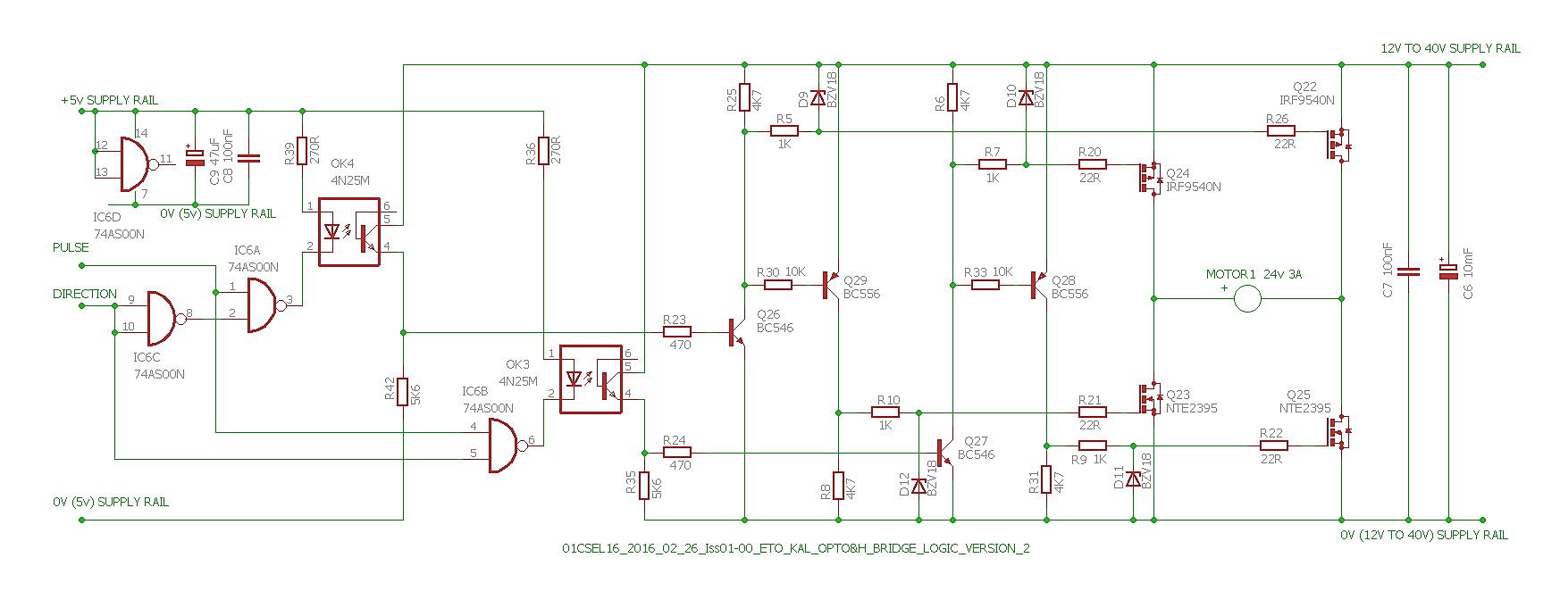

Here is a version of the post #40 bridge circuit which should work OK with a bridge supply voltage from 12V to 40V:
OBSOLETE PLEASE SEE POST #88
ERRATA
(1) Motor M1 should not have a voltage or current rating.
(2) OK4 emitter disconnect from 0V(5V) SUPPLY RAIL and connect to 0V (12V to 40V) SUPPLY RAIL

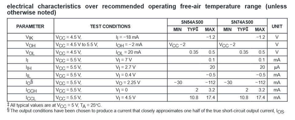

(1) IOL
If you look at the above extract from the 74AS data sheet, you will see that, as you say, Iol is not listed in the left hand column under its own right. But if you look at Vol, you will see that Vol is specified with an Iol of 20mA.
The spec sheet is not really complete, but it is still more complete than it need be. That may sound like a contradiction, but here is the explanation: The 74xxx logic families all have the same logic functions and pin out (not strictly true). The only difference between the families is speed and current characteristics.
Thus, there is a set of generic characteristics for each family so, unless there is something special about a particular chip, it is not absolutely necessary to include the generic characteristics on the individual data sheet for each device. To give an example, all 74xxx have an Iol of 16mA while all 74ASxxx have an Iol of 20mA. Most digital designers know these generic characteristics of by heart and rarely need to refer to a data sheet to check them.
Why is there a difference? In general in electronics, if you want more speed, you have to use more current. So, the faster the chip, the more current it will use. Consequently 74xxx chip inputs source 1.6ma when the input is driven to logic 0 (0V) and the faster, 74AS chip input sources 2mA when its input is driven to logic 0. It follows then, that the output of the chip driving these inputs must have sufficient sink current capability to generate a logic 0 voltage level. In general, 74xxx logic is designed to have a fan-out of 10. That is, each output will drive 10 of its own family, more or less at full speed. This is the reason for the differing currents.

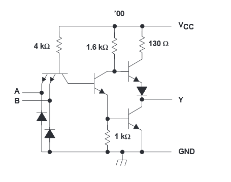

When you say that logic gates do not source or sink current that is not true. For example the original family 74xxx chip will source 400uA minimum and sink 16ma minimum. An integrated circuit is no different to a circuit that you would make out of resistors capacitors, diodes and transistors (but having control of the fabrication process chip designers can do some really fancy things which cannot be done with discrete components). In fact, you could quite easily make a 7400 NAND gate from discrete components.
Complete 7400 2 input NAND gate (the twin emitter input transistor is not as weird as it seems and could be replaced by two individual transistors connected in parallel)​
The output stage of a TTL chip works in exactly the same way as the discrete transistor LED drive that you used before; it connects the cathode of the LED to 0V so that LED current flows from the positive supply line, through the current defining resistor, through the LED, through the lower transistor in the gate output and down to 0V.
When the logic gate output goes high the LED turns off fast, because the gate output is active high (totem pole) and sources current to rapidly charge the parasitic capacitances. On the other hand, a transistor switching off would provide no route for the parasitic capacitors to discharge, so the LED would turn off slowly and could cause all sorts of problems with the bridge circuit. In practice, you would add a pull up resistor from the transistor collector to the positive supply line to charge the parasitic capacitors.

Going by your attached schematic I see you are now using EAGLE :cool:
I may have lead you astray when I said that the output of a logic gate driving the optocoupler LED is the same as the transistor you had been using. In principal that is correct but, whereas the BC546/BC556 has a maximum VCE of 65V, the open collector output transistor of the 74LS38 only has a maximum VCE of 7V. You can get 74xxxx open collector chips where the output transistor can take a higher voltage though; these are normally called open collector driver chips or similar. The 74xxx07, and 74xxx17 are examples: http://www.ti.com/lit/ds/symlink/sn7407.pdf
As for the 74LS00 chip with the totem pole outputs; you have been been mistreating it most shamefully. :eek: The 24V supply line will drag the totem pole output up to around 24V when it is only speced to a small voltage above the chips actual supply rail voltage (it is worth remembering that, as a general rule, forcing any chip pin outside the supply rails is one of the most destructive things you can do).
The voltage divider R2 (1K3) and R1 (4K7) across the 24V supply line gives 5.2V which you are using as the supply line for the chip. This voltage would be OK if it were not for the 74LS00 5V supply line current. The 74LS38 has a similar problem. From the data sheet, the 74LS00 ICCH (5V supply rail current for a single gate with output voltage high) is 1.6mA max and ICCL is 4.4mA. There are 4 gates in the pak so the total worst case current is 4 * 4.4 ma = 17.6mA. This means that the voltage on the supply pins of the 74LS00 would collapse and could be anything below the required 5V, including 0V.
In conclusion, the only practical way to drive the LEDs with 74xxx logic when only a 24V supply is available would be to generate a low impedance stabilized 5V supply line using a 5V three terminal regulator (LM7805, LM7905 etc). You should then also power the LED from the stabilized 5V rail, rather than the 24V rail.
The other less serious problem is that there is no decoupling capacitors across the supply line. The 74xxx chips would not like that. I would recommend a 100nf minimum ceramic capacitor for high frequency decoupling in parallel with a 47uF minimum electrolytic capacitor for low frequency decoupling. As a general rule of thumb, all supply lines need to be decoupled for high and low frequencies, even simple low frequency circuits which you may think couldn't possibly need decoupling. Remember that the average small signal transistor has a Ft of at least 200mHz and it will not know that it is only performing a low frequency function. The transistors inside a 74xxx chip are incredibly fast so decoupling/good layout is mandatory.
I am afraid that any 74LSsxxx chips that you have connected to the 24V circuit will be toast or at the very least unreliable and should not be trusted. Should you wish to keep them for investigation you should put a distinct cross on the chip case to indicate problems so that the chip in not inadvertently fitted to one of your circuits: I have many components with crosses on them :banghead:

Is SN74HCT00N (74HCT00) a typo, because according to the data sheets:
(1) IOl= 4mA compared to 8mA
(2) IOH= 20uA compared to 400uA

I tried wiring the chip in so many ways and jumpering the unused inputs and nothing worked except when I grounded the pins.
What do you think? ..

This to me is like a PNP transistor where the base has to be pull down to ground for it to work. That the puzzling part. It's working backwards from what it's supposed to.
Yeah, it is confusing- you make me smile: I felt exactly the same when the 7400 logic chip came out in the 1970s. Just remember that a logic gate is not like any transistor. There is no connection between the current and voltage flows on the input and output (not always true). In essence there is no difference between a current flowing into an input or a current flowing out of an input: they are just currents. In electronics, generally, you can design for any polarity of voltage or current. In the valve (tube) days this was not always possible because there is no such thing as a valve equivalent of a PNP Bipolar Juction Transistor (BJT), P type Junction FET (JFET), or P type Metal Oxide Semiconductor FET (MOSFET).

Hi spec, hope you're having a great Sunday,
I was looking at the components I will be needing for the 12-40V version of the circuit and had to come back to this comment.
Q35 should not affect how fast Q27 turns on based on where Q32 is placed in the circuit. R24 will get V+ directly through the opto and if we're talking 40V then it will be 39.40V/470Ohms = 83mA and 3.27Watt. (even at 24V+ it's more than 1 Watt)
Also for a 40V+ supply, I will be exceeding the absolute maximum voltage of the Opto detector Vceo of 30V.
If any of this is correct, I could place R35 higher (before R24) which resolves the current issue and add a resistor to pull down the base of Q27 to turn it off quicker. But there will still be the issue of exceeding the voltage rating of the opto detector.
For that I could put a voltage divider and everything would look like **broken link removed**but I have concerns about the lack low current in case of 12V+ supply.
What do you think
Cheers
Kal
