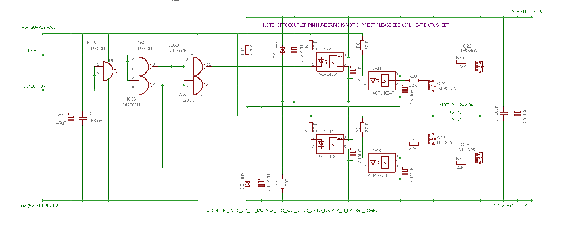

Hi again kal:
Here is a faster version of the opto coupled MOSFET H bridge. It uses four optocouplers with built-in MOSFET drivers (link to data sheet below). Once again, this is an off-the-boards design, so look for obvious errors. I couldn't find the actual optocoupler in the EAGLE library so I used the closest, but some of the pin numbers are not correct.
spec
ERRATA
Optocoupler data sheet:
https://www.mouser.co.uk/ds/2/38/acplk34t-267604.pdf
I wasn't able to find the optos locally but I found some nand gates that are not exact but hopefully will work.
I got MM74C00N and MC14012B The first is Motorola but the second I'm not sure of the make but it has the logo like this one here. I got two of each so I can use to of the latter of they're better.
I believe the MC1402B is dual not quad nand gate and they're both CMOS whatever that means. Still reading to find out the difference. Cheap though.

Morning from the UK (7am) kal,
Afraid the 74C00N, while it has the correct logic function, does not have enough output sink current capacity. 10mA is required by the transmitting LED in the Avago ACPL-K347 optocoupler. That is just the DC conditions though. To get a fast signal transfer across the optocoupler, you need to hit the transmitting LED hard and fast. Ideally a sink current around 30mA would be good and a source current of around 20 mA. This may sound odd, but the excess current is required to charge and discharge those little buggers, the parasitic capacitors.
The logo that you show is for National Semiconductor, one of the best semiconductor manufacturers who, sadly, were taken over by Texas Instruments in 2011 (Texas are a very good semi company too). You also mention Motorola, another top-line semi manufacturer. Their semi operations were spun-off and renamed ON Semiconductor in 1999.
There are two main logic families: TTL (Transistor Transistor Logic) (74xxx) and CMOS (Complementary Metal Oxide Silicon/Semiconductor) (14xxx). TTL is fast and high power consumption. CMOS is relatively slow and very low power, if it is not switching almost zero power. The other logic family, which is not very common, is Emitter Coupled Logic (ECL) and its close relation PECLE (Positive ECL). This logic family is blindingly fast and chews up current like nobody's business, although PECL is less power hungry. ECL needs a perfect PCB layout, using high-speed strip-line techniques and proper termination. Only real men mess with ECL. :D
The 74xxx family predominated so the 74Cxxx family was brought out which is essentially 14xxx CMOS, but with the same pin out as 74xxx family chips.
The minimum sink current for a 7400 gate is 16mA compared to a sink current of around 1mA for a 74C00 gate.
74xxx logic can be quite confusing, because there are so many variants with different speed and power characteristics: 74CTxxx, 74HC, 74Lxxx, 74ALxxx, 74ALSxx, 74xxx, 74ASxxx, 74Sxxx. The good thing is that, in general, the logic functions, and pin-outs, are all the same, although 74Cxxx and 74xxx will not interoperate. Just to confuse the picture more, the 74CTxxx logic family is designed to operate with 74xxx.

No worries kal
All good experience- I wish I could have a twidle with some electronic hardware . But no facilities at the moment.:wideyed:
By the way the transistor version of the H bridge circuit will probably be fast enough anyway. It can be speeded up here and there too.

Hi spec,
I hope you don't mind me bringing this thread up again.
I'm starting to work on another H-Bridge to drive another motor and would like the control voltage to be independent of the motor voltage (Source-Drain) voltage. The idea is to be able to drive different motors with different voltage rating but with the current and power rating of the H-Bridge.
So the gate of the MOSFET will need to have a path to the drain and I'm guessing that that means I would have to share ground between the two supplies or can I do it like in this **broken link removed**? (this is only half of the schematic the control side is not showing but it will be exactly like yours).
Kal
Hi spec,
Kal
Hy kal,
I don't mind in the least- it would be a very odd situation for me to mind about discussing electronics. :happy:
I understand that you want to dive a motor with a different V/I characteristic, but I can't quite understand your approach. My thought in the example you showed is why not just change the supply line from 24V to 20V and call it a day. I'm pretty sure that the original circuit will work fine, although, from a purist point of view, a few resistor values should be adjusted here and there.
If you needed a bridge circuit to operate over a wider range of voltages, the design could be changed from ratio-metric to absolute without too much bother. Just let me know if that is what you want and I will look into it.
But to answer your question about the posted circuit: afraid no, it will not work. As you say, it needs a common 0V line between the 24V (0V) supply line and the 20V (0V) supply line, plus two other mods. Here is what needs to be done:
(1) Connect 0V (24V) to 0V (20V)
(2) Remove R13 top from 24V line and connect R13 top to 20V line
(3) Remove R11 top from 24V line and connect R11 top to 20V line

Hy kal,
I was referring to the one at post #40.
OK will have a think about circuit at post #40
I'm still learning to use Eagle and it takes me forever to draw the schematic.
Hmm, EAGLE circuit capture is dead easy, although the component libraries are a mess. EAGLE is by far one of the easiest in my experience and I have used/evaluated a number of ECAD systems. Some of the more advanced/expensive packages are a pig because it takes an age to set them up. Mind you once you get that done and have gained some miles, they are very powerful and accurate, especially the error checking and digital sim. EAGLE 7.5 is better to use than 7.4 but the user interface symbols are pants.
The way I understand how MOSFETS work is that they need gate-drain current (gate voltage) to tun on the drain source current.
That is not correct kal. The drain source current is proportional to gate drain voltage. No current flows into the gate. In fact, there is a layer of highly insulating silicon compound between the gate and the silicon channel (silicon between the drain and source).
One complication about driving the gate of a MOSFET are the massive parasitic capacitances. This means that, at DC and very low frequencies, you can control a MOSFET gate with a voltage with a very high source impedance, say 1M Ohm. But for any higher frequencies you need a lot of current to charge up and down the parasitic capacitors so you need a low impedance voltage source to drive the gate.
You mean a potential difference between gate and drain? I see, it's coming back to me now how you explained it before.
So if I have 36V at the drain of Q22 there will be two scenarios for its gate, The first is when Q26 is low there will be 24 volt and 36-24=12 which means the Q22 will be turned on and current will be conducting through drain-source. The second scenario is when Q26 is high, there will be 12V at Q22 gate and 36-12=24 which means it will be on even harder (or may be exceeding its limit, I have to look at the datasheet).
Well, back to the drawing board :D
