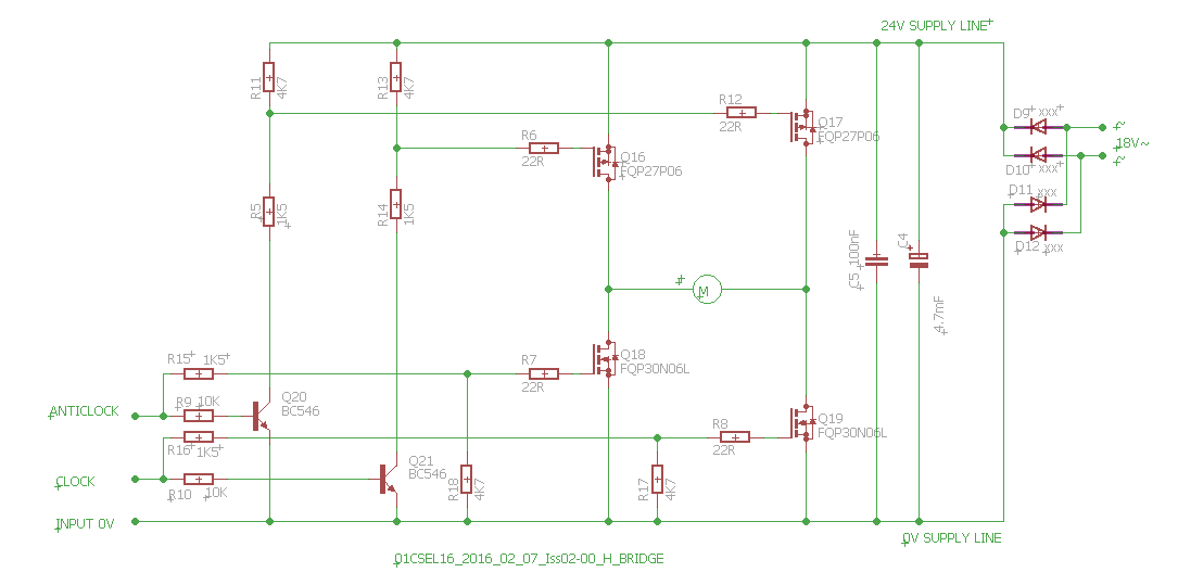

Hy again kal,
Here is a circuit that you may be interested in.
Rectifying 24V AC with a bridge rectifier will produce (24 * 1.414)-2V =32V. If you want a 24 supply line the AC voltage should be (24 +2) *0.707= 18V approx
If clock input is made 18V or more the motor will turn clockwise
If anticlock input is made 18V or more the motor will turn anticlockwise.
If both inputs are either open circuit or taken down to 300mV or less the motor will be off.
Clock and Anticlock inputs must never be enabled at the same time or the MOSFETs will pass excessive current and blow.
A safety function could be added so the if both inputs were high the MOSFETs would not turn on and the circuit would be safe

kal,
You have spotted my errors. No wonder you had difficulty in trying to understand the circuit function. I will have a rethink and get back to you :banghead:
Give this circuit a try kal:
(1) If clock input is made 24V the motor will turn clockwise
(2) If anticlock input is made 24V the motor will turn anticlockwise.
(3) If both inputs are either open circuit or taken down to 0V the motor will be off.
(4) Clock and Anticlock inputs must never be enabled at the same time or the MOSFETs will pass excessive current and blow.
(5) A safety function could be added so that if both inputs were high the MOSFETs would not turn on and the circuit would be safe
(6) To be controlled by a micro, this circuit would require some mods to the input. This would be fairly simple

No probs kal,
apologies for errors- you did well to analyze the circuit and find the problems.
There is nothing complicated about the circuit. It just turns opposite NMOSFETs and PMOSFETs on so as to reverse the polarity of the voltage across the motor.
You don't need catching diodes to handle the inductive load of the motor, because they are built into the MOSFETs, as shown on the schematic symbols, as a function of their fabrication.

Hi spec,
Alright I think I understand what's going on. In the first schematic if I use IRFZ44N for P-Channel MOSFETS and NTE159 for N-Channel MOSFETS the +-20VDC (which I will be using) with a 24VAC rectified to 32DC then it's all good. (minus the zener diodes)
The second schematic is for the MOSFETS specified in it. (Except you changed the input voltage to 18VAC/24VDC)
So **broken link removed**is what how I would like to do it and I would like a hint on how to protect against both inputs being on at the same time. I will also be using optocoupler and was looking at your diode AND gate on the the other schematic and tried my best to do an XOR but it's not happening. Are there optocoupler with a built in XOR logic or something of the sort?

Hi kal,

Only simple integrated circuits, thru hole, not surface mount. Yes wiring but no programming.
I forgot to ask about rectification. I have a GBU605 which I will be using and I connected the transformer to it, the measurements were 28.18VAC out of the transformer and 25.13VDC out of the bridge rectifier.
It sounds like you are measuring the voltage out of the bridge rectifier without the reservoir capacitor connected. You need to connect the reservoir capacitor (4m7F in circuit), then you should get (28.18V * 1.414)-2V = 37.85V DC off load.
Do they put something in there other than diodes and capacitor to regulate the voltage?
It depends on the application. You can put a voltage regulator circuit after the reservoir capacitor to provide a stabilized (constant) voltage if required
Would using 25VDC instead of 24 work alright or should I recalculate the resistor values?
Yes, 25VDC would be fine. Absolute accuracy is not necessary with a circuit like this.
