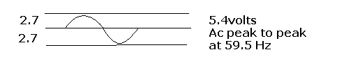

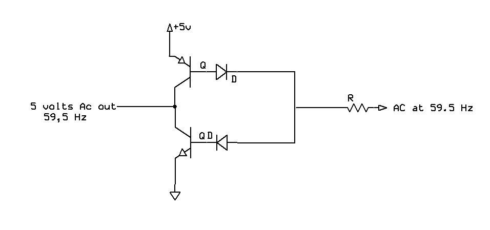

I did some testing using a step down transformer A 12volt 800ma was what I had handy.
I made a half bridge switch it with the step down transformer gave me a matching 59.5 hz
that the line is at.

Well I look at it with my scope the switching side not the same as the mains side but there
both 59.5 hz. The switching side is some what square wave but with a little work it would do the job.
