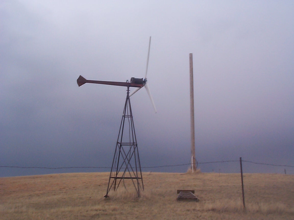

ONE home made wind generator.

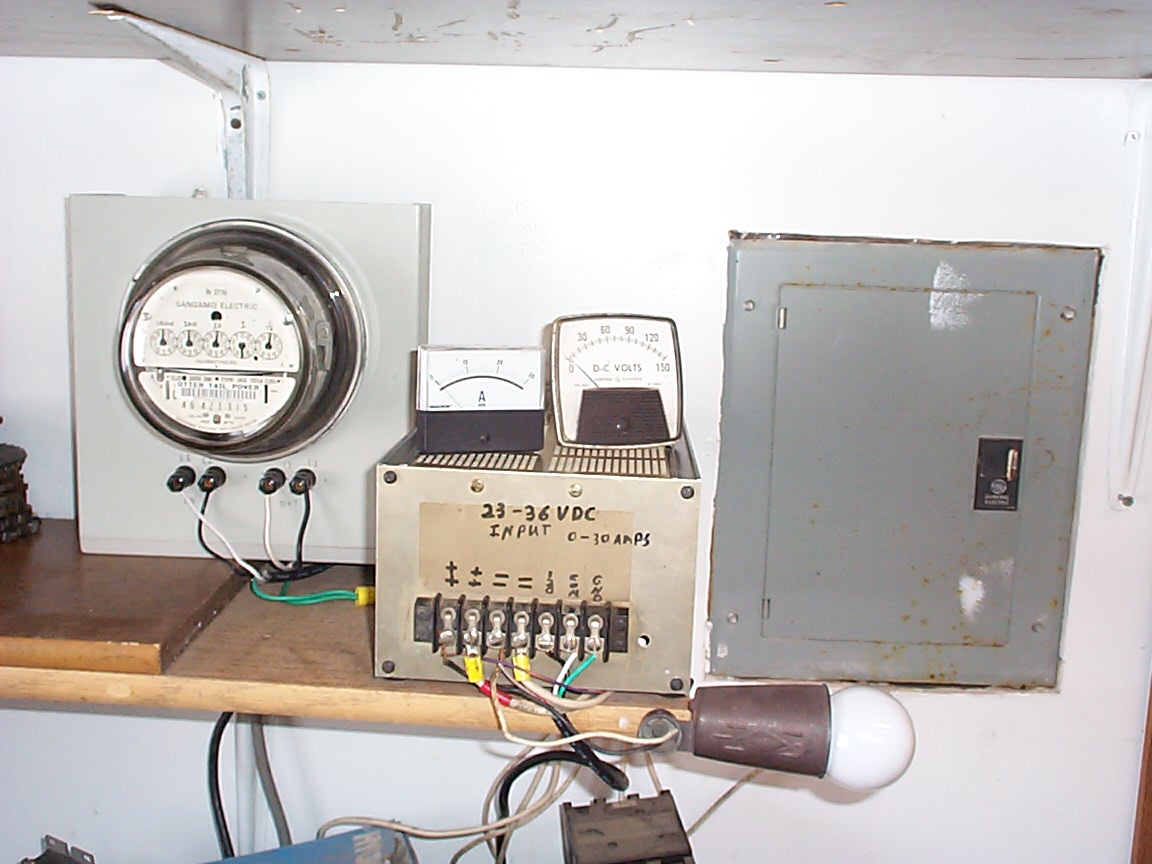

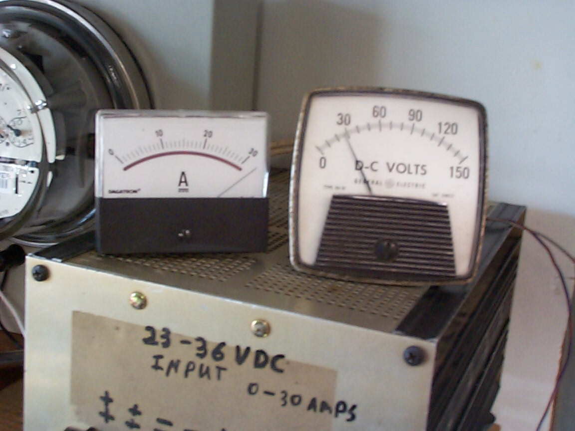

ONE home made GTI With actual gages showing the input amps and volts coming from the home made generator on a windy day.
ONE complete home made GTI system with watt meter.

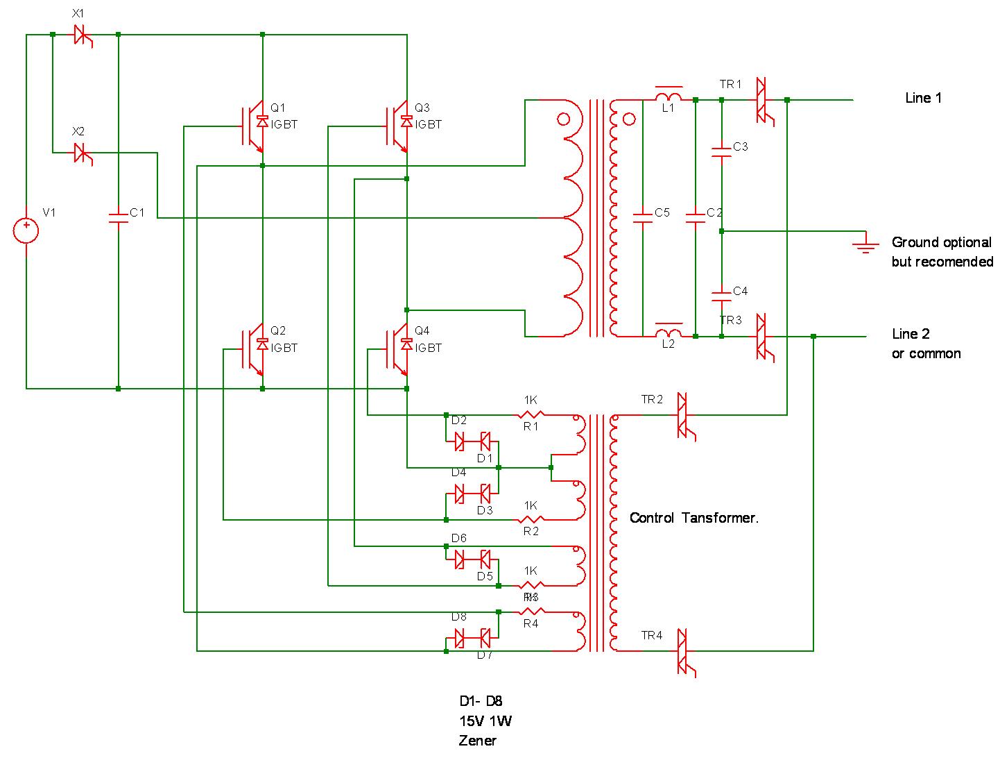

AND one complete schematic of the power handling circuit.
And My standard offer to all of the doubters that I have ever came across.
JUST STOP BY MY PLACE AND HAVE A LOOK FOR YOURSELF! I HAVE NOTHING TO HIDE. BRING ANY METERS AND MEASURING EQUIPMENT YOU WANT TOO! I WILL EVEN LET YOU TAKE MY STUFF APART AND STUDY IT AND TAKE PICTURES AND VIDEO TOO!
And it your really serious, bring the sheriff and a lawyer too! I will even take bets on the workability of my designs!
(I just want the sheriff and lawyer present for when you are actually required to pay up on the bet!) :p
If your serious, just pm me and we can discus where I live and when your coming.
Although like every doubter I have ever met I already know you wont show! ;)
I've played this baiting game far to many times already to get fooled by it! :)
If you thinking of guerrillas I can assure you there are no monkeys here!
But I am seeing some poo flinger's!;)
I just passed you the ball! You wanna play or what? :D
3 photos 1 showing a probably damaged ampmeter by now and yet another incomplete schematic showing no references to other schematics.

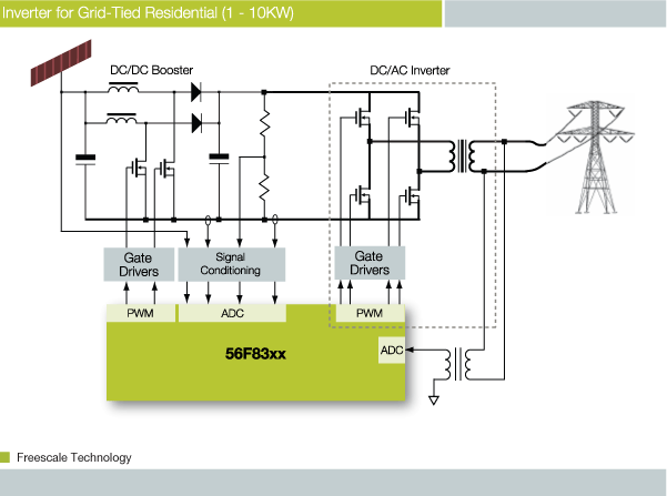

Grid-Tie Inverter
Making small grid-tie inverters (250 watt) may be fun and educational, but scaling up to something more practical (2kW to 4kW) may prove to be challenging.
In order to minimize wire losses in bringing power from a roof mounted photovoltaic array to ground level or basement where the electronics box is mounted, the PV array is wired in series to generate between 150 and 250 volts. This reduces the current to a reasonable level and allows for smaller gauge wiring to be used. A pre-regulator is then required to boost this voltage to a useable level and keep it steady as the PV voltage fluctuates depending on the amount of sunlight available.
Current designs favour an interleaved PWM boost topology to eliminate a step-up transformer for higher efficiency and lower cost.
One such design, published by Steve Ward, can be used as the front-end of a high-power boost converter. See his web page at: 12kW PFC Boost Converter
Although Steve uses his boost converter for an entirely different purpose, I feel it could be adapted for the application described above. Simply remove the AC input and replace it by DC coming from a PV array. Follow the boost converter with an H-bridge and transformer as per Freescale design clip below.

So how are you getting 850 VDC output? And what are your local utility line voltages?
Tell me more about your system and how you came up with the design!
We all want to know!
Got any pictures? :)
I dont know everything there is to know by any means and most of what I have given out is just the bottom end basics. I would be happy to help with a custom design!
Would you want to do it independently or would you be interested in starting a new thread related to a big GTI like say 5 -10 kw with much higher input and line voltages?
I think it would be helpful doing most of the layout work here so others can benefit from our work. Plus there are many here with great electrical and electronics back grounds that jump at any chance to catch my mistakes!(and occasionally just help out too;)) :D:)
So far there is this original thread, the 250 watt thread, and my tiny GTI conceptual design. I would like to round off the set with a big multi kilowatt GTI myself.
For a big GTI thread I would be willing to give up the basic schematics for the more advanced H-Bridge control circuits and PLR based monitoring system. The H-Bridge control circuits have proven reliable in longer term real life running conditions on the smaller units but the PLR program is what I am currently still fine tuning for my big test units.
But ultimately I would leave it up to you and the readers to pick out what would be most practical for yours and their applications.
So far the highest experimental GTI H-bridge circuit I have tested is running at around 450 volts peak. But since I do not yet have a wind or solar power source that can supply that at tens of amps I have only done the testing off of a 12 KW gas drive gen set. So I do not have testing numbers from real life long term usage to work with.
I dont see any reason why a 850 volt system couldn't be done practically.
It's basically just changing the H-Bridge and power handling components and and modifying the control system voltage dividers to read those higher values.
There are IGBT's Rated for 1600 to 2500 volts now and at high amp capacities too. Same with the rectifiers and capacitors. So component wise there is no real limitations. :)
If you would like start a new Thread relating to it. It would give everyone a clean start to work from.
Until the nutters waist a few pages on pointless run around arguments that have been thoroughly discussed and already covered in this and the 250 watt GTI thread. Plus add there usual space wasting rant posts.:(

If it turned out that isolation between the DC and AC was required, it makes a lot of sense to do it at the boost converter (high frequency) rather than at the line attachment (lots more iron and copper).
Of course that would make the final stage a lot harder to troubleshoot, since they would always be hot with respect to your test equipment.
