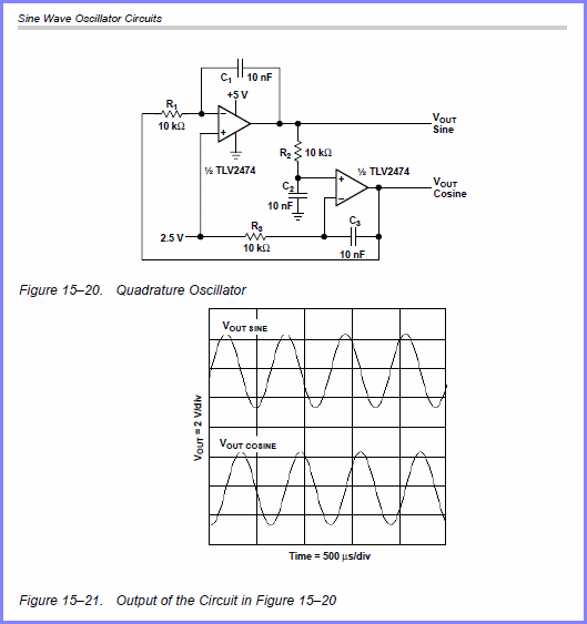

Please can someone tell me how I can generate a sine wave and cosine wave with the option of changing the frequencies of the output waves? I understand it can be done through op amps but I'm struggling to find anything of use through my research?
You need to search for "Quadrature Oscillator" in Google.
One source is the eBook "Opamps for everyone" by TI.
Op Amps for Everyone Design Guide (Rev. B)
Under the Section of "Quadrature Oscillators" I found the following circuit.
Yeh, I've tried to simulate this but I can't seem to get it working? Is there an input signal to this setup or does it just generate the sine wave and cosine wave when powered up? To change the frequency, I guess I need to change the values of the resistors and capacitors?

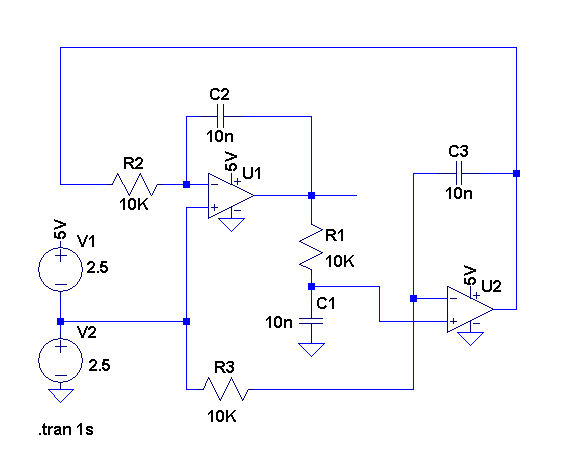

I tried but it also failed to oscillate in Swcad3. Can someone helps?
Anyone wants to try, here is the circuit file.

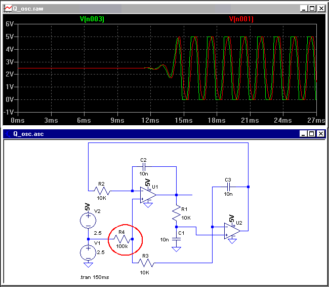

I managed to get the circuit oscillating but the distortion is horrible.
I guess it has something to do with saturation of the Opamp output and lack of amplitude stabilization control in the feedback loop.
Yes, you need stabilising to give a sinewave - that's probably why it wouldn't oscillate before, and now you've increased the gain until it does, but too much.

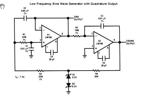

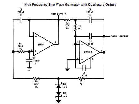

These two circuits output sin/cos
