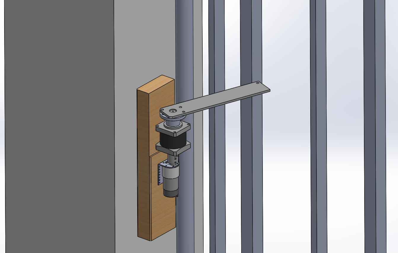

Hi All,

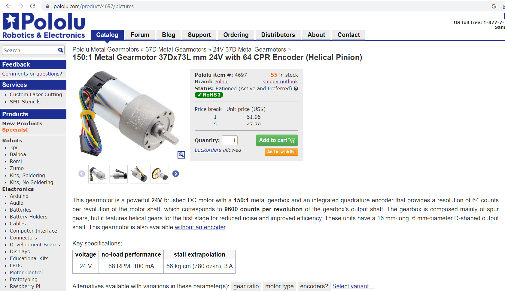

I am attempting to open a driveway gate with a 24v motor amplified by a 10:1 gear train to get me to 500 kg-cm of torque. I was told I needed an H-bridge for the bi-directional motor control. The motor stall current is 3A, so most motor drivers I have seen can do up too 2.6 continuous current, 3A transient current, so I guess these drivers will not work.

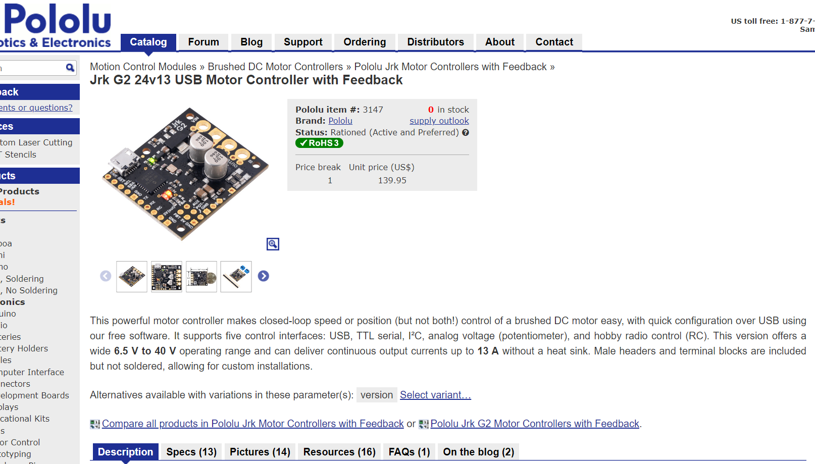

2) I found a controller that can do more than 3A (Jrk G2 24v13A) but it is a hefty $140. Before I make this purchase I want to discuss with y'all regarding this! (I still want to shut down if amperage gets out of control here and i'm not sure how too do that).

ps. I will add a chain to the end of the armature to pull the gate closed in clockwise operation. Counter clockwise operation, the arm will push the gate open.

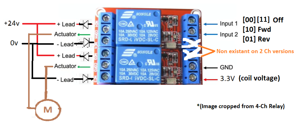

You are so observant. In my effort to understand this module better, I could not find a datasheet, only this website. It has a -05v- in the part number, so I erased it since it is not what you suggested. What is the bottom right potential for (post #17)?

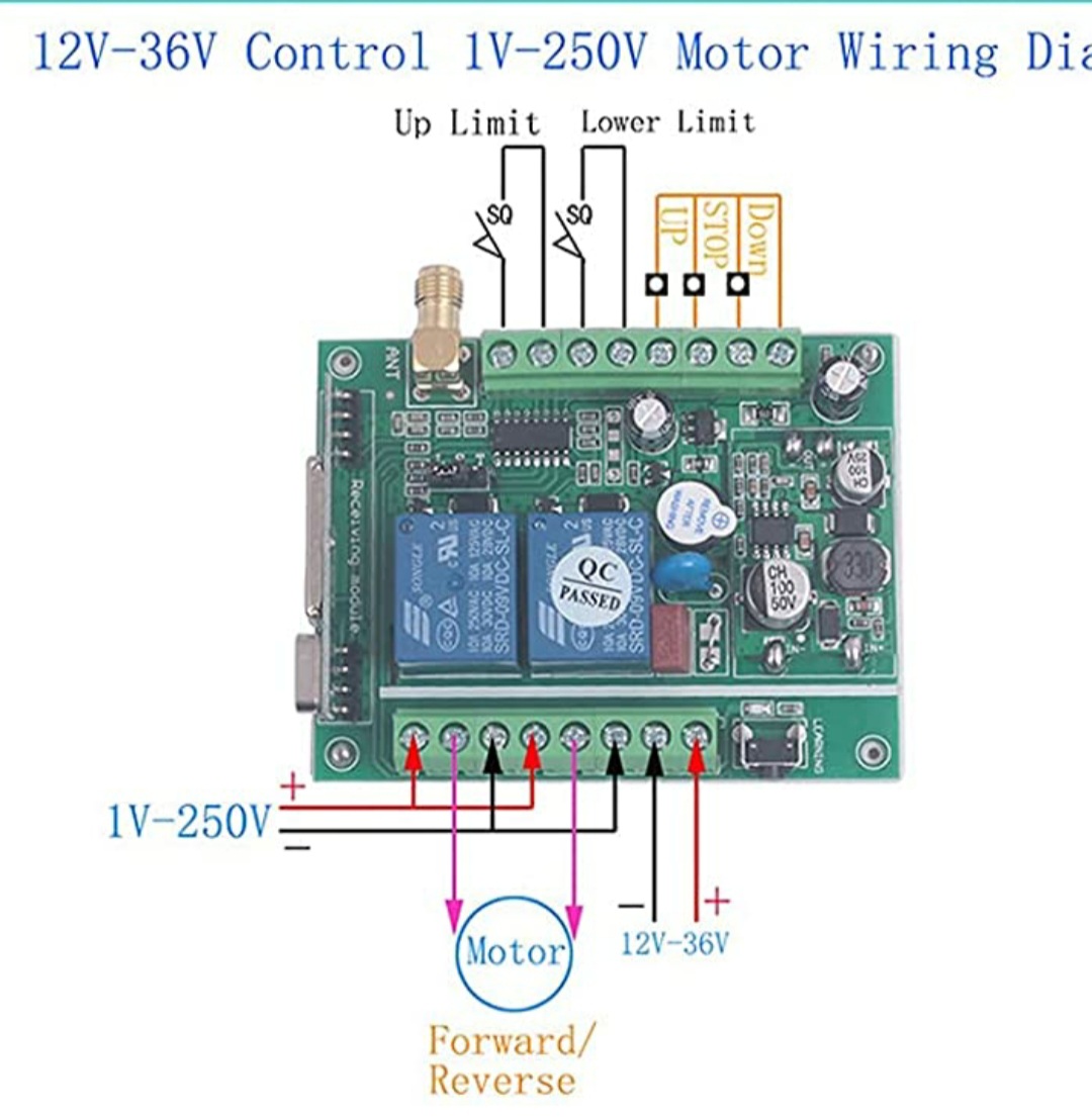

I have two options, first there is an encoder that comes with the motor so i can keep track of the angle possibly. Knowing this probably wont work due to error in physical systems (gear backlash namely), i was thinking of adding a trip sensor to signal gate open/close status to microcontroller, then shut the motor off using logic ([00] to the 'input' at the module). I'm not sure using limit switches would work since something can block the gate causing the controller to think it was closed.
Just to give you more a little more system info, I eventually plan on using a RF 433Hz Tx/Rx pair to provide the commands to Pi (just ordered them to play with). So I plan on sending a HIGH/LOW to a Rasp Pi GPIO input & the gate latch using a key fob.
I am still curious about the diodes, so whenever you have time (no rush). Thank you!
You NEED limit switches, it's a vital feature for such applications - and a crucial part of safe design. Complicated electronic methods are all well and good, but are much less effective, and much less reliable - by all means use such methods, but it's VERY important to have limit switches as backups.
As for current detection - that's simple enough, a low value resistor in series with the motor, with an opamp (or two) monitoring the current through it, and feeding an analogue input on the PI.
You also need IR beams for safety purposes - all this is basic gate technology.
Why not just buy an existing gate controller, which already has all the facilities you need?.

You're right, there are extra pins due to me taking the image from that site which sells 4 channel relays only. Sorry for the confusion.

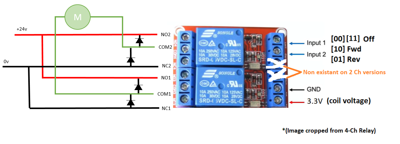

I may have found a 2 Ch 3.3v version. that being said, I have updated the drawing using your diode comments and the assumption that 'Vcc' and 'Gnd' is for the coil voltage and can be triggered with 3.3v. I can still use the module you suggested if you think it doesn't matter much (i'd prefer to use amazon anyway).
I am not 100% clear on the jumper pin config from the site above which states, "VCC is the system power supply and JD_VCC is the relay power supply, use with the jumper cap". Does it mean I have the option to power the whole module using motor voltage (24v) or Coil voltage (3.3v)? I would want these to be at separate voltages, yes?

No, you are 'perhaps' getting further away? :D
The bottom right connection (labelled 3.3V in your latest picture) is 'possibly' nothing to do with the relay coils. It's the power feed (from the PI) to the top of the opto-coupler LED's - the modules commonly have a link you can fit to join the top of the relays to it as well - although this particular example 'may' have that permanently wired, so has no separate relay power feed.
These pages show the usual schematic of these types of modules:
You need to check, and confirm, that any modules you use are wired to do exactly what you want - with the modules in the links I just gave, you could power the opto-couplers from the PI at 3.3V, and have a separate 5V feed for the relay coils. It's always a good idea to separate the relays power supply from the processors power supply - in the case the relays could be powered from the 5V that feeds the PI, with the 3.3V PI output feeding the opto-couplers.
I've been looking round for 3.3V versions, and they seen pretty rare - on closer inspection many that claim 3.3V actually require a 5V supply for the relays, but here's one that actually uses 3V relays:
Yes, that relay is a 3V version and requires about 150mA of 3V (or 3.3V) power for Vcc.
Do you have that available?
No option.
It requires 3.3V power for everything.
That is incorrect.
The diodes do not go in series, they go between the actuator and 24V and between the actuator and 0V.
Read my post again.

Omg Ok I think I got you now.
I am still not clear about what the jumper setting is for? I can play with the module and see what it changes.
It's shown in the schematics I linked to - it joins the opto-coupler and relay power connections together - by removing it you can power them separately.
Have you attached a battery and switch to manually activate the motor to check for stall conditions and capability?
The gearbox helps, but an overheating electric motor becomes a fire hazard if heat and current aren't detected by the controller or external sensor. As for the bridge idea, adequate relays may be the only solution.
Hi Shokjok, I have not thought about the motor burning, but a stall current of 3A shouldn't burn it up. Typically, stall currents are not healthy for the motor as long as it doesn't happen a lot. I do plan on limiting current in software somehow, or using a current limiting circuit, I just haven't had the chance to build the system yet to see where it can be added. Perhaps as a fuse, or breaker, or in a software driven behavior. I have a lot of the parts now and am putting it together! I am very excited.
