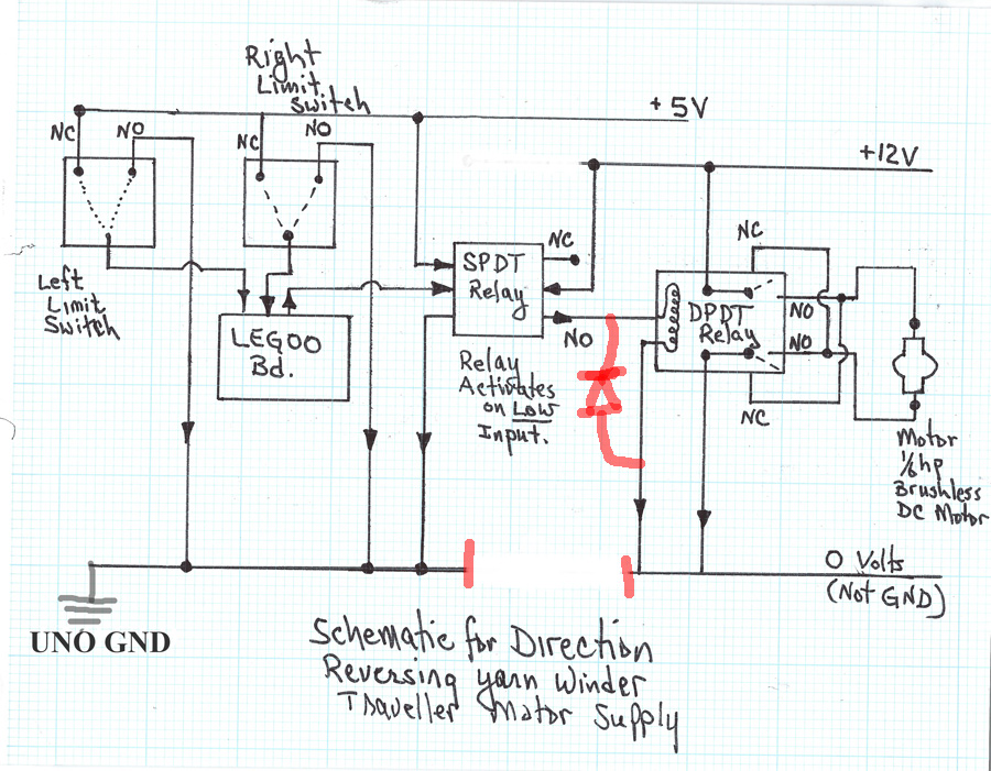

Ok, everyboody, the schematic and INO file (the Legoo Code) are attached, The schematic is unique to me so this is the original. There is a bit more wiring to run the motor that turns the winder, but that is separated from this stuff, and the only logic to it is a start signal from the Legoo board so the winder and traveller motors start essentially together. I'm pretty sure I have some 10k resistors in house so I can easily add those to the outputs of the limit switches. Also, for those following the thread, the DPDT relays have an internal LED and resistor, but I would have to do some digging to find where they are connected. I do know the led only flashes when one of the two limit switches is hit, but that is probably because in one direction, the polarity does not activate the led. If anyone needs a word doc version of the code I can provide it.

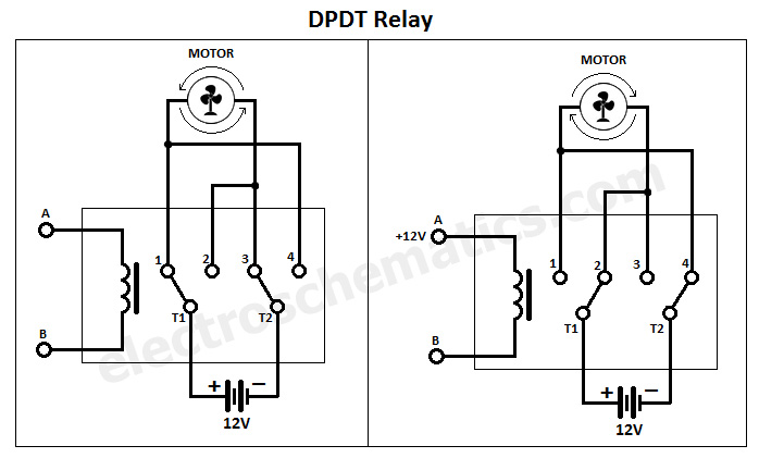

Your motor is hooked up like this:
From:**broken link removed**
Your motor is always on and when the relay (call it the motor relay) is operated, it switches direction.
The motor relay is operated by the Songle relay (call it the UNO relay).
OK, so why are you bricking UNOs?
I think you should:
1. Remove the path from the 12V power supply/gnd to the UNO. There is no reason to have those GNDs connected at all.
2. Add a diode across the motor relay coil - something like a 1N4004 - even though it is being energized by the contact of the UNO relay.
So, your schematic looks like this:
and you have added resistors on the limit switches.
BUT:
Is that motor relay capable of switching a 10A inductive load? Do you have specs on that?

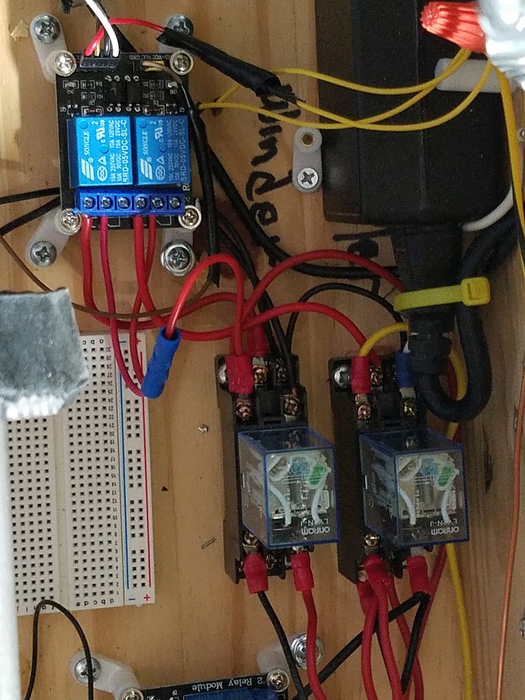

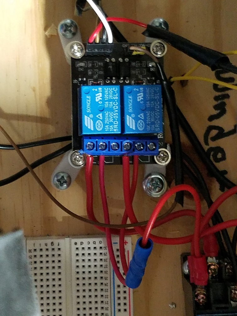

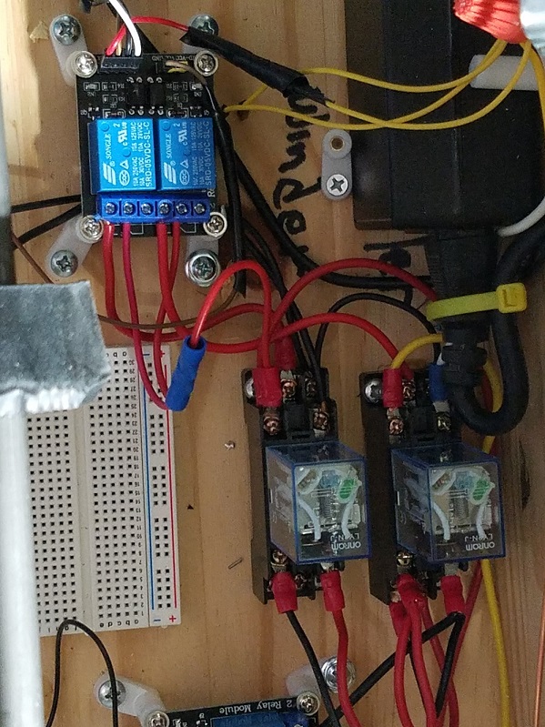

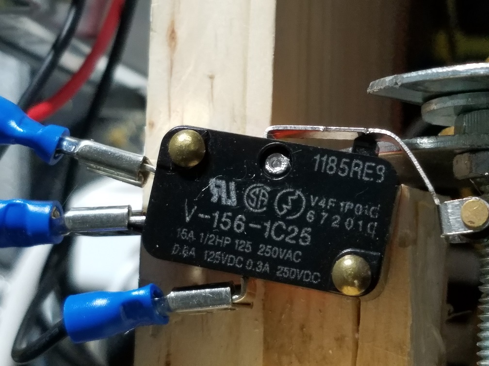

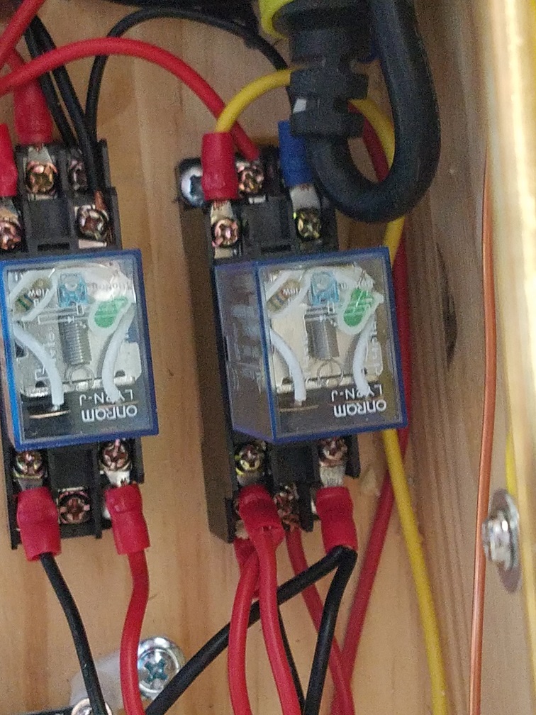

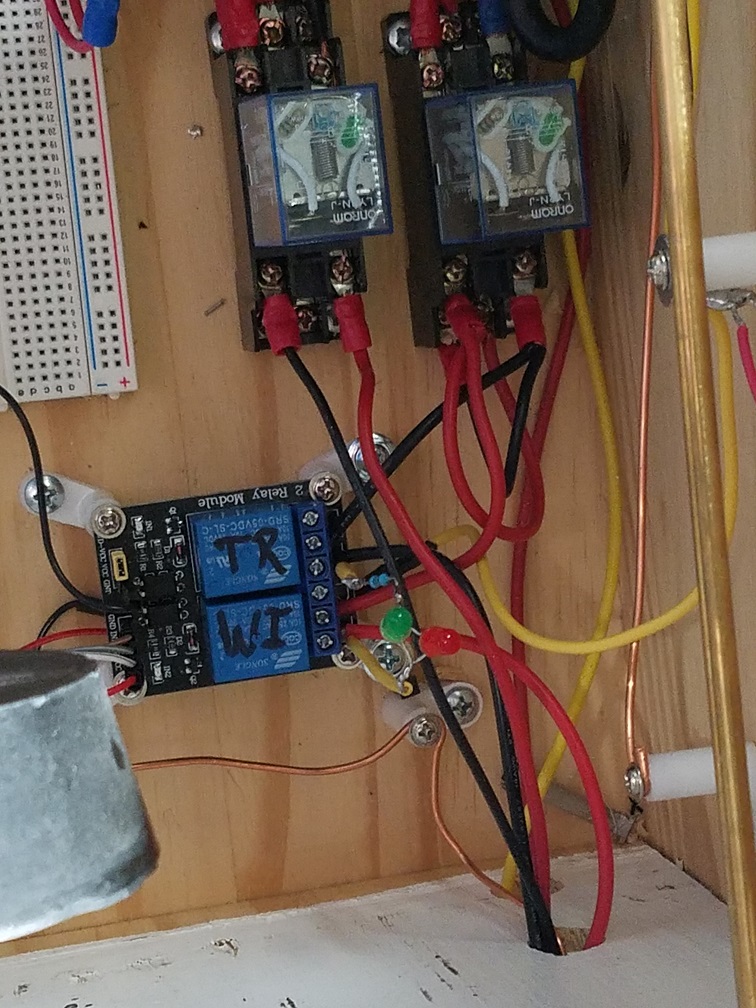

Attached below are eight pictures of my equipment and the local wiring. I havre not made suggestedchanges yet. will start them in the morning now that pictures are uploaded

Thanks for that info.

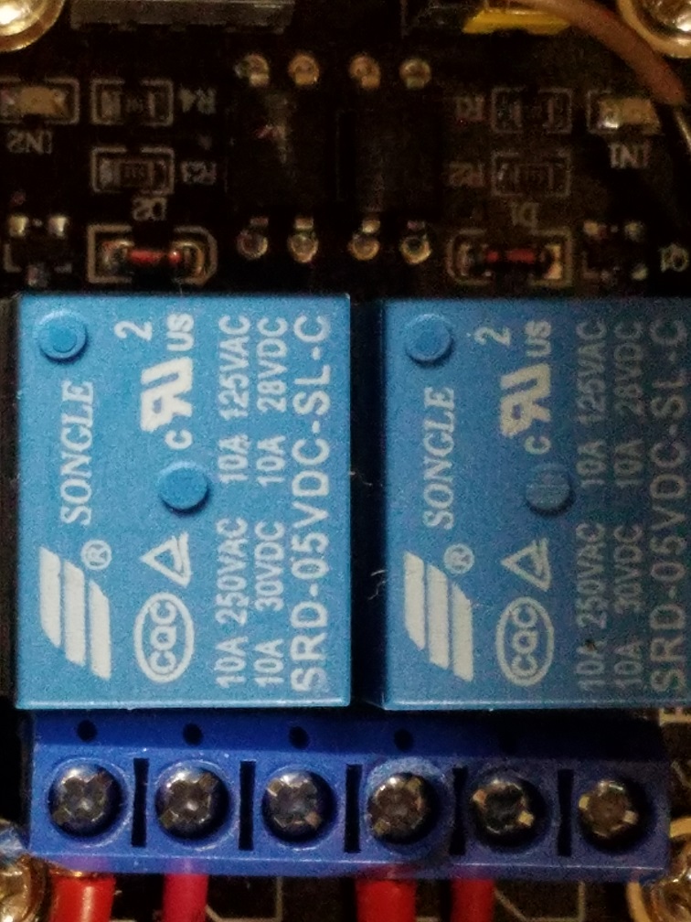

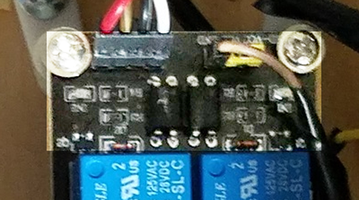

The blue relays are on PCBs that already have flywheel diodes (D1 &D2 in the photo), so they are not a problem.
DrG has put exactly the same basic changes as I suggested in the modified drawing he posted - a flywheel diode on the motor direction relay and isolate the 5V and 12V sections.
Those are the priority changes to avoid damage to the electronics side.

Nice pics. Just a couple of thoughts...

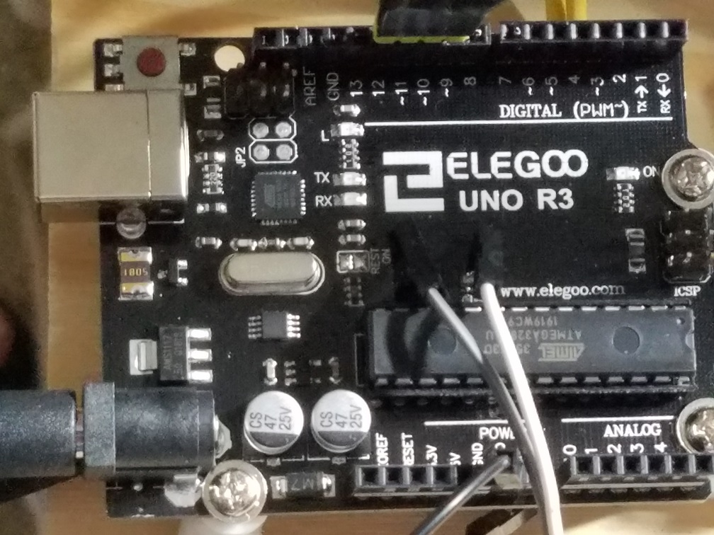

I see that the UNO is being powered from the barrel jack. Is it being fed by, what appears to be a laptop power supply? Can you gives us the output of that supply and what else it powers?
On the Songle relay board: I am wondering specifically about the connections. Here is a close up of your Songle board connector that I am talking about.
What GND is the brown wire (right side of pic) going to? What GND is the white wire (left side of pic) going to? Please check that your white wire is going to gnd and not the black wire next to it. From pic left to right, those connections should be, Vcc[5V], IN2, IN1, GND and the right side connector is GND, VCC, VCC-JD. You have jumped the two VCC pins, so VCC on both connectors needs to be 5V, which will come from the left side VCC connection.

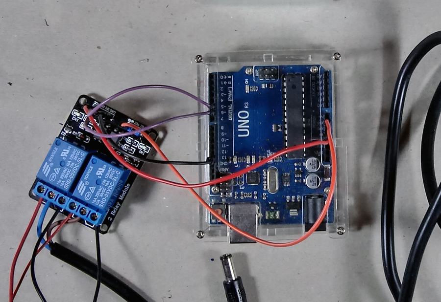

Here is a pic of how I have used the board in a project.
Since you have nothing else attached to the UNO, MORE than enough current can be supplied FROM the UNO 5V and GND to run the Songles (which take 70-80 mA each). Of course I am assuming that the PS going to the barrel jack has a healthy output.
See how I am tapping TWO GND connectors (see the black and orange wires) on the UNO. I would strongly urge you to check that the white lead on your connector is, in fact, GND and that you to try the connection scheme in the above pic first as it "isolates" any other power/gnd rails going on outside of the UNO.
Here are the specs for the OnRom relays note: 24 VDC 5 A (Inductive load (L/R = 7 ms)) , so that is something to keep in mind going forward.

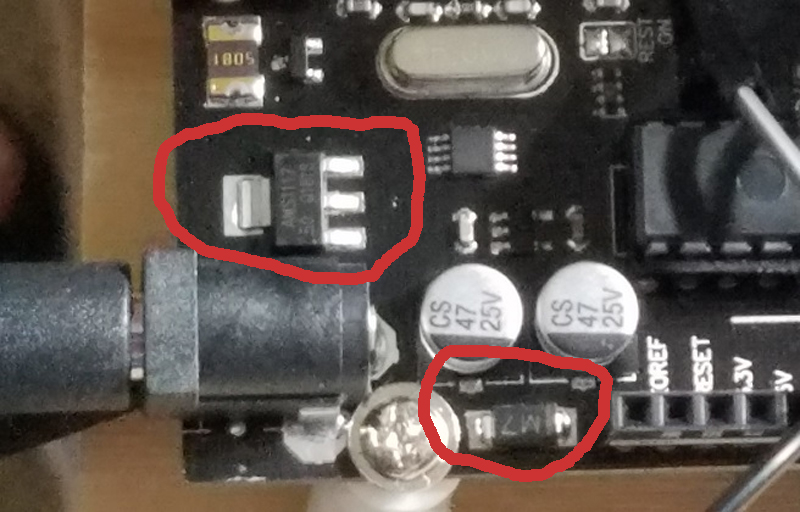

Here is some, potentially good news. Your fried UNOs may not be permanently fried. Can you please take a fried UNO and power it from the USB jack with nothing else attached and see if it works? If it does, read on.
There are two components that are particular sensitive to being fried in these situations, the 5V regulator and a diode protecting the barrel jack input. They are circled below. That M7 SMT diode can be replaced with a through hole 1N4004 diode with some careful soldering. I know, because I have done this - not because I fried it but because it was missing on a cheap clone that I bought. It was working fine from the USB port but when I went to the barrel jack it was dark. Drove me crazy until I went through the UNO schematic. I was happy when I soldered a new diode on there and all was well.
The 5V regulator is also not too difficult to replace and they are only about US$1.
I would plug it into the USB port and if it powers up, go to the diode fix. If it doesn't, I would take a meter to the regulator when you are using a barrel jack connected PS and see if you are getting the appropriate in and out voltage.
Although they are fried now, they can sometimes be reincarnated (you can rename them Lazurus 1 and 2).
