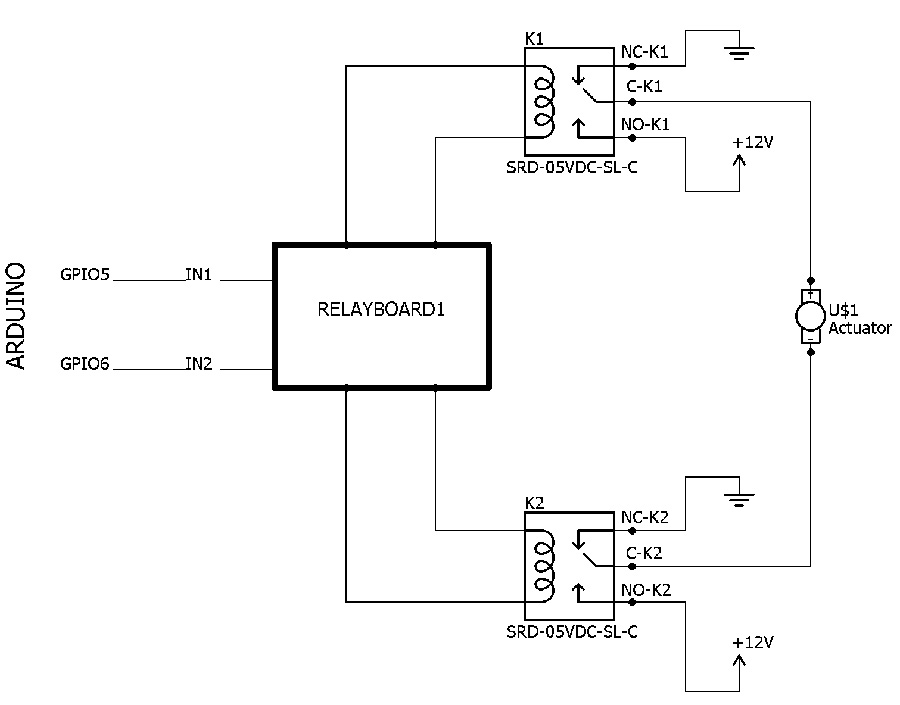

It is hard for me to visualize the circuit from your text, but are you doing the polarity reversal something like this:

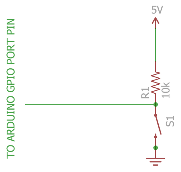

Is it possible that they are bouncing on closure and causing problems? I am using them in a normally closed manner to feed 5 volts to the arduino, and then pull it low to 0 volts when the switch is actuated. This brings the first relay high and feeds 12 volts to the DPDT switch which causes it to switch direction.
From what you've described so far I can't see how you could have fried a board unless an input has inadvertently been switched to output. When you post the schematic can you also post the code? Note, it's better if you post the original schematic so members can try and work out what went wrong.
There are a bunch of things that might be going on. Your schematic and pictures and code will likely produce an answer because what you are trying to do is entirely feasible. I think that you probably have a wiring error(s) and once we locate that, we can get this thing spinning yarn like a politician (* cracks self up with clever joke *)
To directly address your input question, Yes, you should use a resistor, like this:

Ok, everyboody, the schematic and INO file (the Legoo Code) are attached, The schematic is unique to me so this is the original. There is a bit more wiring to run the motor that turns the winder, but that is separated from this stuff, and the only logic to it is a start signal from the Legoo board so the winder and traveller motors start essentially together. I'm pretty sure I have some 10k resistors in house so I can easily add those to the outputs of the limit switches. Also, for those following the thread, the DPDT relays have an internal LED and resistor, but I would have to do some digging to find where they are connected. I do know the led only flashes when one of the two limit switches is hit, but that is probably because in one direction, the polarity does not activate the led. If anyone needs a word doc version of the code I can provide it.
