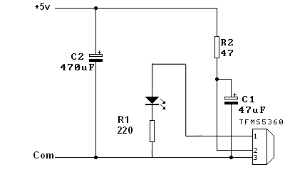

Also, I plugged everything in, and tested with camera. Infrared light is emitting from the device, so I know it works. Yet I cant get it to block TV signals. is there a device I can build, or a way to see what frequency is being emitted from my device? Maybe a multimeter or something, because I heard TV usually emit about 38Hz or something?

If you don't have a frequency counter or oscilloscope, it'll be tough to find 38 khz. A cheap and simple way might be to find or by an IR receiver module (about $1.00, free from an old TV or VCR, anything with an IR remote). Nigel's tutorials have a good hook up diagram, only a couple of small caps and a resistor. You don't need a PIC (who does :) ), just use an LED on the output. They are active Low, witch means the LED will be on, until it receives a signal. Your TV remote should make it blink, when you adjust the pot the LED will go out when you find the right frequency...
Nigel's tutorials are great, I've used some of his stuff with AVR, and help a lot. I did something similar, but just to test the IR receiver module, have both a counter and scope...
would you have a link to one of his tutorials? im looking on this site, but cannot find much.
You don't need the whole circuit, just the receiver portion on the right.
*Edit: Did a quick chop job on Nigel's drawing, pretty sure it's functional, untested though. The IR receiver modules pretty much wire up the same, might be some exceptions.
