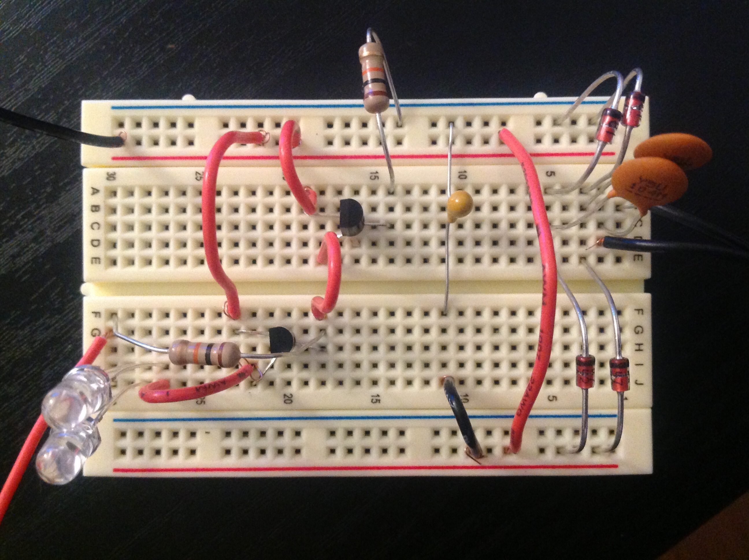

Here is the result. I removed the resis u said and didnt replace, hope is right

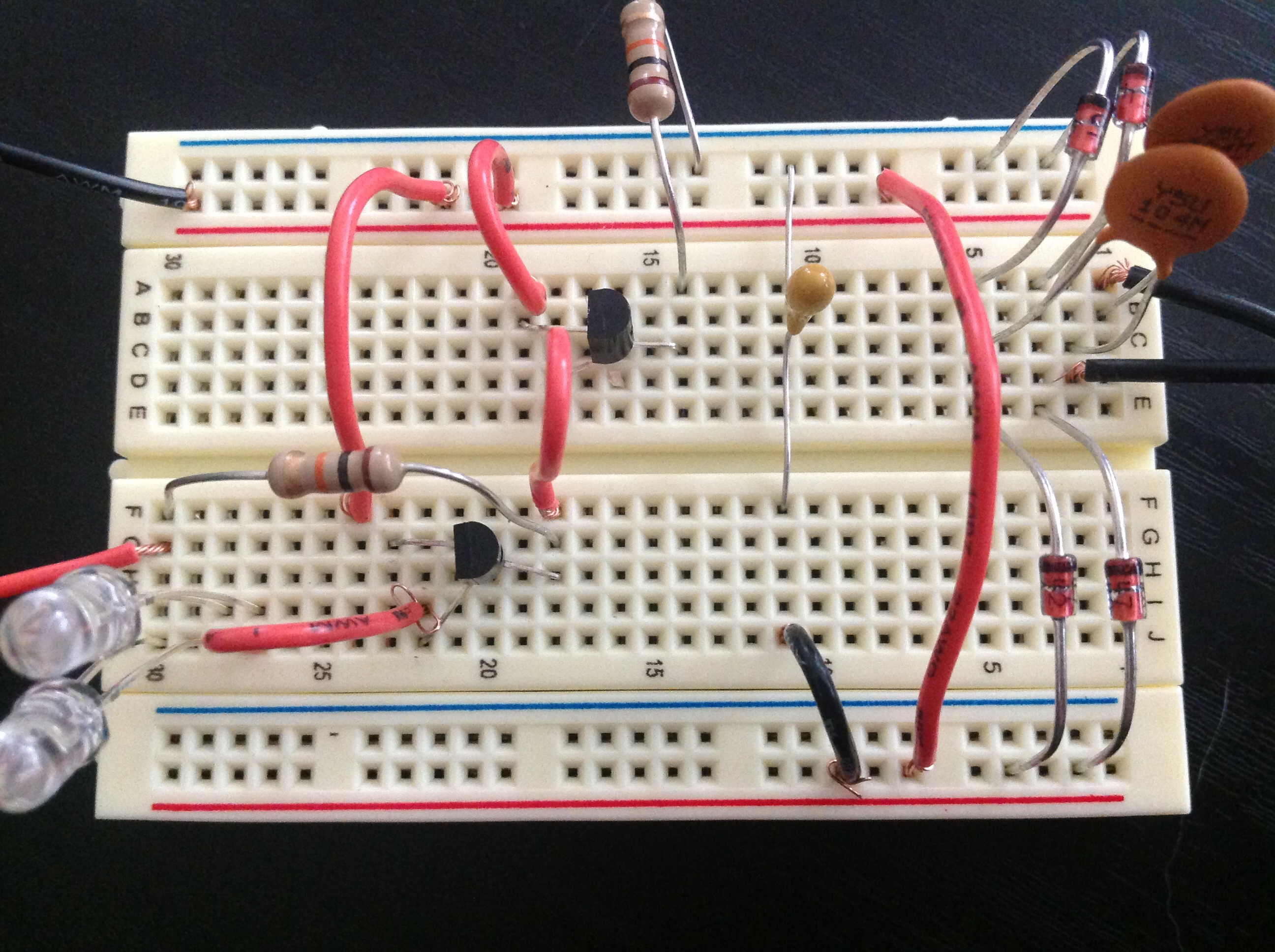

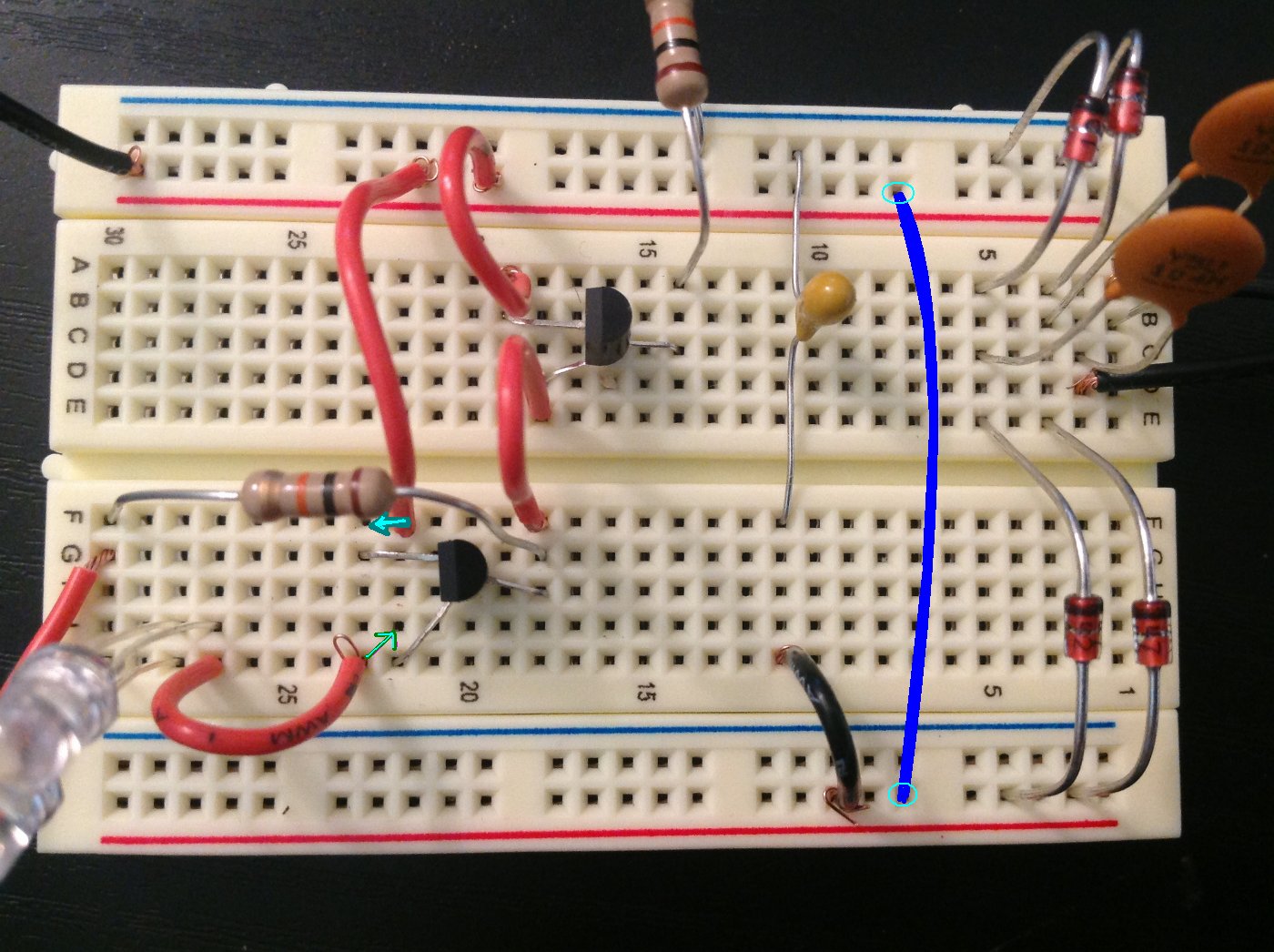

Ok we are close now.
Three more changes (see diagram):
1. move end of wire 23-F to 24-F as shown with green arrow pointing right to left.
2. move end of wire 23-J to 22-i as shown with green arrow pointing left to right and up.
3. add jumper shown in blue.
Take another pic from top.

Like this?

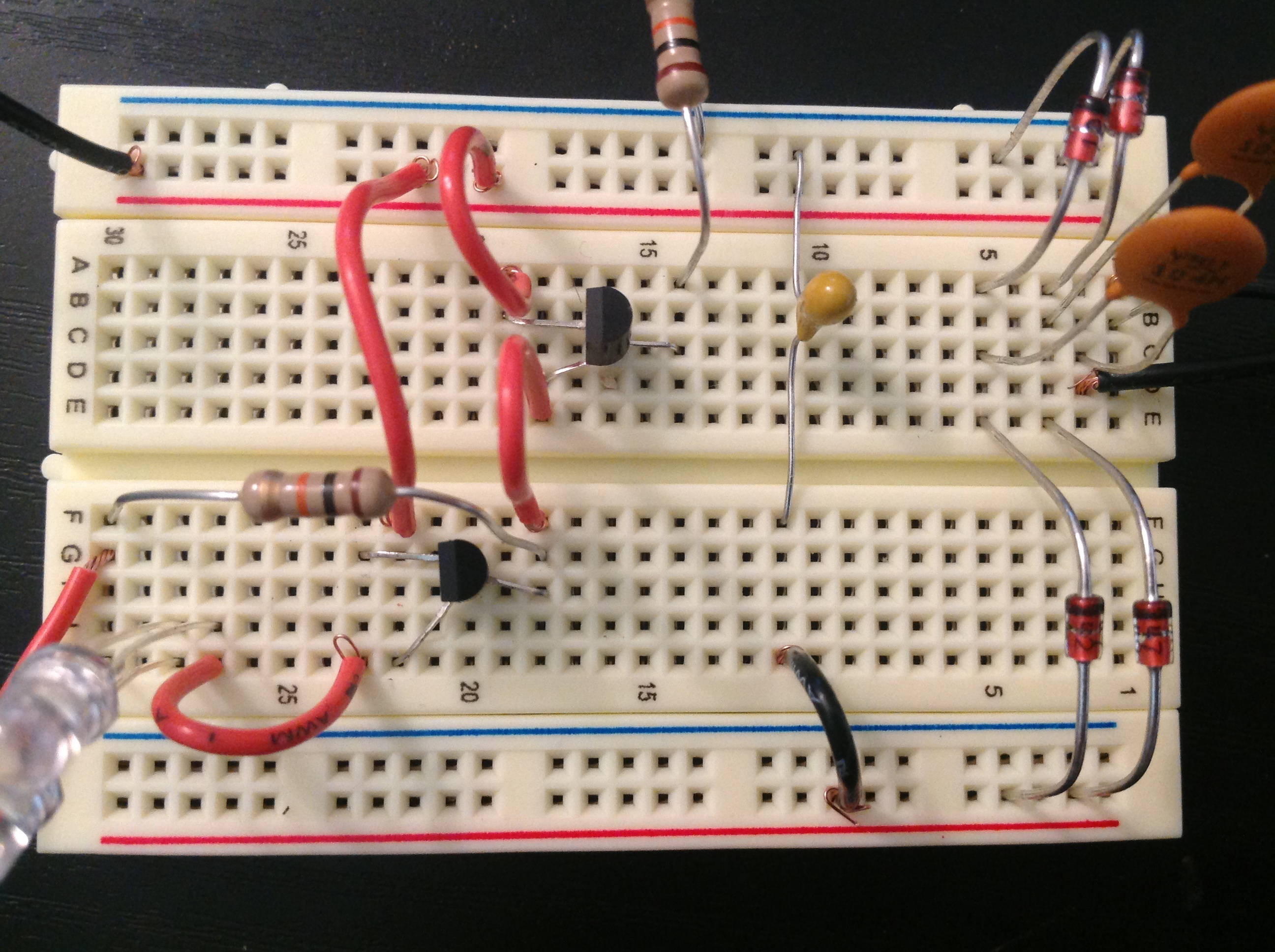

One more small jumper end movement as shown in the diagram.
You could test it after that final movement, and post a new pic too.
Yes as Eric says, solid wire is better, but dont change it over yet until we get this right :)
It works!! MrAl you are awesome, thank you so much. I attached pic of finished board. Now i have a lot of design work to do :)
You are welcome, and i am happy you finally got it working. As Bach mentions, there are other ways to do it too but i myself prefer the purely electronic ways with no moving parts.
