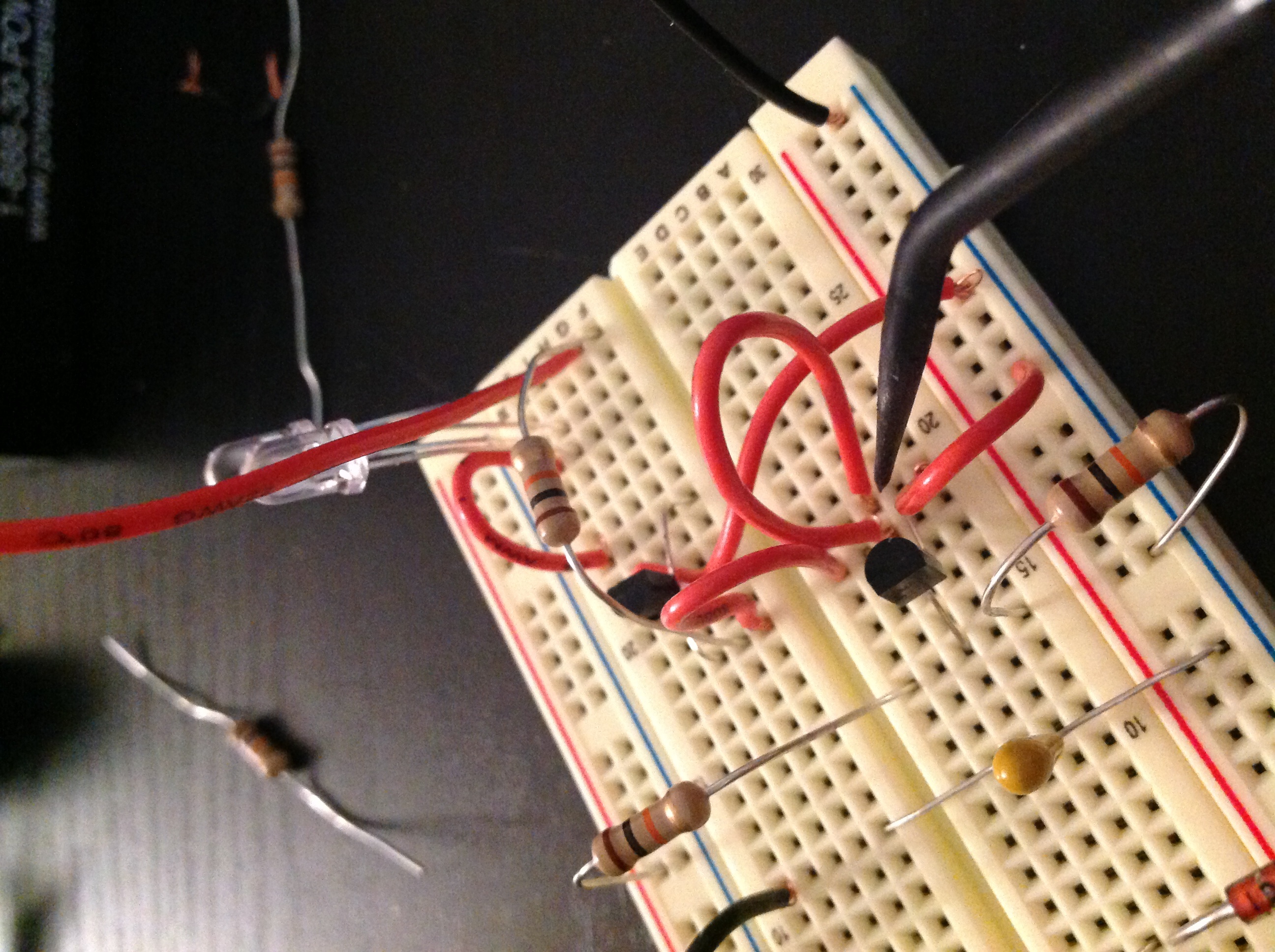

Ok i connected the first trans collector and emitter and the leds turned off while the ac plug was not even plugged in

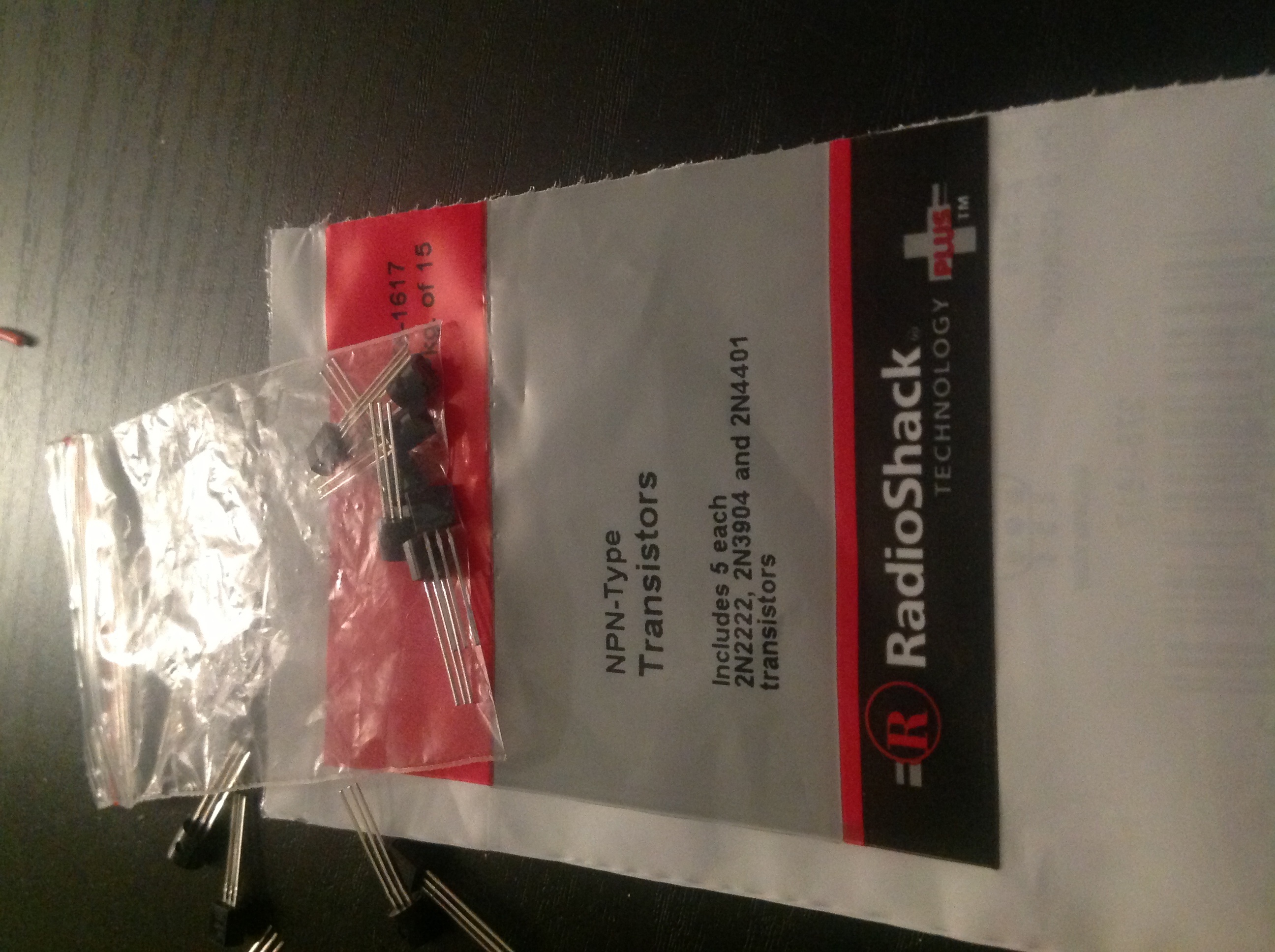

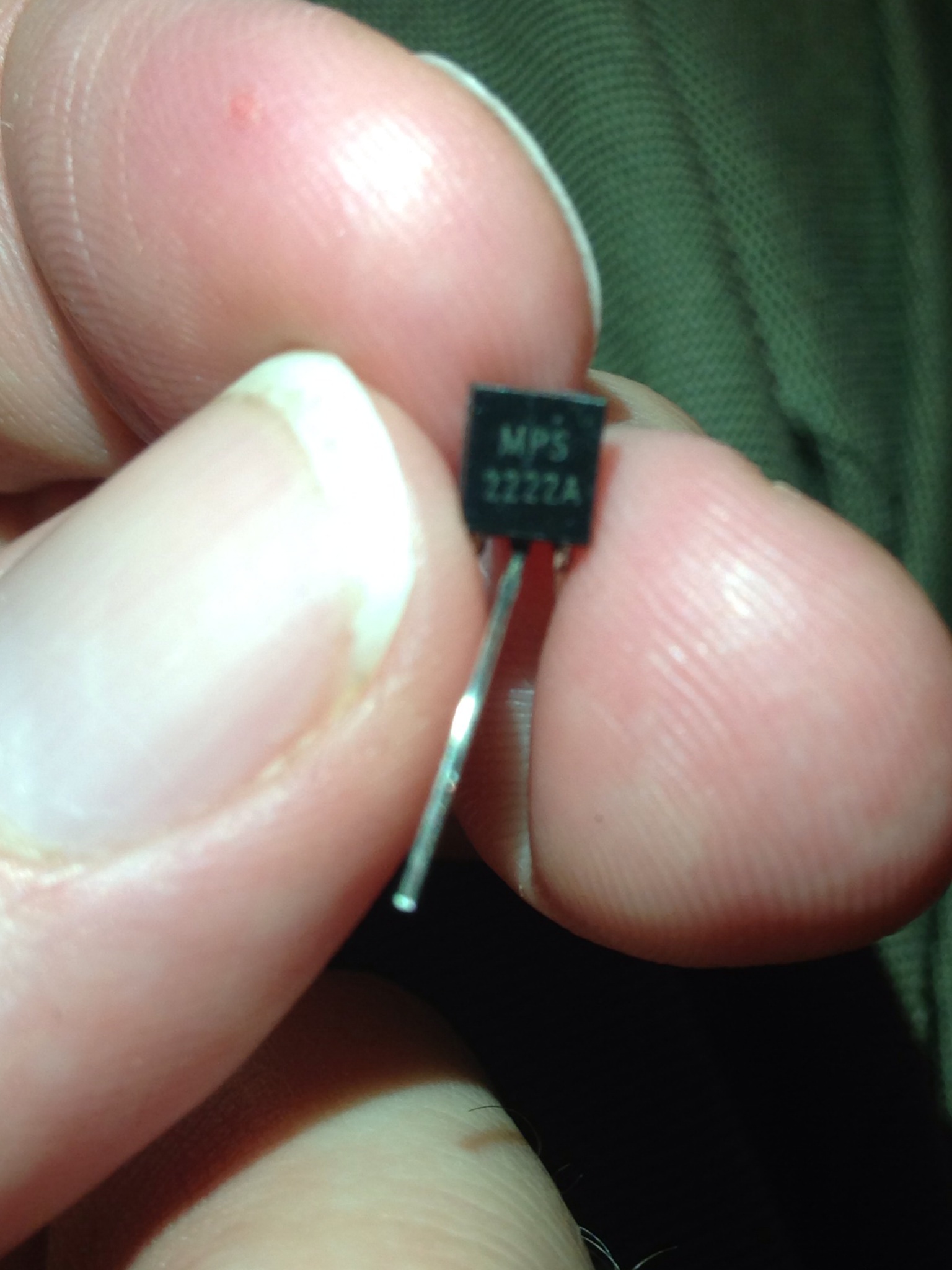

Crap. I checked the trans models and i found the error, they are not right ones!

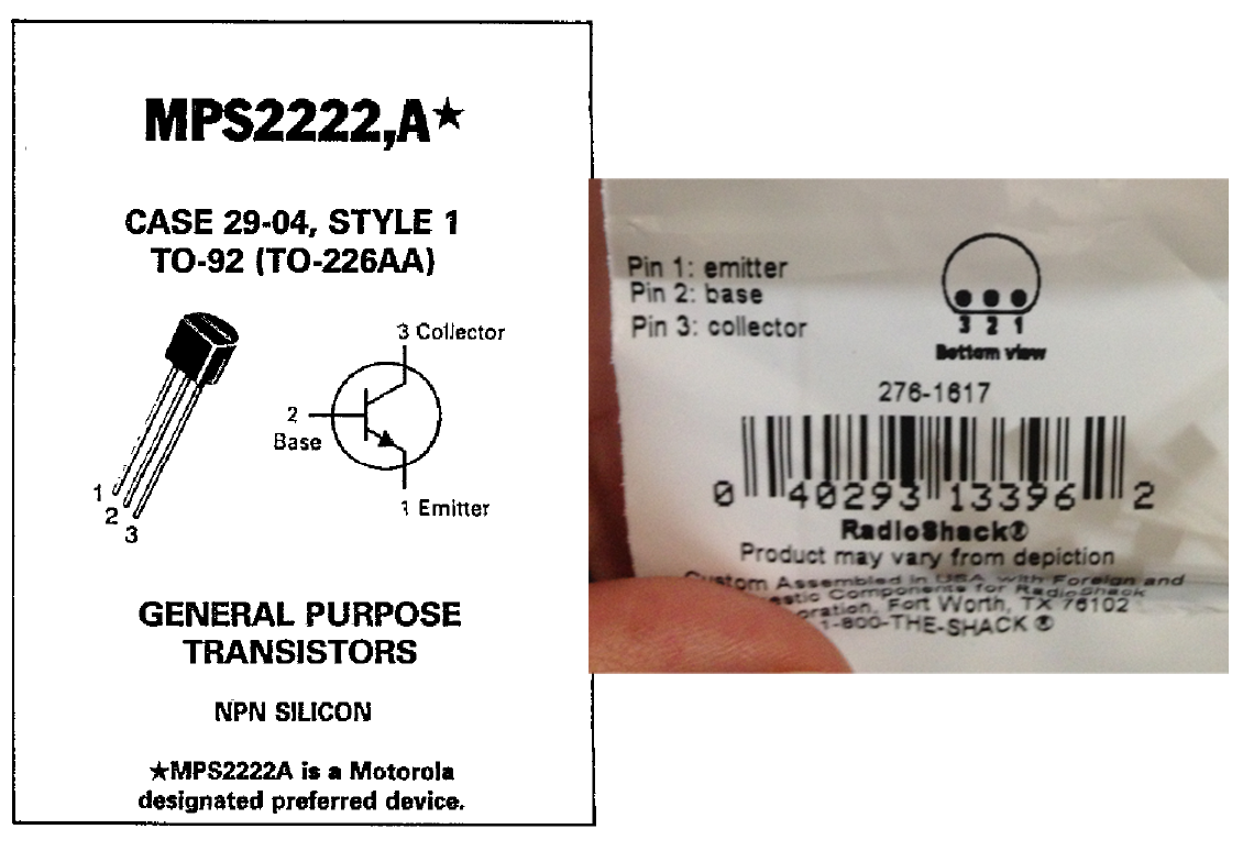

The datasheet for an MPS2222A transistor shows that it has exactly the same spec's and pins as a 2N2222A transistor.
Ah so thats not the problem :( was hoping for easy fix lol.
I tried both way on trans to see if I had em and co mixed but didnt fix it. I figured was right because I used the graph from the package but was worth a shot.
Yeah there is a wiring error. From the PICs it seems the transistors are not wired properly. Check the drawing for the transistors and be sure to get the C and E terminals correct. It has to be wire perfectly before it will work.
After you rewire, take another pic or two one from the top and post.

That is the best way to destroy a transistor.
RadioShack knows NOTHING about electronic parts and frequently show the wrong pins. Simply look on the datasheet from the manufacturer. The MPS2222A was made by Motorola/Freescale and can be seen at www.datasheetarchive.com or on Google Images.

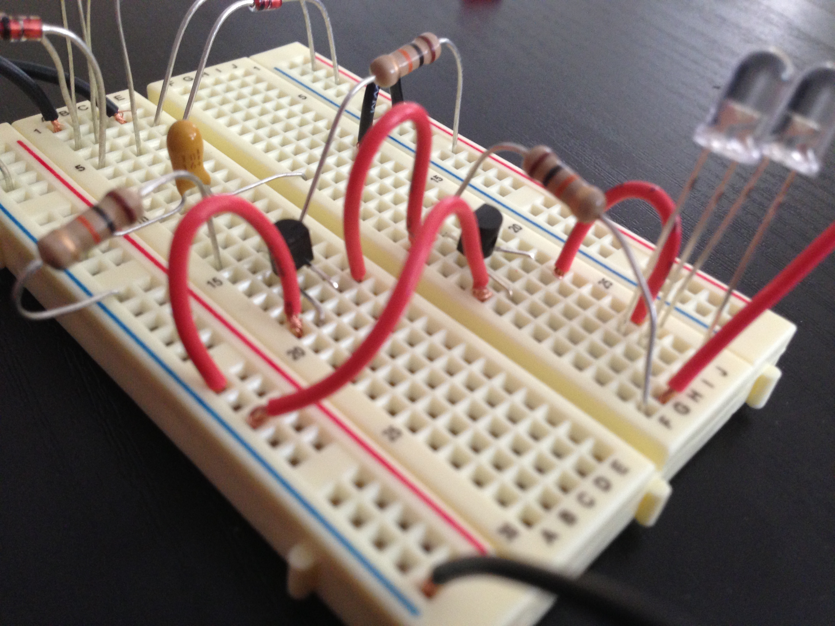

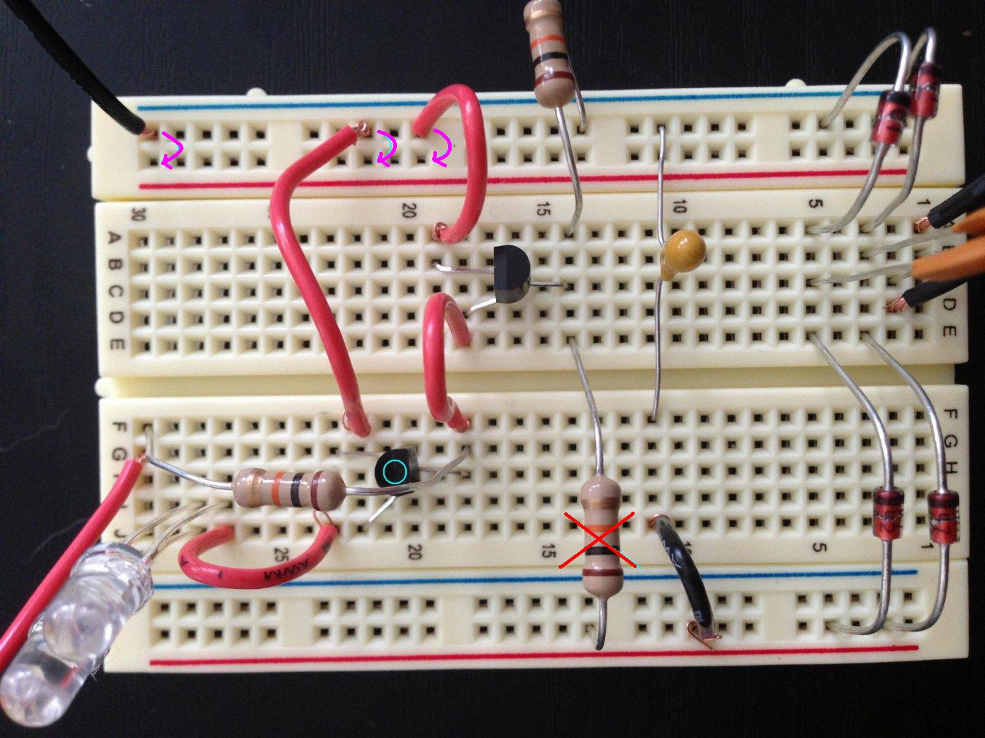

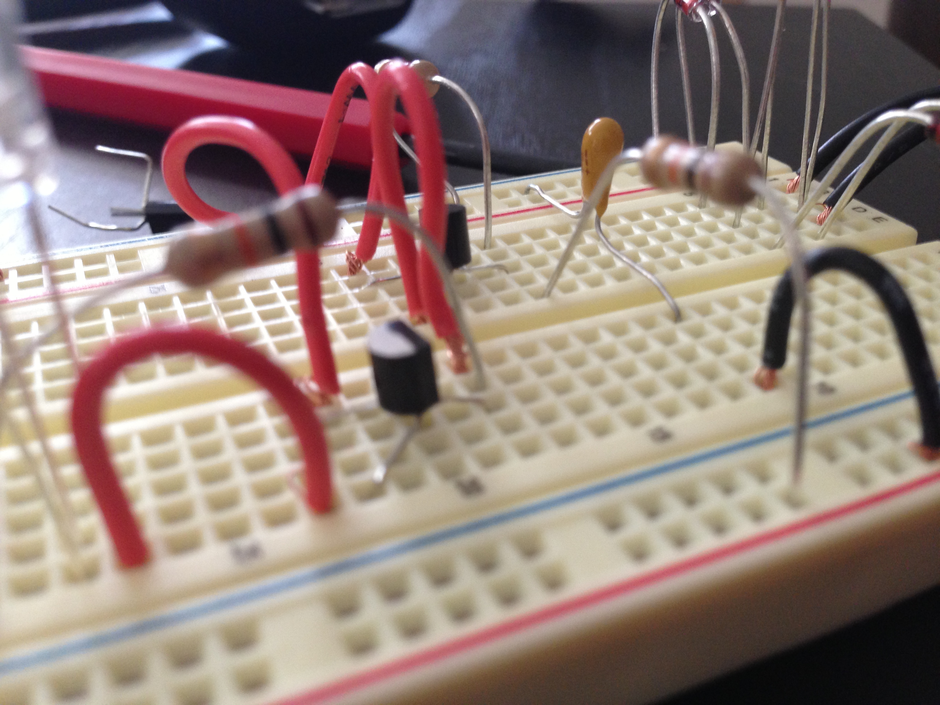

Okay, I fixed the transistors, and even replaced them with new ones, just incase the old were messed up. Still...LED's not turning off when I plug in AC. :(

It is too bad that RadioShack shows the bottom view of the transistor's pins instead of the normal view.
The breadboard wiring is so messy that I cannot see what connects to what.

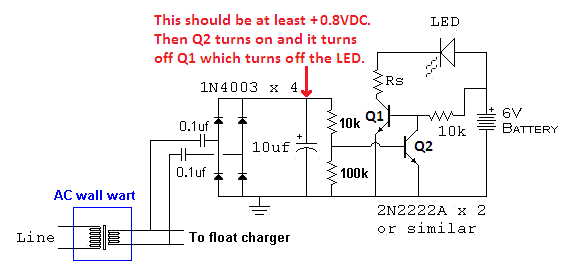

The circuit is very simple, here is how it works:

As far as I can see from the pics in post #50 there are several wiring errors:-
Both transistors have their collectors connected to the +ve rail.
The battery -ve terminal is connected to the +ve rail.
Neither transistor has its emitter connected to the -ve rail.
A 10 k resistor has been used instead of the 100k.
From the sound of this, my understanding of schematics is completely wrong.

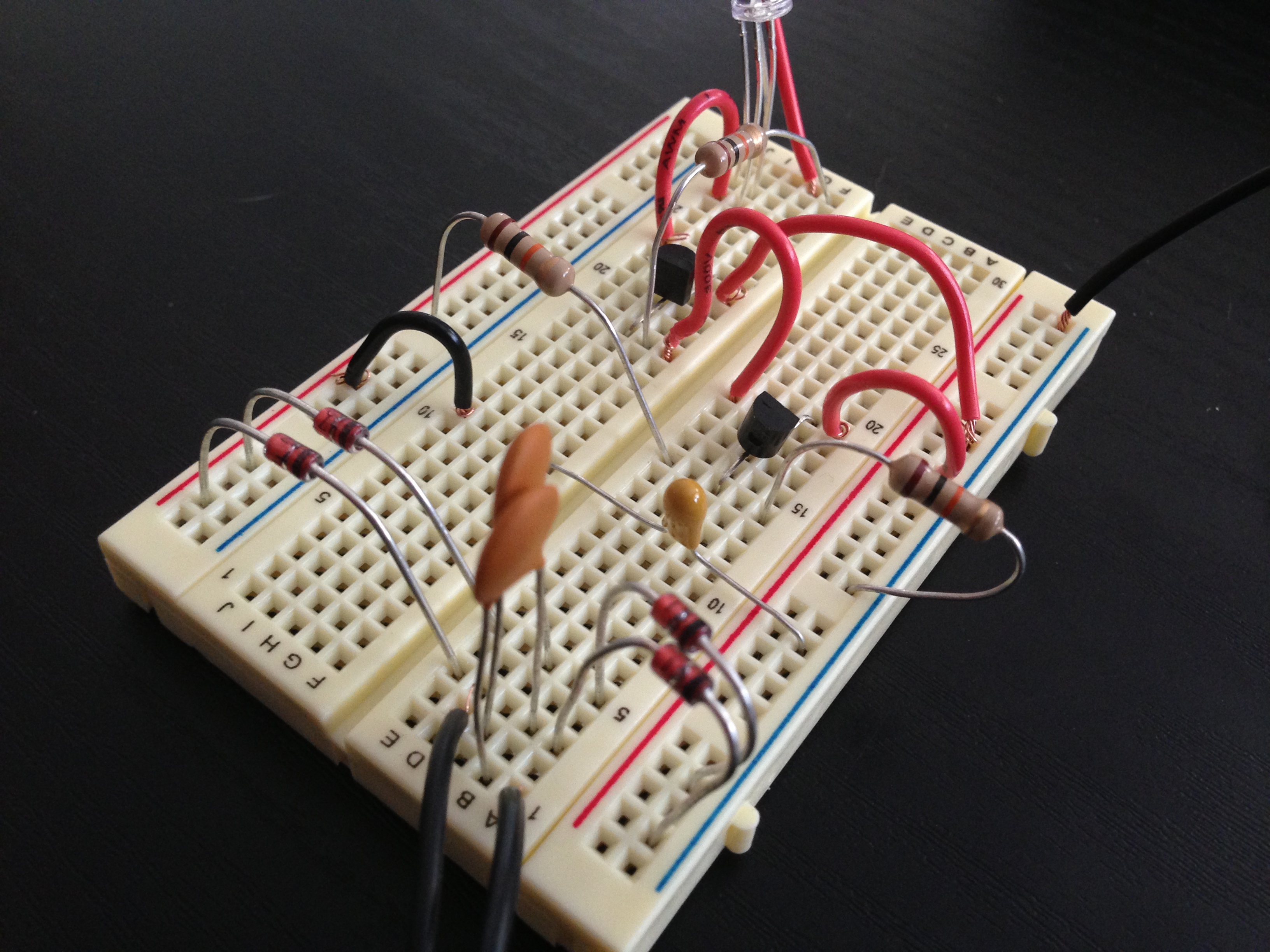

Hello,
Well then we'll have to work with the photos of the breadboard itself.
From that most recent pic, there are still several wiring errors. See attachment. Move the three wires into the other holes as shown near the top left, remove the resistor with the big red "X", and rotate the transistor near the bottom of the drawing with the blue-green circle on top 180 degrees so it is oriented the same as the transistor near the top.
Take another pic from the top like that one and we'll see if everything is right. It may turn out that that bottom transistor is also burnt out, but dont use any more transistors until the wiring is verified, unless of course you have a lot of transistors on hand.

From #57: "rotate the transistor near the bottom of the drawing with the blue-green circle on top 180 degrees so it is oriented the same as the transistor near the top"
Swap E and C.
Post another pic.
