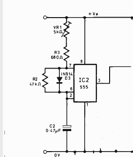

That can come from microcontroller or just a 55 timer with the appropriate values around it & switching in resistors to change the position.

This is part of a device I designed a few decades back; it produces a pulse train suitable for driving an RC servo, with the 5K preset defining the position.
For two or more positions, you can either set the preset to the highest value position and switch other presets across it to set shorter pulse values, or set it for the lowest value / shortest time and have other presets in series that are normally bypassed & are switched in to give longer pulses.
Or you can just use it for a test rig to run a servo manually while you are working on the hardware..
It will work on the same 4.5V ... 6V power as the servo itself. Add a reasonable size decoupling cap across the power supply, eg. 470uF.
