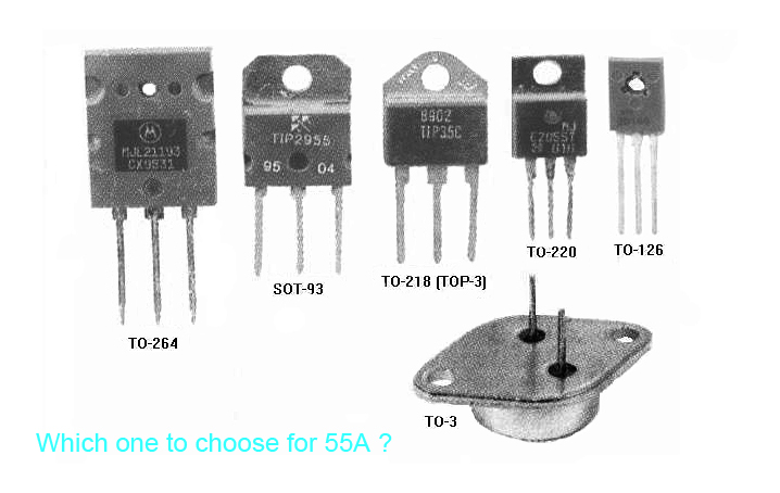

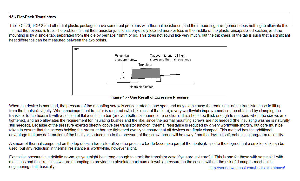

The TO-220 case was only originally designed for medium power dissipation and is totally unsuited to your application. Would you think of moving to TO-3 or TO-247 - be much better. I already stated that early on in this thread, or the associated thread on this subject. Just because the data sheet says 55A, does not mean that that can be used in a practical circuit. Early on, you said that you were surprised that such thin pins could take 55A- with good reason.
