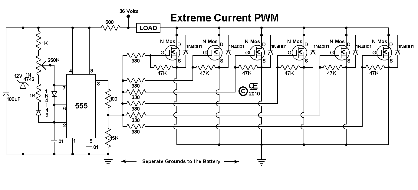

PWM is Pulse Width Modulation. The Output Continuously Switches ON and OFF at a Specific Frequency.
Simple Method is just using a 555 to drive the Mosfets.

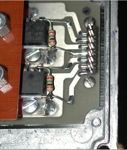

The pictures I posted were for a speed control for a heavy duty Ford 6V starter (without a limiting coil, model 3110) run at 12 volts and used as a high-speed winch for launching model sailplanes. Exact current draws are not available. Most users report at least 225A. Some users estimate it as high as 5 HP (about 300A). I used 5 IR power mosfets in TO-220 packages in parallel, and we could stall the motor without popping a mosfet. I used a mosfet driver and PWM. For launch, the PWM was as close to 100% as we could get. A more reasonable drive used a 12V treadmill motor and only 4 mosfets in parallel. I do not have the specifications for that motor. I believe it was rated at least 2 HP. The tabs were soldered to copper buss (0.025 thick) in the former and to 4 oz copper pcb in the latter, which were attached to an aluminum heat sinks. I have used it for the past 15 years, but have not built any controllers of similar power since.
Here is a picture of the latter control:
As I pointed out above, soldering the tabs is not so much for electrical reasons as it is for heat dissipation. Of course, both machines were intermittent duty only. The winch was considerably less on time than the second device.

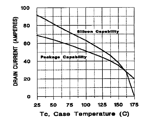

The datasheets I looked at, one said 28 amps continuous, another said 30 amps, another said 39. My DC amp meter shows they work at 37 amps but they are about 130 degrees after 1 min 45 seconds that is when I turn it off. I'm not sure what continuous current will be just have to test them and see how fast they warm up.
The current rating on the datasheet is only a rough guide and is not normally the limiting factor. Other parameters affect what the MOSFET can reliably handle and be reliable in a real application. You coul probably get 70A out of that MOSFET but it wouldn't last long. When you tell what the maximum current is that your motor takes, then a circuit can be designed with all the values and you will have a reliable piece of equipment which will go on for years. This is achieved by a normal desing procedure.
There is a problem with that. I have worked with 555 times for 45 years. You can change the pulse width to anything you like from about 10% to 90%. Assume you have it set for 50% it is always 50% no matter what frequency you adjust it for. If the mosfet is on 50% at 60 Hz or 50% at 10KHz that is the same ON time 50%. Only thing that is changing is the Hz. If you have adjustable 555 pulse width that is totally different, I have never made 555 adjustable pulse width I need to check my book to see if that can be adjustable.
This PWM is Adjustable PULSE WIDTH.
So NO the Motor is NOT on 50% of the time.
It may only be on 1%, 99% or anything in between these.
THIS VERY EASLY CONTROLS MOTOR SPEEDS, POWER and CURRENT DRAWS

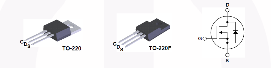

can you say which case your MOSFETs have, from the attached image (TO-220 or TO-220F).
can you give the full part number of your MOSFET.

Regarding soldering the tab, that was common practice when I was designing those drives (last 1990's). While most us assume the die is attached to each pin with internal wires, that may not always be the case. In this note from IXYS (https://www.ixys.com/Documents/AppNotes/IXAN0061.pdf ) discussing temperature gradients across the die suggests that the electrical connection to the drain may be different than to the source:
In the first design, I used copper bus bars as mentioned and those bars were attached directly to the heat sink with a thermally conductive, electrically insulative, hardening material from Loctite. I took advantage of the fact that the intact surface of anodized aluminum is an insulator. Heat was not a problem, so in the second design, I used heavy copper traces. Heat has not been a problem either. I understand your concern, Gary, about heat transfer:
How can a PC board handle 225 amps, seems like the copper would burn off of the epoxy board. I have seen PC boards burn with less amps than that.
. Please show your calculations. BTW, the second drive was for considerably less power than the first -- only about 2 HP.

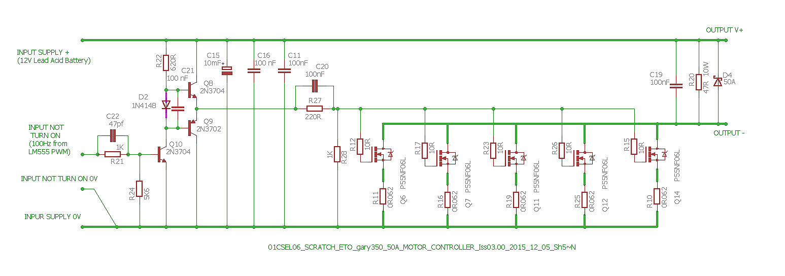

This in my circuit with 20 mosfets in parallel.
But this circuit will be much better.
Your first circuit has the problem that the mosfets will dissipate a lot of heat, depending on the motor being driven, as already discussed. What are the specifications for the motor or whatever are you driving?
The second circuit is much better but is limited by the max sourcing current of the 555 (200 mA). Hence, the rather large gate resistors. It will be problematic with 20 power mosfets at a current level that would justify using that number of devices. A purpose-designed driver can source several amperes. So, moving forward, what circuit do you plan to build?
John
GARY350........
The Circuit I Posted Can go from a 1% to a 99% Duty Cycle, Depending on the Total Resistance of the Frequency Potentiometer.
Yes 555's are Not very Frequency Stable with Temperature or Supply Voltage Variations, But Frequency STABILITY is NOT a Problem with Pulse Width Modulation.
You Don't say Which Mosfets you have?
But Mosfets have Two Different Current Ratings.
As an Example:
An RFP50N05 is rated at 50 Amps RMS Continuous Current.
And Also Rated at 120 Amps When PULSED, Depending on the Pulse Width.
