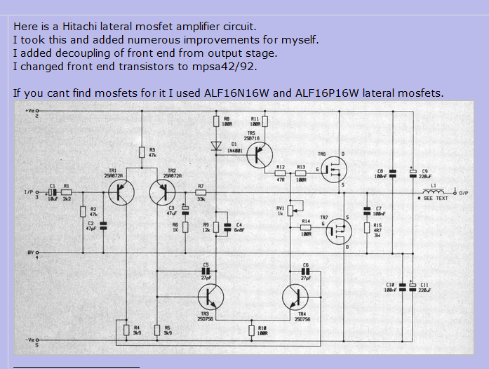

There is a misnomer about MOSFETs and current sharing in parallel which has arisen for historical reasons.
The early MOSFETs were lateral construction. which gave a high RDS, typically around 0R8, but it also gave good linearity (gm). They also have a positive temperature coiefficient, which means that they will current share in parrelel without source balancing resistors. Both, the high high RDS and the positive temperature coificient made the horizontal MOSFETs bullet -proof. In fact, there is a standard audio amp design dataing from the 1980s, which you just can not blow up, unlike other 100w amps. For that reason, that amp was/is very popular with musicians. The lateral types, having a more linear gm, are good for hifi audio amplifiers too.
When SWPS became widely used the manufacturers went over to a vertical construction with propritry name like VMOS, TRENCH FET and so on. These MOSFETS are basically switches and are not idal as amplifiers, especially because of their colossal and non linear parasitic capacitances. Due to their verticle construction, the temperature coiefficient is negative. That is why you now see SOA graphs on MOSFET data sheets. The net result is that if you parrallel vertical MOSFETs, which they all are these days, you must use some form of current equalisation, source ballast resistors being just one.
There are heaps of designs knocking around that don't comply with the rules. There are also heaps of dead VMOSFETS and also frustrated customers. Sorry to say this, but the circuit that gary posted made me cringe for two reasons; one was the absence of source resistors, but then there is no MOSFET type stated and neither is 'extreme current' quantified. The other is the gate drives, especially the negative excusion, which will not quickly empty the gates of the many parallel MOSFETS quick enough.

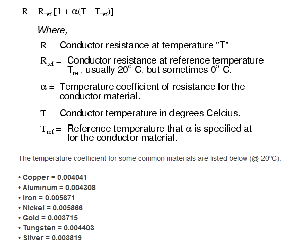

A very good point which I had forgotton about; your approach is even better than you say: Because the temperature coificicent of copper is positive, it improves on the current sharing more than a pure resistor would.

Very true. Some components you can buy cheap, but for critical items always go to a reliable source. Resistors are so cheap anyway, that it is not worth going for 'bargains''.
https://www.cirris.com/learning-cen...-topics/177-temperature-coefficient-of-copper

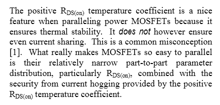

This quote supports what you say about MOSFET positive temp co, but there is a caveat:

I'm trying to decode this statement:
Parallelisation of MOSFETS
MOSFETS have a negative temperature coefficient on the drain-source contact which means that the body resistance increases with current. As a result when MOSFETs are paralled to increase current capability, current sharing occurs naturally as current rise results in a rise of the channel temperature and consequently the excess current is redirected to parallel chips.

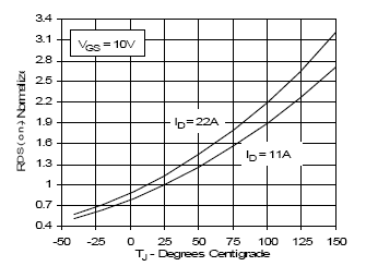

I just looked into a random datasheet from IPB107N20N3G and the curve of Rdson vs temperature is definitely rising, so it shoud be able to be paralleled.

After reading many of the links in post #50, I am confused, but it seems reasonable to draw the following conclusions:
(1) You cannot parallel most MOSFETS without some kind of current balancing mechanism, usually source resistors. Some lateral MOSFETS can be paralelled but, by definition, their high Rds, typically an order higher than vertical types, prevents them from handling high currents.
(2) In the main, MOSFETs, as you say, have a positive temperature coificient, but on the other hand this cannot be used to ensure safe current sharing. But, under certain conditions MOSFETS do have a negative temperature coieficient.
(3) Great care must be used when pysically connecting up high power MOSFETs, because at high currents the resistance of wire and solder joints can cause inbalance in a current sharing circuit.

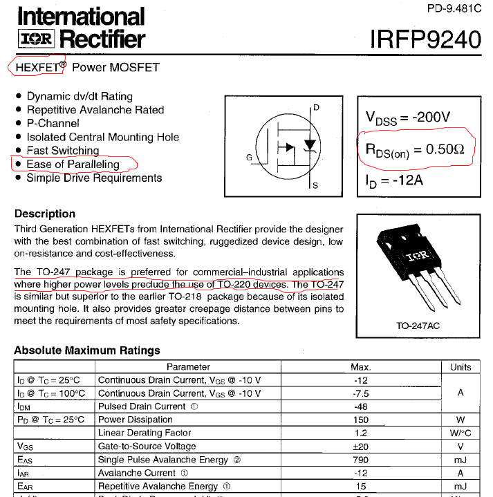

About the many tiny junctions. This is effectively true for all semiconductors, at the xtal structure level. But there is a difference between transistors on different crystals and substrates working in parallel. The common substrate transistors have identical geometries identical doping levels and are also pretty close in temperature. I think there are other reasons why common virtual transistors share well too. This is not the case with physically separate transistors.
There is still a problem with current sharing on a common substrate though. This is evidenced by the safe operating area (SOA) graphs appearing on MOSFET data sheets, whereas at one time they were absent. BJT power trans have always had them. In their case, the many transistors in parallel model, applies especially.
A consequence of all this, is that, as the voltage withstanding capability of a MOSFET, and especially a BJT, goes up, its conductivity goes down. I don't know for sure now, but I seem to remember that the bulk resistance, or similar aspect of the silicon, is increased by the manufacturer to reduce secondary breakdown.
Hi kub,
Afraid that a positive temp co does not guarantee good current sharing. One of the main parameters is the different geometries between the two trans. See the quote in post 50. Sure you can put MOSFETSs in parallel and they will probably work OK, but you would never know if they are being abused. Normally, the only sign you would get is gross abuse where, as I have said before, the channel melts and forms a short between the source and drain.
Much of the data in this area is vague at best and contradictory at worst. If you have some data that would clarify the situation, I for one, would be very interested. I thought I had it all pretty wells sussed until we started discussing this area and I read a few references.

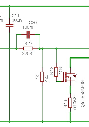

@post #53
I maintain that in most cases, you do not need balancing resistors when the design incorporates the principles mentioned.
What principles do you refer to? Is it the good gate drive?
It simply doesn't make sense to me to use modern MOSFETs with an RDS(on) in the range of a few milliohms to low teens milliohms and then add a whopping 62 milliohm source resistor.
It does seem a waste, but it is universal that you lose something in order to get a reliable and characterised design. I assume that you are referring to the 62 m Ohm source resistors in my circuit. If so, I wouldn't pay to much heed to that. The circuit is only a concept and has not been detailed. In practice, the source resistors may be lower (and I would make the base gate driver more elegant too!). But even the 0R062 Ohm resistors would have no significant impact on the overall performance of gary's application. They would just give the MOSFETs an easier time and ensure that his system is reliable.
Not only does that resistor make a small space heater from a motor drive, by effectively reducing Vgs
Did you mean Vds. If so, yes that is true and undesirable, but I would say it is a penalty worth paying. In that case of the 62m Ohm the loss would be 620m V, which would not be significant in a 12V lead acid battery application where the battery voltage itself would be changing by much more than that. 2.38 W is hardly a space heater. The MOSFETs, motor, and battery would be generating orders more heat
it changes the MOSFET from being fully turned on to being somewhat less "on," increases RDS(on), and increases heat dissipation in the MOSFET.
. Don't like to contradict but that is not significant. You would be over driving the gate with around 12V so the odd 620mv, here or there is not significant.
Of course, that is the mechanism by which such resistors work, but they are not necessary with good design.

In summary, I take the opposite view to you. The drain resistors are a very good thing, and an essential part of a good deign, but it all needs to be well executed. :)
I meant Vgs . Remember that when N-channel mosfets source current as in your design, the effective Vgs is reduced by the voltage drop across that load (i.e., R11). Now,look at your circuit:
R28 and R27 for a voltage divider the gate gets 82% of the voltage from your driver (ignoring any transient effect of C20). That driver has a voltage drop of approximately 0.6 volts across the top 2N3704 (Vce = 0.6 volts saturated). So, your top rail is 12V, which gives approximately 9.3 V at the mosfet gate. Gary350 was talking about 30 A or so per mosfet. That is 1.86V across R11, or a net 7.48 Vgs max. For many N-channel mosfets, including the one cited by kubeek above, that much change in Vgs is not insignificant. Also, 30 A across 0.062 Ω = 55.8W, which is wasted heat. It may be insignificant compared to an 11 kW drive, but it is not insignificant in terms of finding a 100 W resistor that is not terribly bulky.
Several posts ago, you asked me to validate what experience I had. You never countered with describing your own experience and have particularly avoided documenting your claim that modern versions of the mosfets under discussion have a negative tempco. Can you do that?
