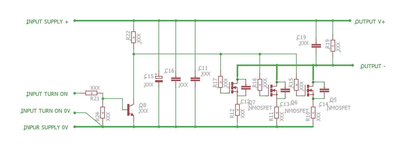

This is 1 circuit I have been experimenting with. I will have to look for the others they are mixed in with other papers. I tune the resistor to turn the mosfet completely ON and completely OFF. I can use the meter to check voltage at pin 1 when mosfet is off and on. Disconnect power supply then check resistance on pin 1 to learn what it takes to make a certain mosfet be full on and full off or full off and 35 amps full on. This was the basic circuit I started with that I made changes to it. I don't have any thermistors.
I have more than one mosfet project. This is the one I want to us to run a 5 hp fork lift motor. I have a car battery and starter solenoid connected to the DC motor. Turn on the switch it is 100% uncontrollable power. The Go Kart peals the tires like a race car and the Mini Bike is impossible to hold on. I need enough mosfets in parallel to turn the motor on slow. The Go Kart is fun like it is it goes to full speed 30 mph in about 5 seconds. The mini bike requires a momentary on switch push the button and the mini bike is gone and your not. LOL. This is so funny to watch people try to hang on but they can't. I need to make a video of this. There is no tag on this 5 HP fork lift motor I'm not 100% sure what the current is. I am not 100% sure this is 5 HP I compared it to a known motor that is the same physical size as a 5 hp. I need to put the amp meter on the go cart to see if I can get a good accurate amp reading but first I figure I will do the easier part first see if I can make mosfets in parallel work before doing anything else. The mosfets I have now are cheap $10 for 20 mosfets, 55 amps x 20 = 1100 amps. If I can only go to 35 amps each that is 700 amps. If I have the correct number of mosfets amps will be low maybe 35 amps each. OH, I just remembered something, amps will be high only on high torque take off picking up speed but not with the motor running full speed.

If the gate resistors are in series with the gates of the parallel MOSFETS, the rseistor values will not affect the voltage on the gate of the MOSFETS, which in turn affects the current the MOSFETS take.
By the way, it is not possible to put MOSFETS in parallel and have them share the current, especially the vertical types which the high current MOSFET all are. Unless you have some current sharing external circuit you need to put very low and equal value resistors in the sources of all the parallel MOSFETS.
Although you have not replied to my request for information at the other thread on this topic, it seems almost certain that you are stressing the MOSFETS beyond their capability. The data sheet maximum current of 50A means nothing in itself; it is just specmanship. You need a design to solve your problems. Such a design would be simple to impliment, but I for one, would need more data about your set-up to suggest a solution.

Gary,
Here is an outline circuit that will do your job now that you have provided the information requested. Three parallel MOSFETS are shown but the number required will depend on the maximum current that the motor takes.

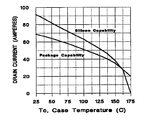

The P55NF06L allow through 55A when it is turned completely on.
jp I think 55A is asking a lot when all the practical considerations are taken into accout. It may handle 55A for a few a few miliseconds, but I doubt DC, especially in a a TO-220 case. There is also the long-term reliability to consider.
No it won't, not more than a few miliseconds anyway, and in a TO-220 case even that is debateable.
Not according to the previously cited IR document:
Can you support your spec_ulation with similar data?
