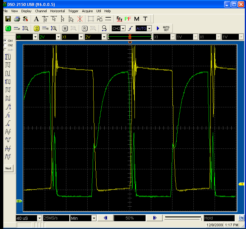

Anyone want to look at another set of scope pictures,(13)?
I CAN NOT get it stop oscillating!!! I have the totem with 10 ohm resistor (and I tried others) working good except every time I add a load to the FET, I get what's in the pictures. I think I read somewhere about optical isolators and something like a 9 nanosecond delay. May have to try it. FYI, as the on % out put of this circuit increases, it drives a motor which decreases the on % back to 0, any delays would be made up for by the nature of the beast.
The green trace is the output to the gate to ground, yellow is source(ground) to drain.
Some of the shots with letters are just pictures, shots with number are current flow, the following 2 are with the FET unloaded and loaded.
Any ideas of how I can get this smoothed out. I'm getting frustrated.

The schematic in post #28 is missing very important supply bypass capacitors. Without them the loaded Mosfets can oscillate.
If you built the circuit on a breadboard then it will certainly oscillate.
I did build it on a push the lead in the hole type bread board with full length lead on everything and the FET was about 10" from the board and another 10 or so inches from the the load,( sometime the head lamp out of a car, some time a 5, 2, or 1 ohm 50watt resistor or a combination of the 3, I even tried the motor with a 100 ohm 1/4 watt .68uf snubber and even let some smoke out of the resistor, because of the high freq, I assume.)

10 inches from the supply and 10 from the load without bypass caps and you're wondering why it's oscillating?
There is your oscillator. The stray capacitance and inductance are far too high. Supply bypass capacitors might help.

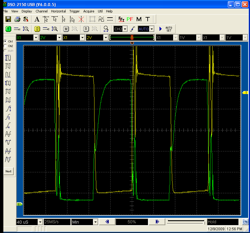

Got some more scope picts. that look absolutly great, same circuit, same scattered set up, no totem, different FET, IRF4905 P channel, Why does it work and the IRF2805 is giving me fits? I put my fluke on the gate and source and measured .0077uf, I thought that was interesting. Here's the 2nd of this last series, the name implies 2v across the motor and 1500 ma and it is turning over very slowly, most of the names refer to current through the motor, again, why is the P FET working so well and the N FET oscillating so much, may have to PWM the P side of my H bridge instead of the N side, Even if the N can handle more current, My next test may be to try a lower amperage FET. oh yea schottky diode and snubber protected, LM339 driven.

Your problem is that the circuit is built on a breadboard and the supply bypass capacitors are missing.
What is it that I need to bypass? Because my power supply is limited to 5.7 amps and I'm working toward driving a motor that can pull upwards of 50 amps and more if I could stall it, I have a really big gel cel sitting next to my breadboard with #16 wire from battery to the board and the power supply keeps the battery at 14 as if in the vehicle with the engine running. The circuit works great with a p FET, and I plan to play with it today. Expect more scope picts:D If I wasn't ashamed of my messy bench, I'd even throw in a photo of the bread boarded circuit:eek:
Kinarfi
The circuit must be built on a compact pcb with very low stray capacitance and low inductance in the short pcb copper traces. The supply bypass capacitors on the pcb stop the effect of inductance in the wires from the power supply.
Well I'll be damned, Put 2 8000uf 15vdc and 2 12000uf 15vdc and 1 50,000uf 50vdc caps on the rails of my bread board and all my problems ppisadeared except for why my FETs died, here's just 2 of the many scope shot I took, but since they all looked the same except of on and off time, you only get to see 2 of them, They are the output from from my LM339 with a 1K pull up resistor and the out from the drain of an IRF2805 and IRF3205 with a schottky diode drain to negative and 120 ohm, .1uf snubber across the motor leads.
Audioguru, I figured that since my power was coming from a 27AH battery with only 18 to 24" of #16 wire, the battery would be filter enough, guess not, when in service there will be 2 #10 wires about 6 feet each straight from the battery, do you think I should design a filter cap for that also? If so, how big?
