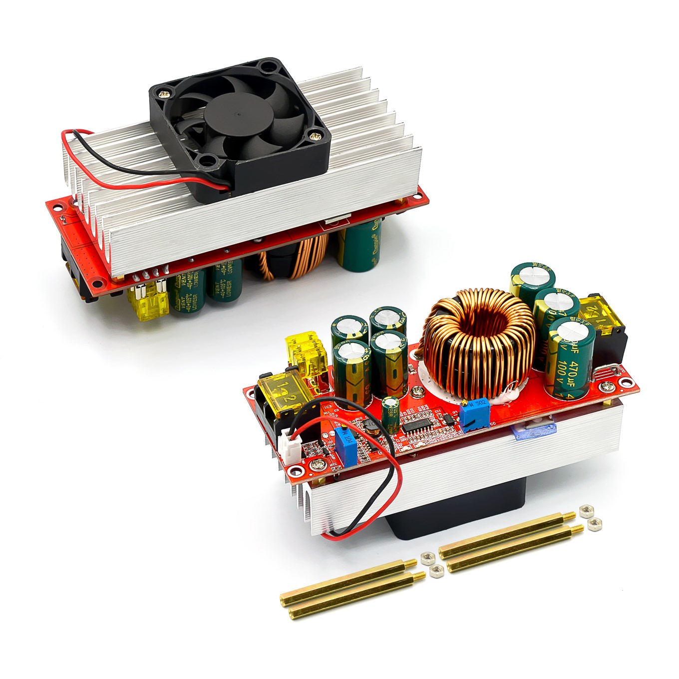

Can I add a FET in parallel to this boost circuit
DarrenB
I use these AliExpress boost converters to charge batteries but I would like to make it function closer to its rated specifications. At the moment it gets really hot when at around 70% of its max rated load. I have tried replacing the fan with one that has a higher static pressure rating and it helped considerably but I was thinking I could take it further by adding a larger heatsink and another FET in parallel. Is it possible to add an identical FET in parallel to this pre made boost converter? It currently uses a 055N15A but If possible I would replace it with 2x IRFP4568. I know that the total heat will equal roughly the same but I am more concerned the thermal path being larger and the heat being shared across two packages. I am a complete beginner when it comes to electronics so please forgive me if this is a stupid question.

A common problem with cheap devices using large power FETS is the circuit not having enough gate drive current, so the power device does not switch as fast as it could - and it's when it is part on that the power dissipation is very high.
The existing device has a typical gate capacitance of 7.1nF and maximum almost 9.5nF
The IRFP4568 are rated 10.5nF typical. Having double that is going to slow the switching far more & mean the FETs waste a lot of power.
ps. The module is apparently a "DPX800S"
What input & output currents & voltages is it running at?

Thank you for such a well explained reply. I haven't got one of these modules with me now but I will try and find the gate driver part number.
I use these modules at all voltages and currents within specifications, wattage and temperature. I would like to be able to get a bit closer to the 15A input and 800W output. I used to use the trusty old house brick boost converter (as pictured) in a printed case with 2x 92mm fans and it was really reliable. The heatsink temperature never really went over 40C. I recently changed over to the DPX800S because it has a display and is digitally controlled. I miss having the 20A input so I would like to get closer to the 15A rating on the DPX800S.

I use it at various voltages but mostly 12V, 36V and 52V on the input.

Once I have the module with me I will post the pn for the gate driver. Do you know of any mosfet I can get that is better than the 055N15A, maybe I could use a single fet which has a lower resistance rather than using two?
The dissipation due to "on" resistance at 30A (eg. 15A average at 50% duty cycle) is near enough half a watt, half the time - so a quarter watt; near enough irrelevant.
All the heat is due to dissipation while it is changing between fully off and fully on.
Something like one of these may actually work better, as it's got reasonable current and voltage ratings, but much lower gate capacitance, so should switch faster:

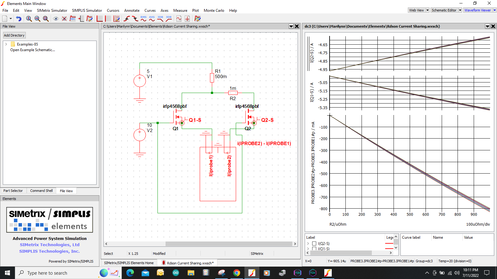

Bi-polar transistors do need resistors to balance their current, but MOSFETs have a positive temperature coefficient for their on-resistance so will inherently tend to share the load current when used as switches, no source resistor needed.
If relying on Rdson matching of paralled MOSFETs w/o ballasting I would be
concerned with this -
Looks like a significant current non sharing in the making.
And typically since multiple MOSFETS typically in the same thermal environment
they all experience similar heat rise, mitigating some of the beneficial effect of
rising Rdson with T. Not to lose full insight this is all non linear and starting at different
points on the Rdson vs T curve for each device I would still want to swamp out that variation
with ballasting unless I match at device test.
A crude sim of the problem -
Regards, Dana.

I am guessing this is referring to the crutschow post? Ballasting = resistors? Are you saying that because the mosfets are generally within close proximity of each other on the PCB it is still a good idea to use ballasting? What is ballasting?
Ballasting in this context is to insure MOSFETs that are paralleled, when on,
one of them do not hog most of the current thereby overloading it. So one
adds R in series to mitigate device to device Rdson variation and Vth varia-
tion where one turns on before the others. crutschow is correct, there is a
+ tempco to Rdson such that when MOSFET has more current it heats up and
its Rdson mitigating some of the current rise effect, eg. negative feedback.
But one has to do analysis to see if that effect insures no device is ever over
its ratings due to all changes such as initial Rdson tolerance, board layout
(slight R changes in traces), etc.. In fact in RF work this becomes very important
for RF Power MOSFETs because of all the AC parasitic involved resulting in RMS
power differences between them. Note also Rdson variation with T is non
linear, complicating analysis even more.
So at high currents using low Rdson MOSFETs one adds R in series to lessen the
effect due to simple load sharing differences. The sim I showed shows this problem,
but not a complete analysis as the device specs only show a typical and max Rdson
value, no minimum, so the worst case is not handled, eg. one MOSFET at minimum,
one at maximum, for the analysis.
Simply think of the problem as a simple voltage divider effect with load and the
paralled R's, and accounting for all tolerances.
Lastly note ballasting at high currents typically done with trace length versus
discrete R's.
Regards, Dana.
PS : By the way many high power MOSFETs actually have internal ballasting due to
their architecture. To insure no hot spots developed on die. You can google that.
