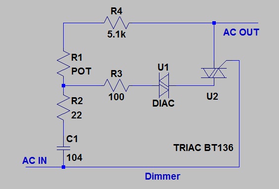

I recently bought a dimmer to control fan. But just got bad smoke from the non-sense dimmer. This is nonsense because look at the triac pins used in the dimmer. :D
Now the DIAC feeder resistor and the TRIAC are damaged. TRIAC shows the 1st (terminal) and 3rd (gate) pins shorted. Is it mormal to get that kind of short while powering the circuit withh such fool wiring? Or the TRIAC itself was built-in fake? Few months ago in a shop I have found whole bag og BT136 shorted 1st (terminal) and 3rd (gate) pins. The one inside the fool dimmer looks pretty similar like these fake BT136.
