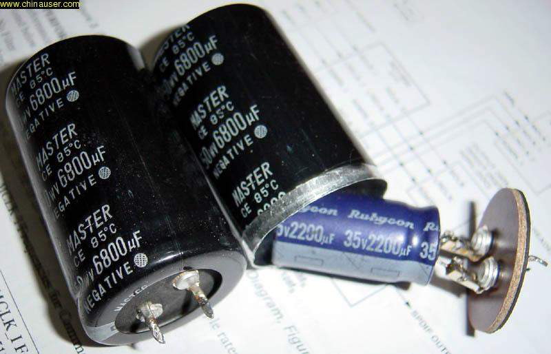

How did they get the capacitor cut apart so nicely?
It probably fell apart!
