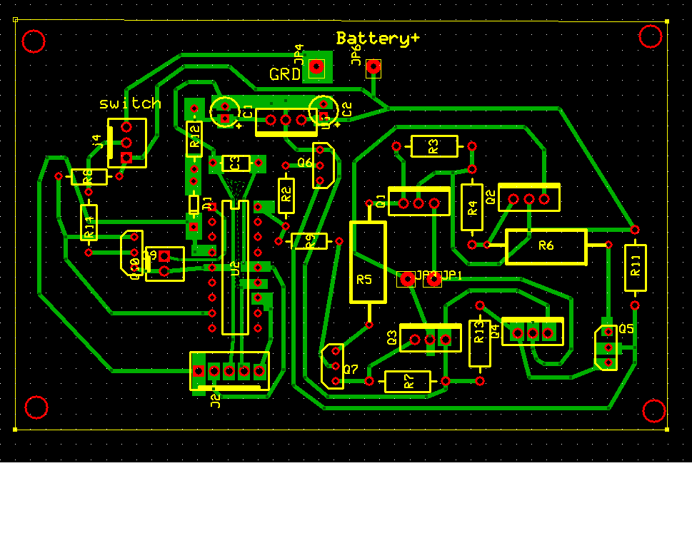

I have an ExpressPCB board designed but for the file needs to be something other than express pcb.
Eagle files are one that is mentioned.
Relative simple board single sided.

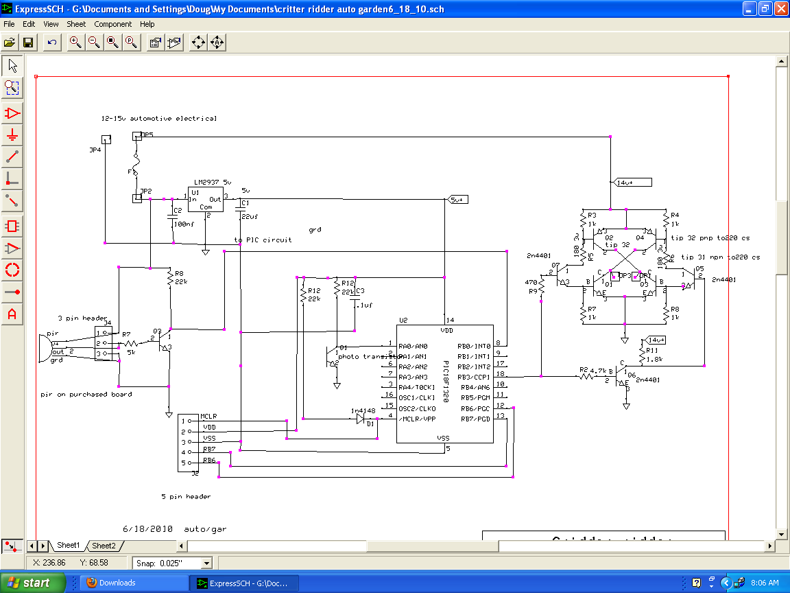

There are a number of us who would be pleased to make a quick Eagle layout for you. If you take a screen shot of your ExpressPCB layout we can get an idea of what you're expecting.
screen shot of sch and pcb

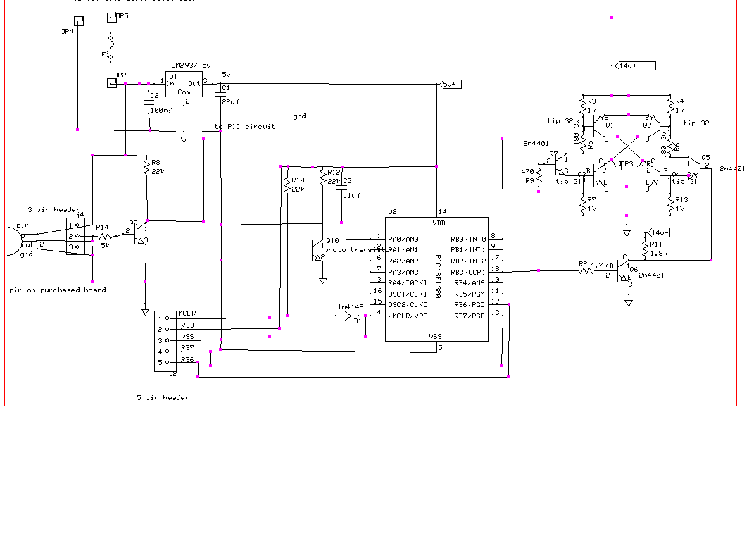

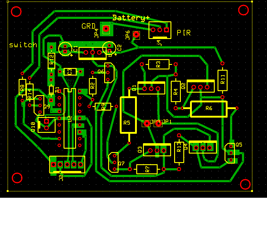

Here is a screen shot of the schematic and a prelim board layout.
The board does not have the photo transistor or the PIR circuit.
I had an after thought of have a duel purpose board for both apps One battery powered and one automotive electrical powered.
the photo transistor itself will be off board but jumper points to connect.
The PIR sensor is off board but a 3 pin header is needed.
board size as small as possable. The TO-220 transiostors could be layed down for better height clearance. Standing up I have only 1 inch height which adds to enclosure cost.
at present the enclosure is 6"L x 4"W depth of tweeter is 2" so the thinner the PCB layout is the better unless the PCBoard is mounted on the inside of the enclosure (board then needs to be 2 inches wide and up to 5 1/2 inches long.

It's been a busy weekend, I've done the schematic except for the capacitors and connectors. (I was waiting to see what size parts you wanted). I assume that everything on your board is the size that you intend to use. I'll see what I can fit into 2 inches by 5-1/2. (Actually my max length will be 100mm because I'm using the noncommercial Eagle.) So I will try for single sided 2" x 4" maximum.
Starting to label parts, choose sizes, and work with your layout, I'm having big problems.
Board has rearranged numbers for Q1, 2, 3, 4 making it totally confusing. Add to that, all of the pins on your TIP32s are swapped (EBC should be BCE). Collector is always center on TO-220 package BJT's! There are two Q1's, two Q3's, two R12's
I'll give it more time when you've added those new features you mentioned and cleaned up the schematic a bit.

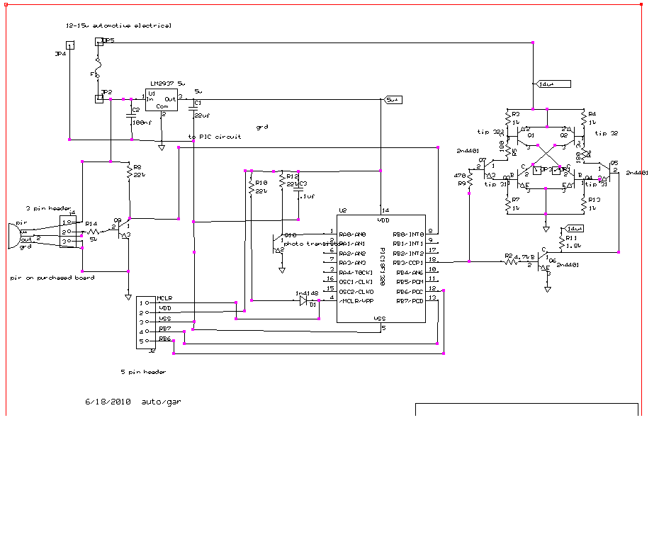

I accidently transgressed the wrong schematic that had /has lots of errors.
Will correct and in the mean time will fast track learning Eagle.

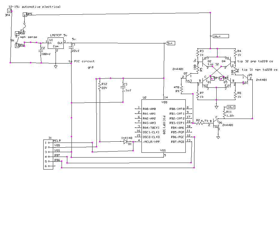

this should be correct
I added options so board can serve double duty.
Downloaded Eagle and started hacking at it ????

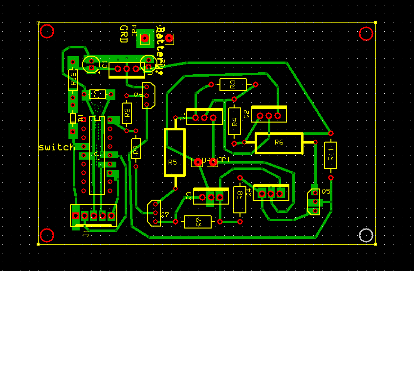

"Q1" and "Q2" (on the board) still have the collector on the wrong pin. The collector is the center pin on TO-220 (the tab).
I didn't check anything else.
I checked the schematic and componet files and all is good?
I rechecked the board and I had the pins switched BEFORE but think the last post is correct??
Q1 and Q2 collectors are connected together data sheet says pins =1= B, 2, 2=C, 3=E
on my pcb layout they, (pretty sure??) are correct??
smaller board
I reinserted the Q1 & Q2 componets. Maybe something I am missing??
here is a tighter board design 3.6 x 2.8 inches
If I went double sided could be smaller (less cost)

I don't know where I got the last schematic?
I have so many revisions that I started adding dates on the files
Here is the schematic I used for the last posted board.

I hope this schematic is correct?
