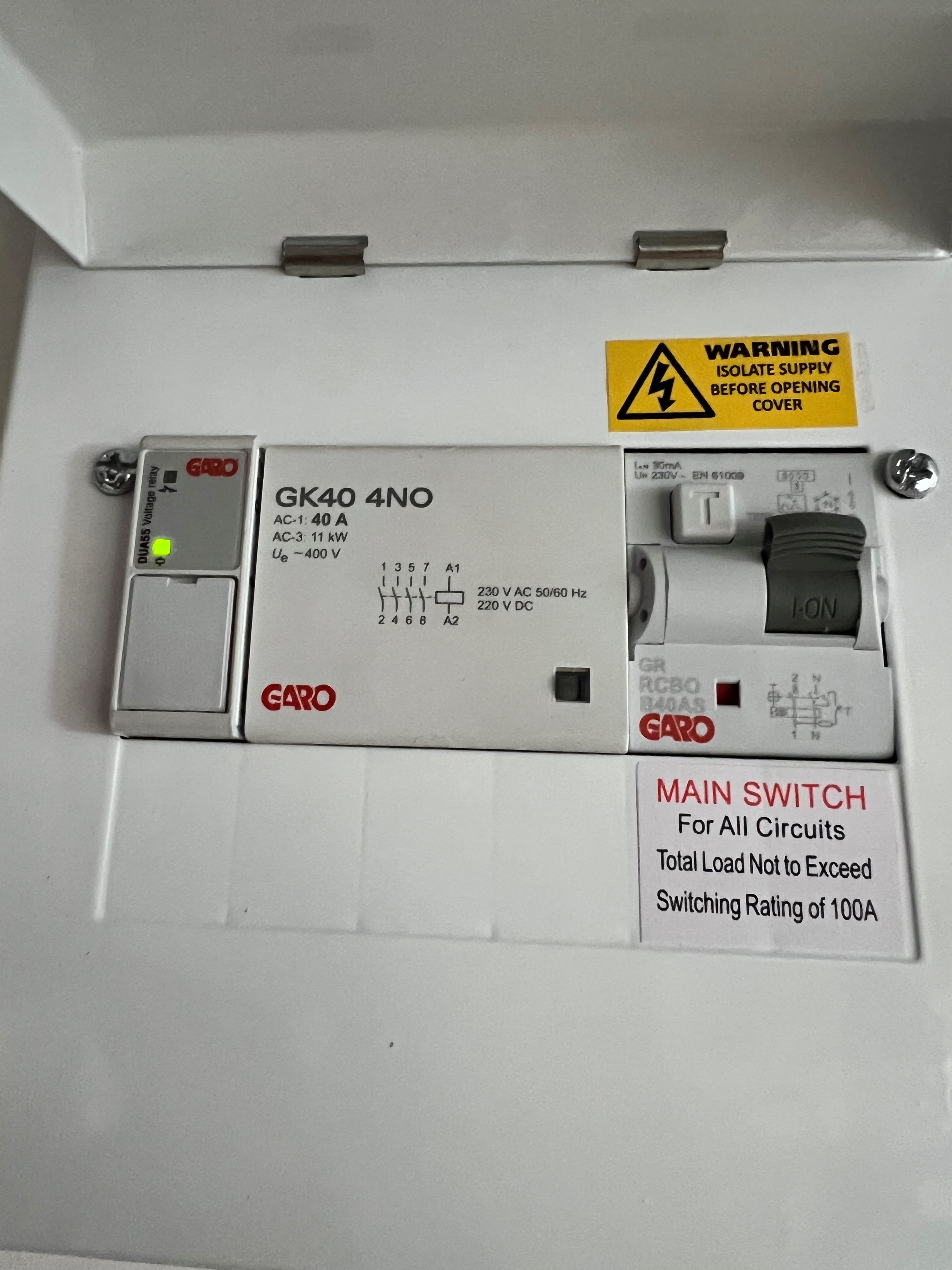

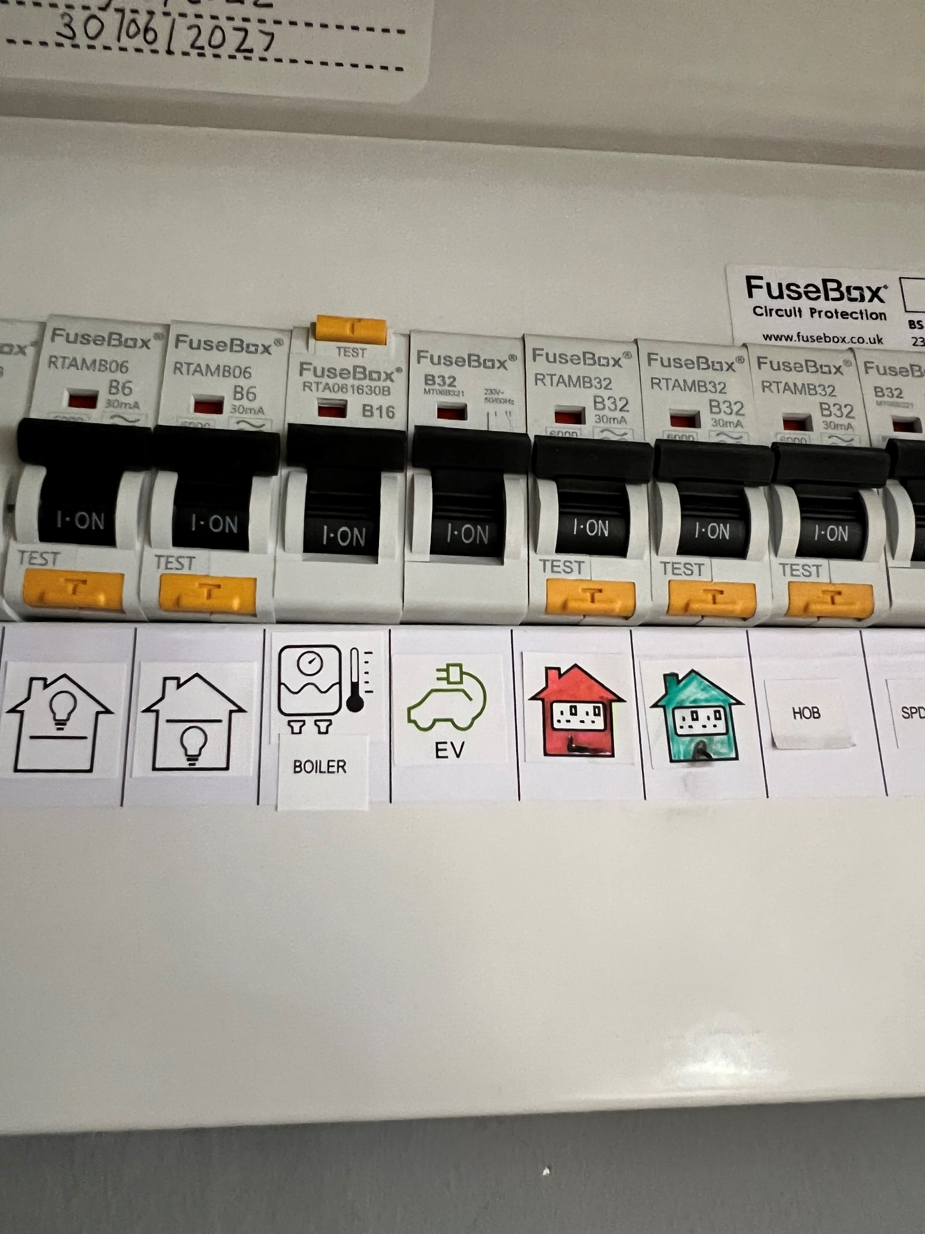

Hello,
I have a Shell NewMotion Advanced EV chargepoint installed at my house. It's wired into a GARO unit which has an RCBO B40AS and a GK40 4NO relay before it hits the main fusebox of the house into a fusebox B32 MCB.

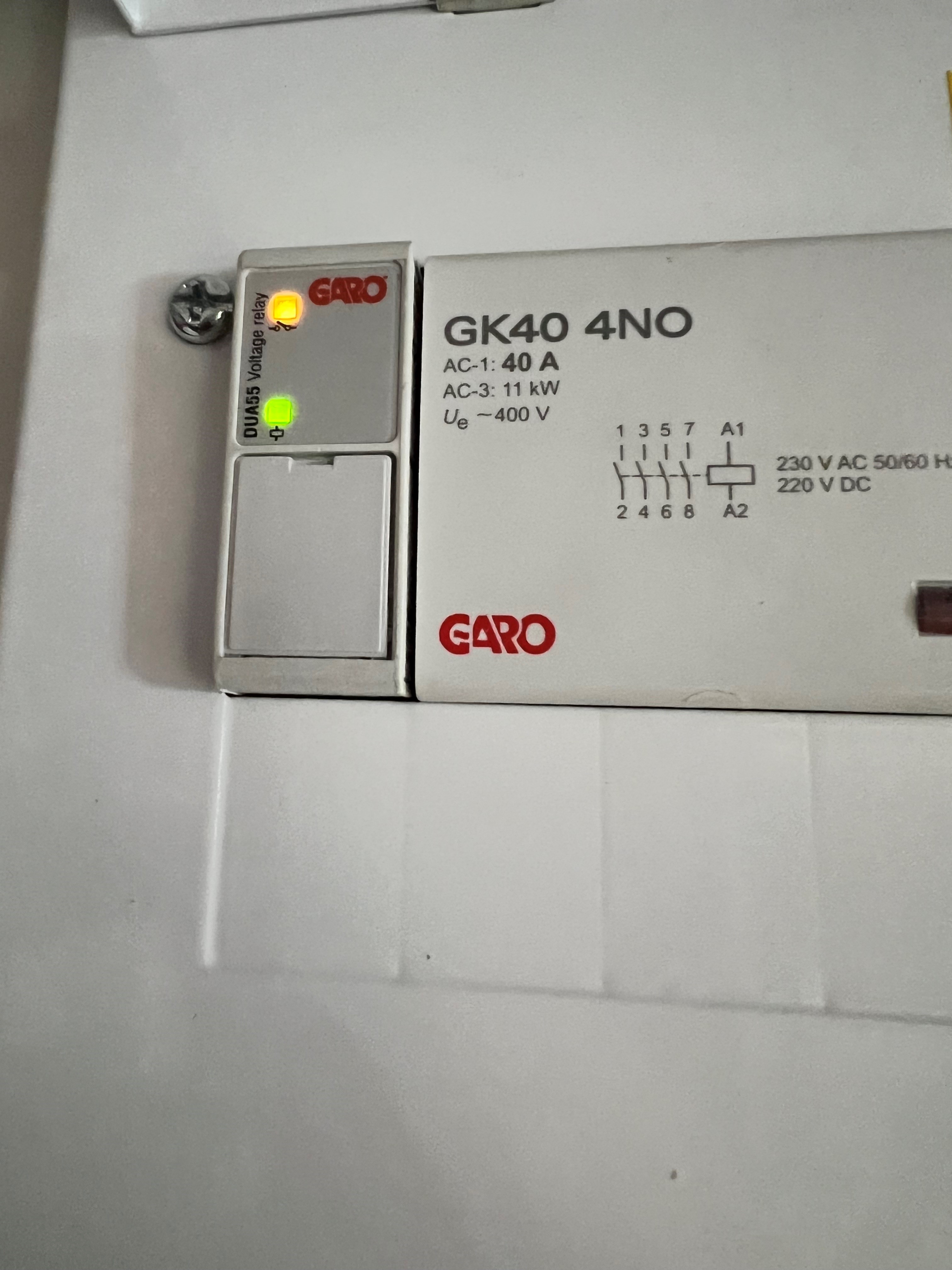

The problem i'm seeing is the relay in the GARO unit, it's energising and de energising at seemingly random times. So for example if the RCBO is tripped on the GARO and the MCB is tripped, MCB powered on then RCBO powered on the light comes on but it doesn't energise the relay, if i do it again a few moments later it may energise the relay when that's done.
The GARO unit has been changed 2 times now but this weird behaviour isn't going away. can someone help me to troubleshoot it?
I didn't install this btw, it was done by a firm who specialise in EV charger installs. I am not an electrician but i do understand electrics, i'm a former RAF avionics engineer who served 10 years and left in 2007 so electrical theory and repairs was a LONG time ago :D

That DUA55 unit is monitoring the mains supply voltage and switching on if it is within a set tolerance of whatever the installers configured it for.
The plate at the bottom should unclip and allow you to see the setting switches.
Data sheet here:
I'm guessing it's set to 230V +/- 10% as that is what the Newmotion charge point data says it requires.
The formal permitted range in the UK is 230V +10% / -6%, to include the traditional UK 240V system.
If the voltage relay is correctly set for 230V 10% then you need to contact your electricity supplier and complain that the voltage is going out of specification.
(Or you have something causing heavy interference / voltage spikes?)

My friend, you are a legend. I popped the cover off and it was set to 230 v so i've upped it to 240 +/- 15% voltage window and the relay seems to be holding so far

Yep Nigel, i am UK based. I'm surprised that the installers haven't seen this before mind you but I was happy to give it a go myself and it seems to have worked!.

UPDATE. The DNO have been (Southern Electric) they caught the voltage going from 248 up to 251 and that was enough to recommend a voltage monitor being fitted for a week (no date for that yet). The chap who was here said the permitted range is 216-253v but he said the main problem they have is houses with solar panels when it's v sunny vs v cloudy as they have trouble balancing the load. I have a house opposite in front and at the back of my property that have solar panels so i guess that may be where the issue lies. He said they'll normally come and fit a step-down transformer depending on how close we are to the main one for the street.
Since reading through the replies on this thread i changed the dip switches so it's 230 V + or - 15% and yesterday the relay de energised a couple of times, once in the morning and 2 times later in the day/evening which supports the solar panel theory but also that the voltage is going above 264.5 which is kinda worrying. I'd love to know what it's topping out at but i dont have a meter and we won't know until the voltage monitor is fitted...

I've not long had my fusebox upgraded as well so it does have surge protection, if that's helpful at all.
