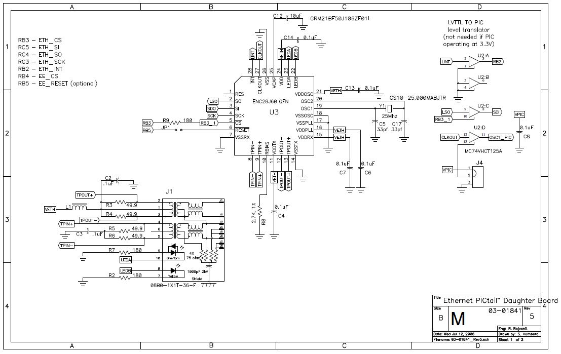

Noticed a TYPO can someone email microchip:
Ethernet PICtail Daughter Board Schematics
On the TOP LEFT side : EE_RESET is supposed to be ETH_RESET....
Assuming:
ETH = ETHERNET
EE = EXTERNAL EEPROM

Why do you think it's a typo the board optional 256 Kbits SPI EEPROM (25LC256) for storing web pages and configurations
How is it EE when RB5 is connected to the ETHERNET IC???
clipboard03-jpg.34456
IF RB3 = ETH_CS then RB5 = ETH_RESET

Burt from what i see in the datasheet. That RESET pin will reset entire IC. It will not touch the EE (External EPROM) So why is everyone defending Microchip? heh
They do typos all the time. I know the RESET aka RB5 is for ETHERNET USE and you all do too.. Check out page 62:
11.2 System Reset
You can see that reset pin will reset the entire chip. Its obviously not for EE data.
