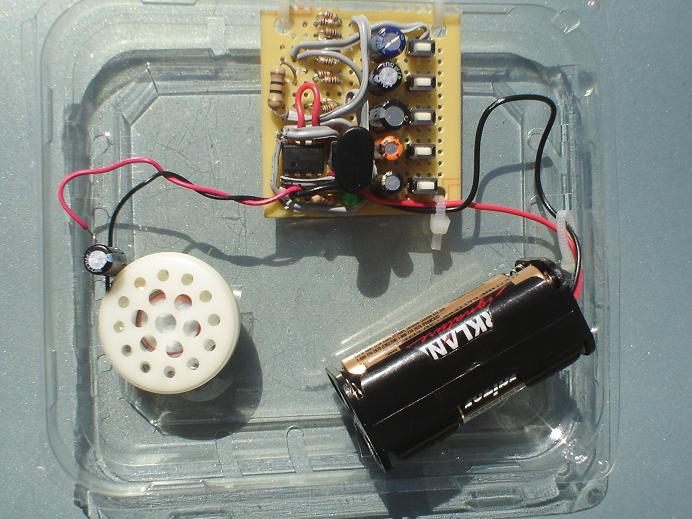

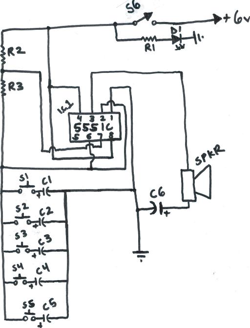

My website started a project page a few months back, and we try to do some sort of project every month or so with parts out of old TVs and such from around our shop. This month we did a toy organ, I thought it would be fun and something my young kids can enjoy playing with. Hope you enjoy, if you have any questions or suggestions please let's hear them.
Here is the video:
Electronic Toy Organ
Parts List:
SPKR= 28 ohm speaker from a pair of old headphones
S1-S5= tactile switches from an old portable DVD player
S6= SPST switch from an old flashlight
IC1= NE555P from parts stock
C1= 68uF
C2= 47uF
C3= 33uF
C4= 22uF
C5= 15uF
C6= 47uF
R1= 330 ohm
R2= 100 ohm
R3= 10 ohm
D1= 3mm green LED
I attached the schematic and a picture of the completed circuit.
I know this is a simple circuit done many times and different ways but I thought I would share it anyways. Have a nice day/night everyone. :)

It is a switched frequency buzzer.
It sounds horrible and does not play music like a real organ.
Jump on it then bury it.
I like the idea! Very simple, fun design. The sound is somewhat more annoying than it is musical though, and I would be surprised if the exposed electronics last very long with kids playing with it :p It'll be a contest between whether the electronics or your eardrums fail first :D
Pretty neat for something thrown together out of discarded electronics though!
What you really need is to use a MIDI synthesiser and make a real organ sound :)

ROFLMAO....thank you for comment...I realize it does not sound great it is not meant to be a real organ it is a simple toy,,:D

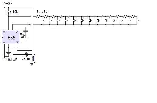

Here is a similar idea, but uses resistors instead of caps. I would still only make this for the short term, then disassemble it and move on.

Yes the kids only use it under supervision, not only would my 5 year old son break the thing quickly, he may also eat an electrolytic:eek:, that would be a nightmare.
I thought it was a fun project to do and it was quick/easy with what I have around. It does hurt the ears but with a few modifications it could sound much nicer I am sure.
Thanks for the comment.
I don't know an awful lot about audio signals, but maybe a PIC could be used to manipulate the waveforms and produce a more pleasant sound. Maybe audioguru can help once he's got past the jump-on-it or set-it-on-fire ideas.
I really don't plan on going any further with it, it's on to the next project. I like to do these simple circuits for my websites project page.
It is not an organ.
An organ has musical frequencies and musical tones. The 555 buzzer has neither.
The horrible sound might scare kids away from studying real music.
I don't think it will scare kids, all kids who have seen it love it. It is a toy organ regardless of wether you say it is or not, many people have designed 555 based toy organs, simple adjustments, some extra keys and it can have frequencies that correspond to normal musical notes.
I just played happy birthday on it, is that not real music? Defining real music can be difficult some say heavy metal isn't real music.
as far as quality of my organ you are right I probably should shoot the thing. Maybe I will make a video of it on fire just for you....
A PIC could generate sine waves using PWM and maybe even more than one at a time so you could play chords on it. ;)
You could add a simple low-pass filter to the 555 circuit to clean up the sound some too. Get it away from the raspy square-wave into something a bit more pleasant. Next, add a waveshaper and an adjustable filter and you're on your way to building a cool little analog synthesizer. :)
