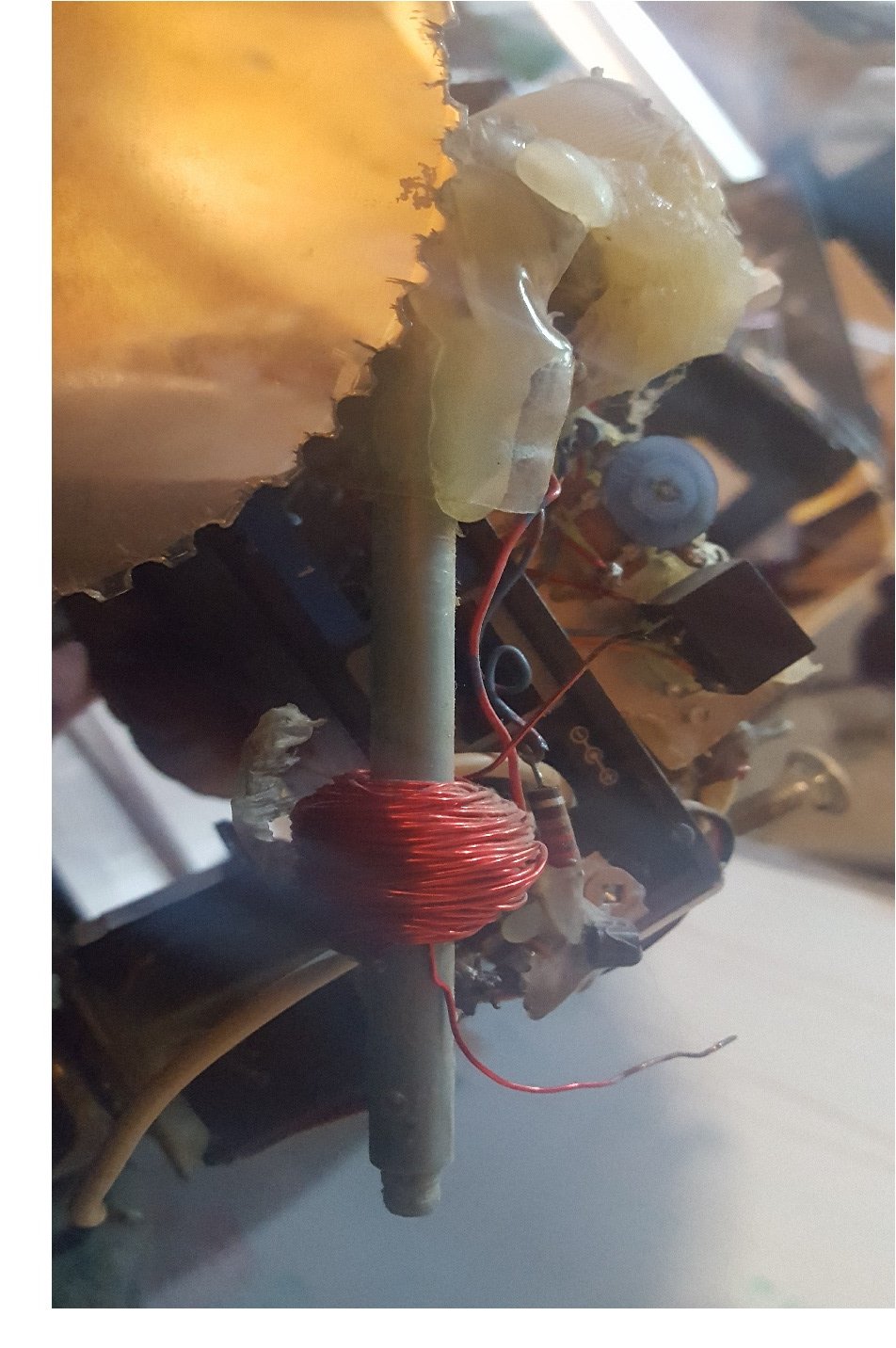

here is an example of my coilgun ... it charges two 1000uf capacitors to 400volts
i think it uses 22 or 28 guage but that was a bit too small since it fried after about 100shots
this coil is able to sling a nail across a 20ft room but not powerful enough to tear the paper target ... kinda like an elastic band and a paper clip ... i wraped it with a chunk of wire i found at x length ... not sure the turns count either didnt do it .... nor did i wrap the coil evenly
you need to realize that dc magnets and slow charging coils are bad for a coilgun since if the magnet is still charged when the bullet goes past it it will pull the bullet in and slow it down which is why you need higher volts for faster spikes ... having said that 400v/0.1 ohm (rough calc) is 4000amps ... but that is only for a very very short time in my small coil ... i too was supplying my coilgun with a Li battery ... but that battery is what runs the boost converter to bring the volts to 400.
if you visit the coil builders they provide info on what they used for their coiltypes and cap banks used based on their barrel sizes
