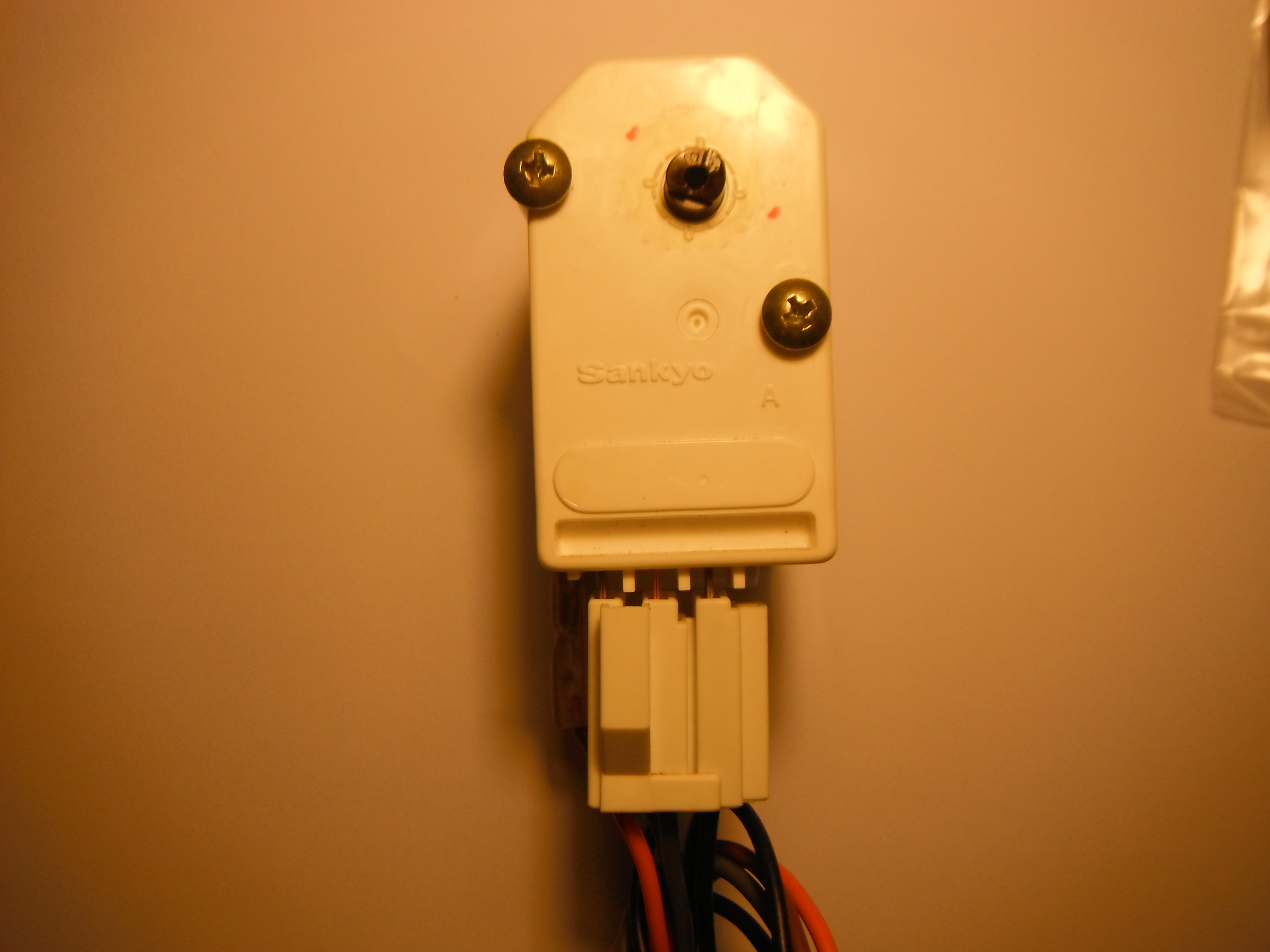

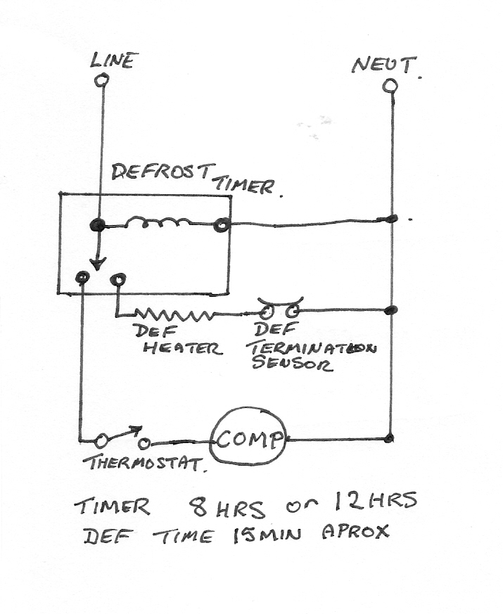

This is a typical circuit of a frost free fridge, & a typical mechanical defrost timer. The timers are usualy either 12 or 8 Hr cycle, on time for defrost is about 15min aprox. My frost free fridge uses an electronic thermostat & defrost timer. The mechanical ones seem to be disapearing these days, the one in the pict ive salvaged from an old fridge. There is also a defrost termination thermostat usualy stuck to the evap, this terminates the defrost element if the defrost temp goes to high before the timer has moved on.
Hello there debe,
Thanks for the very useful info. What is the power of the heater element and how big (what size) is the freezer section?
Hi Al Heres a picture of a frostfree evap & the heater is in the bottom where the blue wire goes & its 150Watt element. What you are doing with a plate type evaporator just isnt done comercialy with heating elements, they use hot gas defrost. But since what you are doing apears to work, just use a mechanical defrost timer wired up as in previous post & it should work. Like your aproach thinking outside the square.
