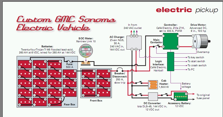

Ok....Here's the diagram from an actual conversion that was done for you non-believers out there
24! Big huge heavy lead-acid batteries!
It would move slowly like a snail.
Actually the top speed was 70 mph on that particular truck..I would have chosen different batteries myself..like Gell Cells.
Then added the super-caps later(with the so called buck-boost converter).
