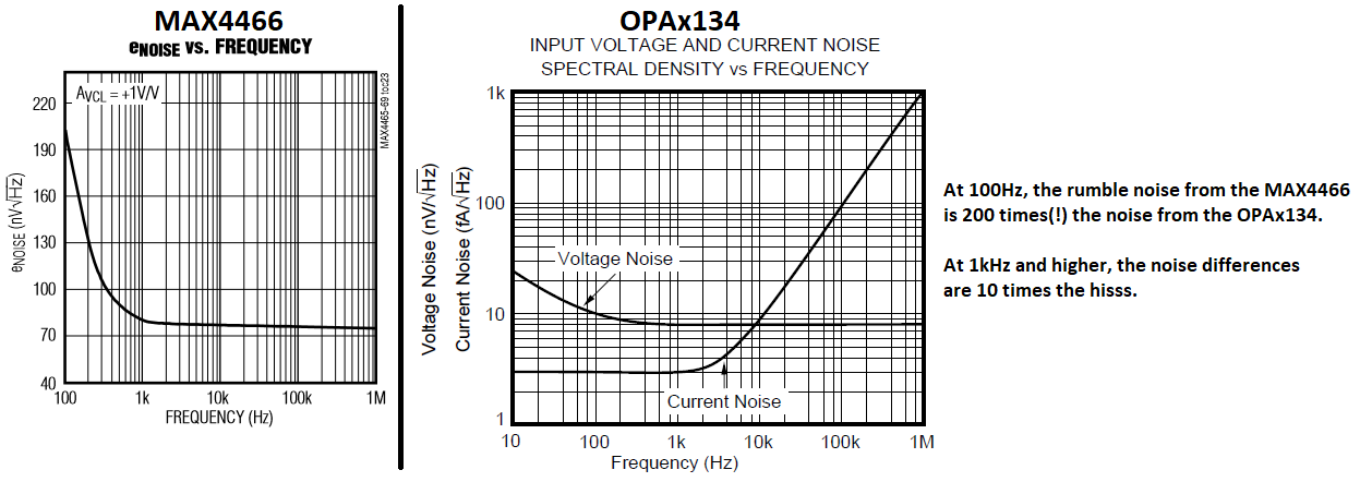

I wonder why the MAX4466 datasheet does not say it is low noise? Look at the differences between it and a good audio opamp:
