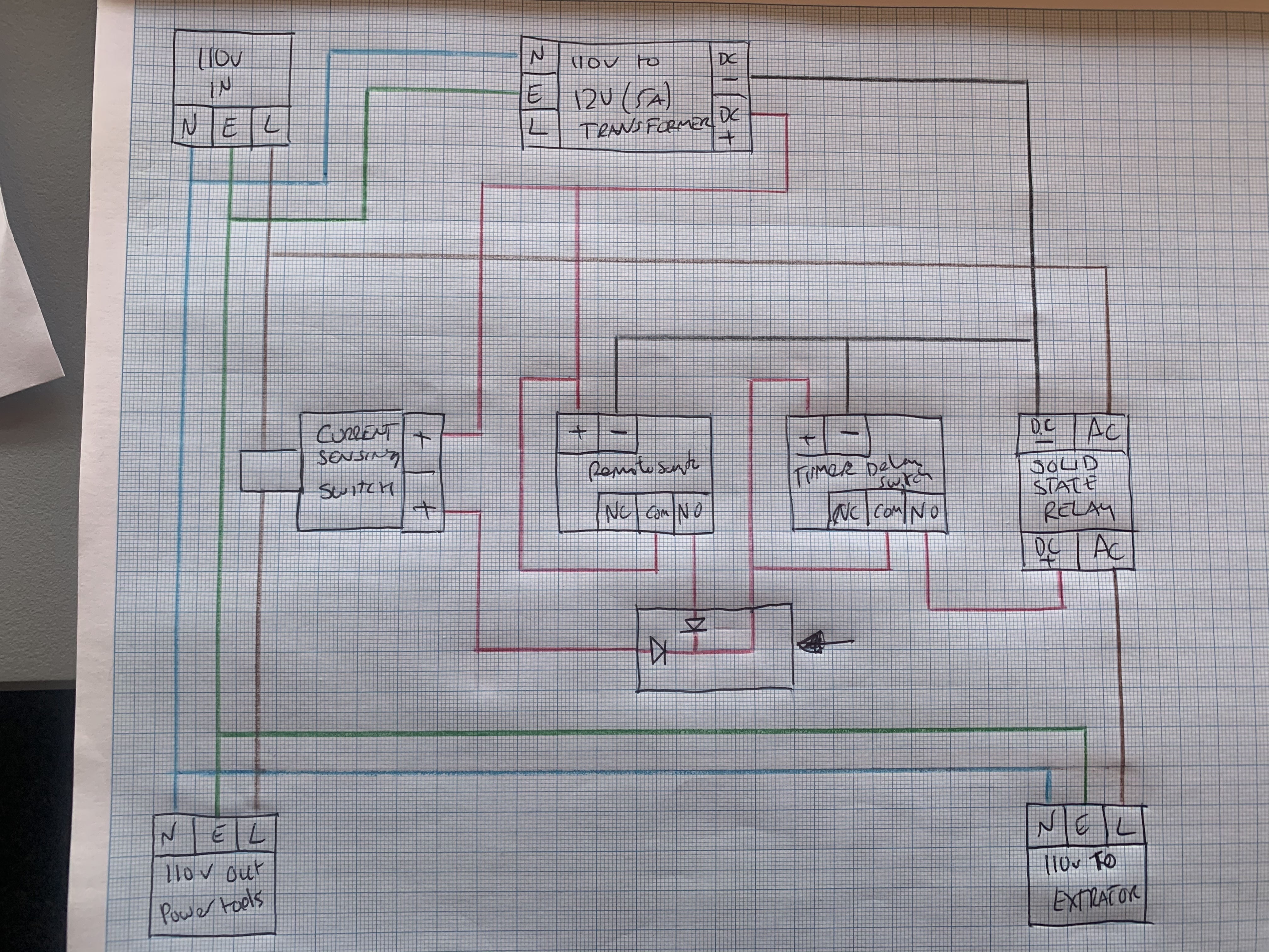

I have another idea I that I would need someone to check over if it would work(pic below) same as above apart from not using the auto start on the extractor. Just putting it all in 1 box together.

I don;t exactly know what I'm looking at.
Hints:
But you can fool the "system" by paralleling a contact across the current sensor switch output.
usually, you need a delay on break relay to keep the system alive until another device comes online. it also vacuums out residual dust. In general, you put a current sensor at each device or a voltage device. By voltage device, a relay that just provides a contact to the dust collector.
Portable tools, use a cord reel or your remote.
An additional problem that crops up, is for larger devices, like a table saw you might want to use your remote to turn on the extractor and then the saw the first time, so the saw and extractor don;t com on at the same time or you can add a short delay, e.g. turn on saw. A few seconds later turn on the dust extractor.
You also might have to open/close dampers,
Hi I will try to explain the drawing
I would like to have my corded tool ie mitre saw/router table/table saw plugged in all the time and when I use one off them I would like the extractor to switch on and have a 10 second off delay that’s why I was thinking of 12v sensing switch to the 12v timer delay relay to switch ssr for the extractor to switch on. I also use cordless tools and would like to turn on the extractor and have the same 10 second off delay via a remote. So put 12v remote relay using diode but not sure if I would need one.
You might be missing a delay. That would be that once the last device turns off, start a timer for a few minutes that keeps the extractor on until another device draws current.
You should be able to just put the switches in parallel. I doubt if the diodes are needed. I've got a garage light that turns on when the PIR sensor notices movement in the garage, or the light is on, or when the garage door opener has operated in the last minute. That is just three switches wired in parallel.
I don't see why the remote switch that you added needed to have some change-over device. It could have just been put in parallel with the current sensor in the dust extractor. Maybe if you explained how that modification to the dust extractor was done it might help.
This is to be independent to the extractor, I want it to control the power cord going to the extractor. The change over device is ac to dc transformer as the relays and switches are 12v dc.
I come up with the same thing Diver300 said. Your current sensor(s) is just a switch that eventually turns on the dust extractor through a high current relay/SSR. Any device just needs to parallel that. It could be individual equipment or or a remote.
That contact needs to be extended say a minute, so your not turning the extractor on and off.
You may not want the saw and dust extractor to turn on at the same time.

I thought the current switch and remote switch need separate feeds as I want them to work at different times. Cause my understanding is the remote switch wouldn’t pass the signal from the current switch through without in switch on?

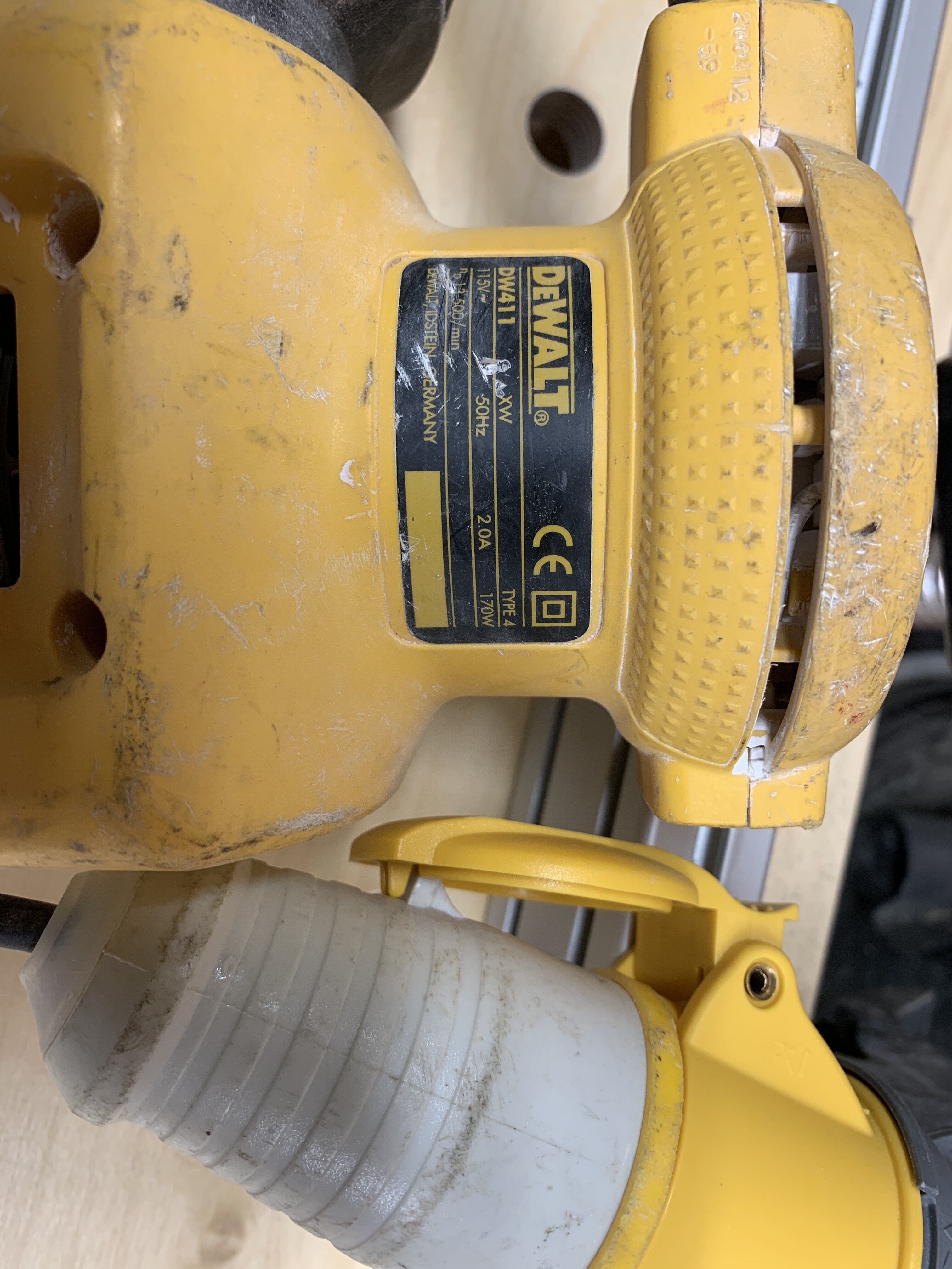

Thats exactly what I want here’s a picture of the spec of sander it’s the smallest wattage tool I have to check that turns on the extractor. I just knew you would come up with something that would work for me.

What this means is:
Say I'm using a belt sander that turns on the dust collector. I turn off the belt sander because I want to use the finishing sander.
The dust collection system, should not go off at the same time I turn off the belt sander. It should give me some time, to put it down and turn on the next tool. order of magnitude (minutes). If I don;t pick up another tool in x minutes, the dust collector turns off.
So, pretty much you have one current sensor like your diagram indicates.
You have two choices:
#1: "bypass" the current sensor with the remote.
#2, Add a load to fake it.
#1 is your best option.
I "think" you missed the usual design goal of not stopping/starting the dust collection system. In real shops, it's huge.
This is the job of the retrigerable "delay on break" timer. It pretends the tool is on for a short time (1 minute) after the tool turs off.
You don;t have to worry about the tool and the dust collector turning on at the same time.

Why even go that route, Just parallel a contact across your current sensor contact, which I assune is a sensor that closes it's switch above a certain current.
See something like : https://www.geya.net/timer-relay/multifunction-time-relay-2/ E. Off delay.
So, you need to create a set of potential free contects from your current sensor (relay). This guy gets powered all of the time. The contacts, of the relay go in parallel with your current sensor switch(s). This, then keeps the contact energized for say 1 minute after turning something off. Also known as a delay-on-break timer. Aliexpress has these really cheap usually.

15W is a whole lot less current. P=VI l says 15=120*I; I=0.125 Amps. that's on the order of what I suggested. Why i picked that, it's about a minimum load size for a triac to stay on.

So if I use the voltage at 110v and resistance at 50 ohm I get 242 watt and 2.2 amp so if I use this one would work?

I have good and bad news:
Your cutting it too close on wattage. This https://uk.rs-online.com/web/p/panel-mount-fixed-resistors/6641871/ might be a better choice. A 400W resistor was cheaper than a 300 W resistor. You don't have to solder if you use the wire leads.
250w is a lot of power to be wasteing, but it's actually good news too.
The RF switch is sold as a "Definate purpose contactor", so if you were switching 0.1 Amps, the relay contacts MIGHT become unreliable
A relay has what;s called a "Wetting current". That's how much current you have to minimally have for good reliability.
250W has a really good chance of not exceeding that.
I don;t LIKE the design, but it should work.
A note:
2 resistors of the same value in parrallel is: Req=R/2 so, two 8 ohms is equal to 4.
Wattages add: so Two 100W 8 ohms in parallel is 200W at 4 ohms,
Resistors might be found at surplus places,
250W is too close to 242. I'd be happier with a 300W. resistor.
