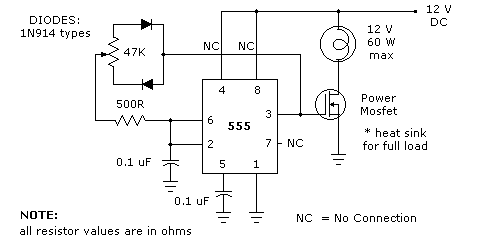

Hi everyone. I was just wondering if there is a very simple circuit that I can make in order to have fog/driving lights on my car always on (when the ignition is turned on) but a low intensity and then have a switch that allows me to turn them on full beam when needed in reduged visibility/fog etc. Is this possible? Can someone please help me out here.
Thank you very much
Can u tell us the wattage of the lamps please, this will help to find a suitable circuit for your needs.
Hi nasty gurl,
There are two simple circuits you can build to control your fog lights.
Do you want it fully automatic (as in starts at dim on motor start then goes to bright when you push a button) or switches from bright to off to dim manually?
Thanks, Tony
Hi thanks for your help. tansis the wattage will probably be 55w and seeker, I just found out that your first option (which I wanted) is illegal so the second option would be great. Thank you very much for your help. I am fine with doing the electrics, just not designing them. Thanks
What kind of Power Mosfet can you use? I tried a circuit similar to that with a Tip31?

How about this? Simple Automotive Relay, Toggle switch in the cabin, and 20w 5ohm tubular resistor... it's gonna get hot, but that's the easiest cheapest way to run it... somebody would have to redo my math, might need 2 of those, one for each headlight to bring 14.5v (running car voltage) down to ~10volts which I calculated as ~1 amp dropping 4.5v is that 5watts? Or is it 1amp * 14.5v = 15watts?
I used to know where to find a 20$ DRL module, but now they're all 35$ and up, so thought I'd share this... because that's all the DRL modules are.
