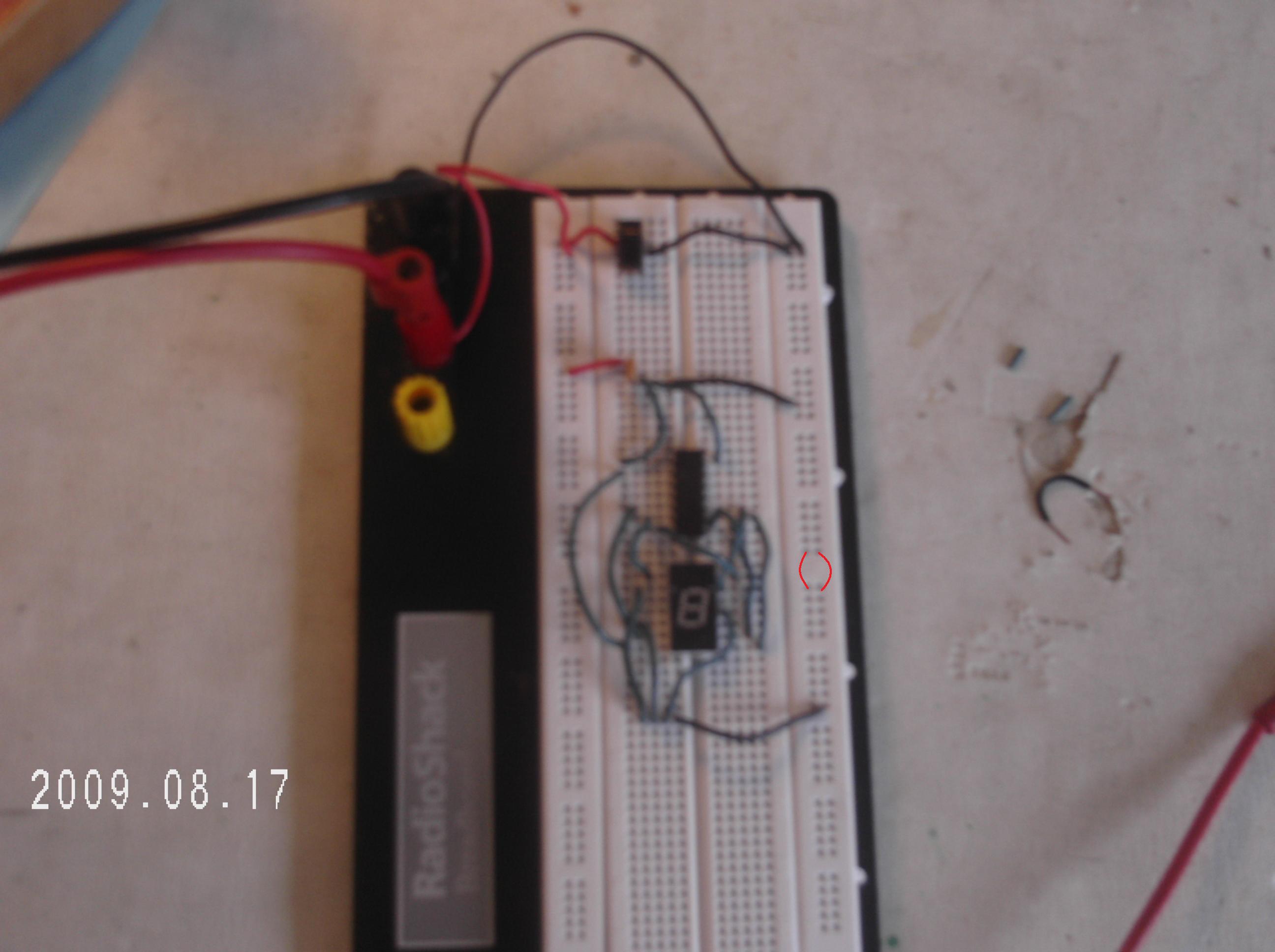

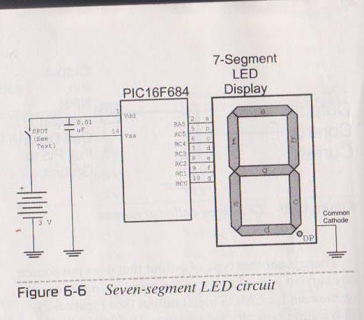

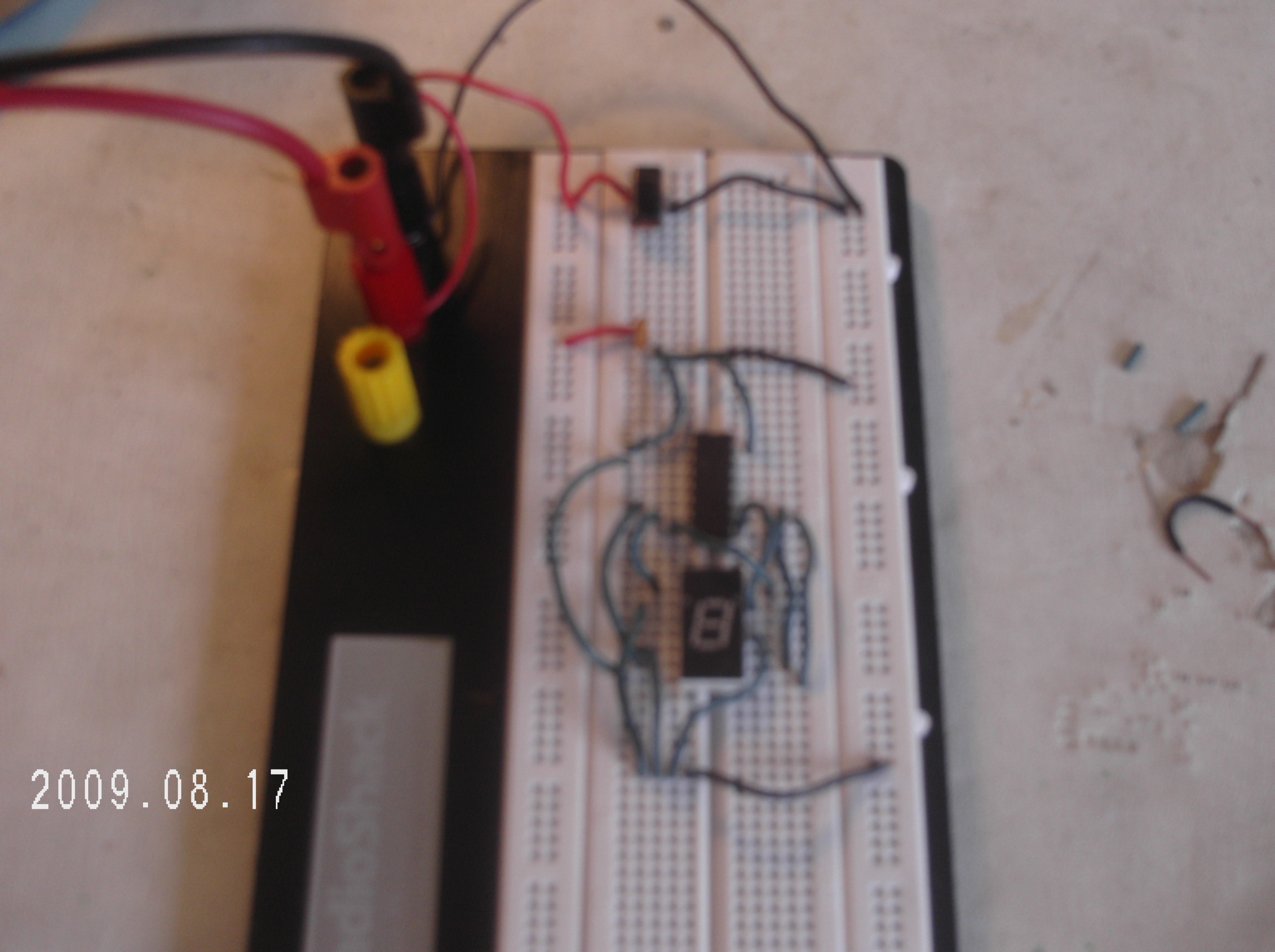

I'm having trouble building a circuit to Drive a seven segment LED to cycle thru all 10 digits. Below is the schematic that I followed and the next pic (albeit a little fuzzy) is the breadboard prototype. Is there any way you guys could tell me (if you can actually see any detail) if I wired it up right or not.
First time I built it I grounded all of the pins that weren't used. When I flipped the SPDT switch to the on position my voltage dropped from the 3V supplied to .9V and my current went high. When I removed the wiring grounded pins it doesn't react at all.
I programmed my PIC16F684 with the code I wrote in C language. and used a DC power supply instead of batteries.
I appreciate all helpful comments!!

You need current limiting resistors on the segments. 330 ohm is a good choice.

Anyway, first of all you'll need current limiting resistors on the segments, to protect both the LEDs and the PIC.
Next, post your code. No display could be a problem with the circuit wiring or a problem in the code. You did flash your code into the PIC, right?
Do you have info on the 7-segment display? Datasheet? Pinout?

Haven't looked in detail at your code, but typically the breadboard you are using needs some extra jumpers which I've added in red. They are also needed on the left side of the picture also, but the image made this difficult to show.
