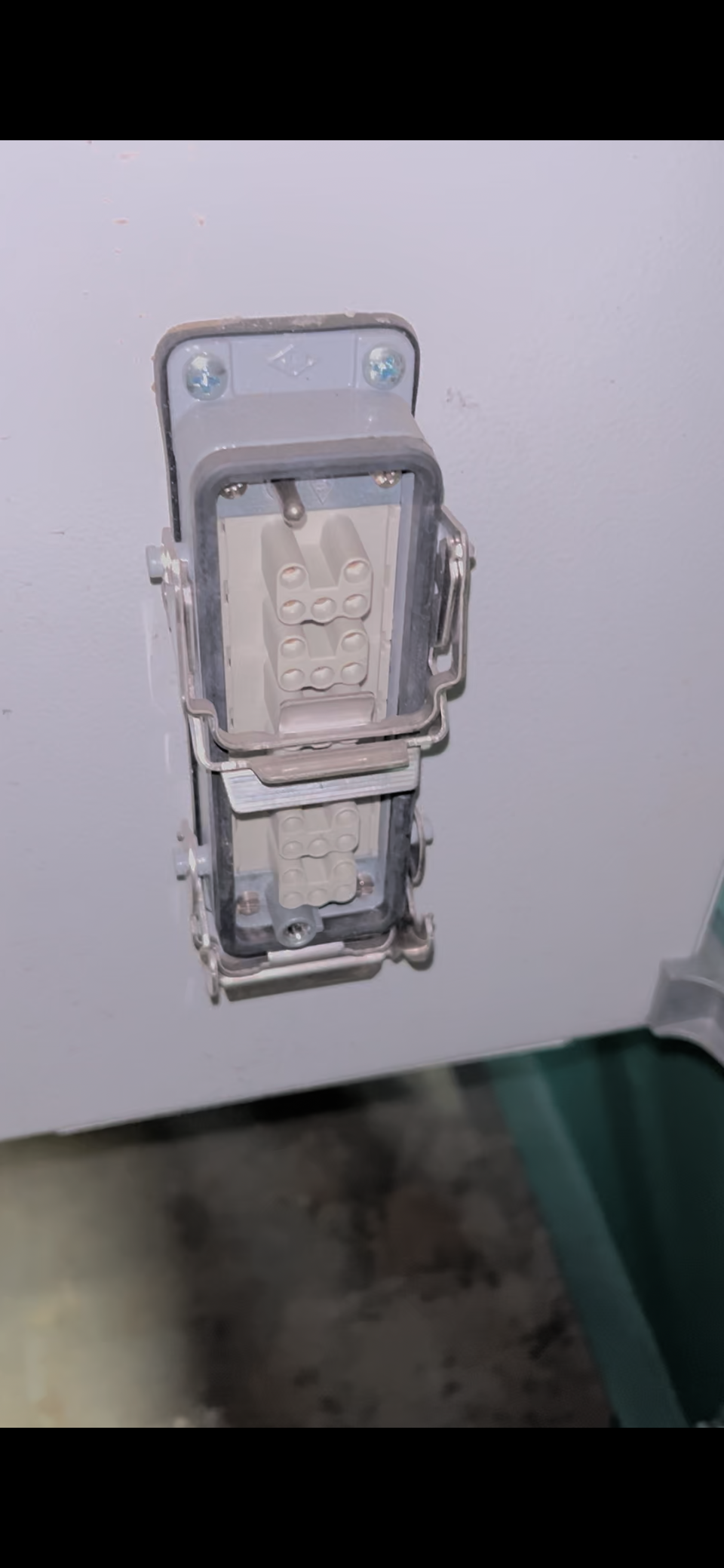

Does anyone recognize this panel-mount connector?
RichWargo
One of our salespeople snapped a picture of this unknown connector.
Would appreciate if anyone would let me know what it is, who made it, etc.
It's a standard rectangular connector shell with a bank of six, five way inserts such as these:
Frames similar to these take the modules and allow them to fit standard size hoods/shells:
There are several makes which are supposed to be interchangeable (using the built connectors, at least).
eg.
I've used a few of those modular assemblies, they allow you to build custom connectors with eg. high current motor power, 24V PLC I/O & encoder feedback in a single unit. You can even get such as Ethernet and RF modules, with screening as appropriate.
