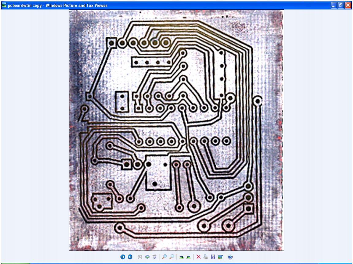

Here my first try at it I think it came out very well all but the bottom ground.
And with all the parts on the front side. I don't think it to bad for reusing some old copper.

I like to place a sacrificial wide line around the entire design. Many times the line will fail to transfer/etch but the rest of the design will be perfect.
Or take a fat sharpie around the outside edges of the board. I used to do that to stretch the ferric chloride life (I would color in any large areas as well or polygon them in Eagle) and it speeds thing up a little.
Heat all over is key for sure.
I need to get one of those cool made in China stamps though.
The CNC I use for drilling requires room on the bare PCB for clamping. The extra board makes the PCBs a bit easier to handle/process. I use cheap box tape to mask over the unused area to save on etchant.
I also use it to mask the other side when I etch one side at a time.
To save on etchant and time
I increase the distance from traces to ground planes.
then only the space between the trace and plane are etched.
also found using a thin board so that light can be seen in the etched areas so any shorts or trace breaks can be seen very clearly when held up to a light.
the board pictured has liquid tin applied.
It seemed to make soldering easier.

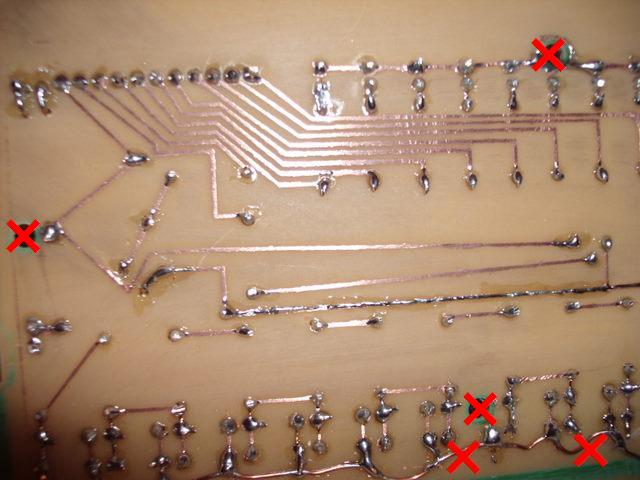

Please don't be offended and take this as constructive criticism.
I know this is your first attempt, good it works but next time I'd advise neatening it up a lot, it's far too sloppy. If I designed a PCB like that at work they would tell me to do it again; it wouldn't even be allowed to be manufactured, it would have been rejected at the design phase.
The resistors should all be mounted straight (preferably at right angles) with the leads perfectly straight and no wiggly bits.
What's with the copper wire?
Did you forget to put the traces on? Fair enough these sorts of modifications might be necessary at prototyping phase but it certainly shouldn't be part of the design.
Those holes are far too near the pads, traces and components. You should allow enough room for error when drilling and for any fixings you plan to use: nuts, washers, screws etc.
Also try to make the tracks at 90° or 45° angles and avoid tight corners which tend to etch poorly.
I've put crosses through all the really bad parts. To be honest the rest isn't much better but most could be fixed by forming the component leads correctly and better soldering technique. You've probably got many poor solder joints whcih can't be seen on the photo.

I tend to make the ¼W resistor leads 0.4" (about 10mm) pitch so I can use veroboard as a forming jig.
You might think I'm being picky but it's important to do a reasonably neat job otherwise fault finding can be very difficult: bad joints can be open circuit and crooked connections can easily short circuit. You want to minimise that risk of errors not maximise it.

Even if I overlook that, it's still a pretty shoddy job. What's going on with the resistor with the long scruffy leads stretching from one side of the PCB to the other?
It's a obviously a PCB design fault; that can be fixed but it won't be pretty.
If I did not have the option of making a new PCB (which I would do if possible) I would have drilled another hole, mounted the resistor straight and tacked some insulated hook-up wire to make the connection on the other side. If I wasn't allowed to drill a new hole, I would have covered the resistor with clear heatshrink to stop it from shorting.
Using an old board is no excuse for such poor workmanship.
If the board is old then it doesn't appear to have been properly cleaned before reusing it. As much of the excess solder as possible should have been removed (using a solder sucker and desolder braid) and the whole thing should have been washed in alcohol to get rid of the remaining flux.
Again, as I said before, some of the solder joints appear to be poor but it's not that clear looking at the tiny picture.

hero999 you anit hurt my feeling the board had the holes in it when I found it.
It came off a motor controller and i sanded off where four wires was solder to it and reused it just to try it out never did it before the one hole on the right hit where two
resistors went and the jumper I forgot to run the ground to the header I like junk have a basement full of it. and plan to use it some where. LOL
