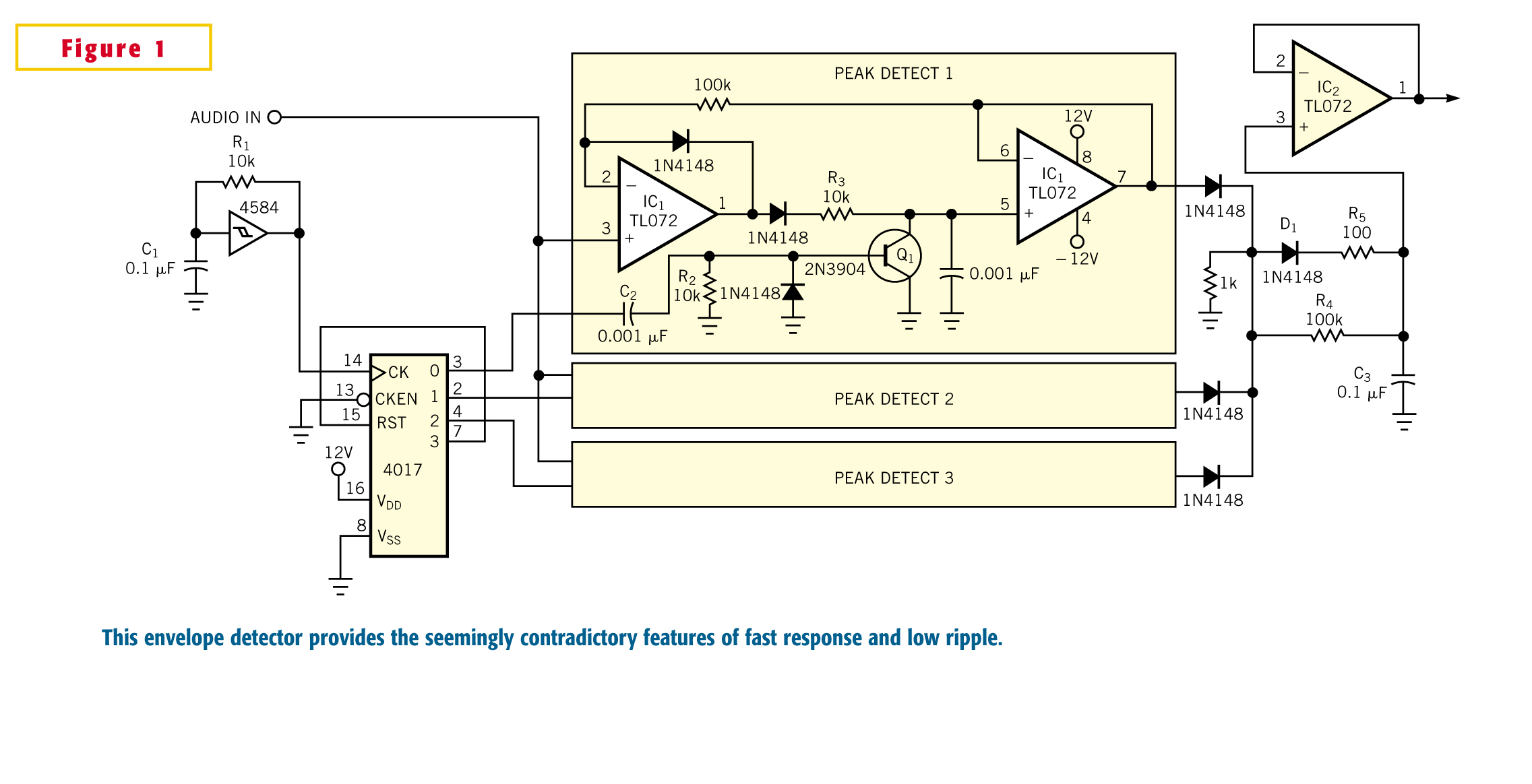

Is Fig1 supposed to be an example of a bad schematic? Q1 has no emitter/collector distinction :confused:.
In the context of this thread I think there are three kinds of schematics:
1. Really bad.
2. A little bad.
3. Very good, professional looking.
The really bad ones have diodes pointing in almost any direction, with no regard for relative parts placement, input could be on the right side instead of the left, etc.
The 'little bit bad' ones arent too bad, maybe the author didnt have a huge amount of experience drawing them yet.
The very good ones look like the parts are drawn clearly either vertical or horizontal.
