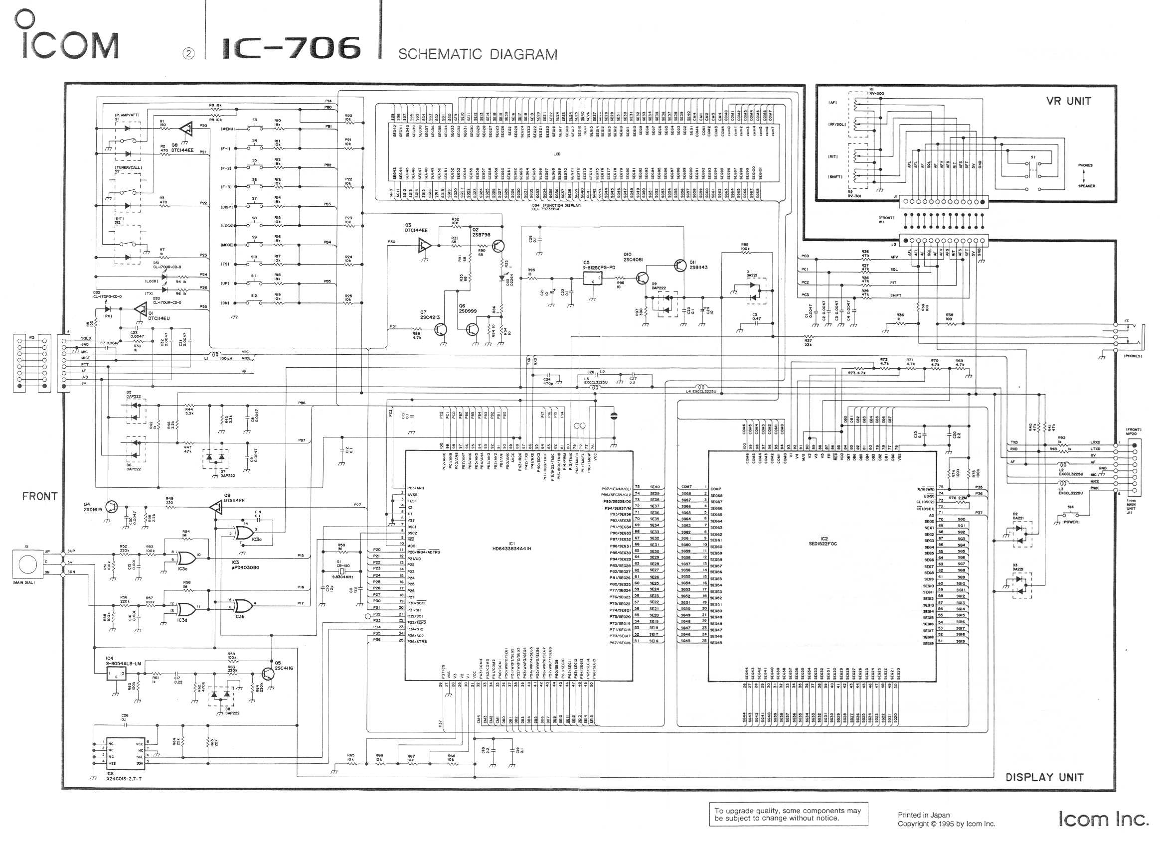

There is another valid angle exception - diagrams with "bus" sections.
They are commonly drawn with a short angled section at a branch, which indicates which way along the main bus you need to look for the other end of the signal(s) in the branch. A bus branch may have a double angle if connections are to both sides.
That's common in various complex equipment schematics as well as digital gear.
Example:
Example:

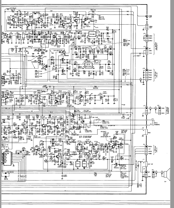

A pet hate of mine, which the Japanese seem to specialise in...
a whole hoard of connections which run in parallel from one side of a schematic to the other, with several changes in direction along the way.
As typified in this circuit fragment from an Icom R72 receiver.
One point about buses - it's like an express bus pretty much from one point to another, connecting similar pins from one place to another, like a entire port of a micro to corresponding pins on a memory chip.
It's not a cross-town bus, picking up a single bit or power connection here, a single bit from another chip there, dropping off a bit to a chip here, several bits to a awitch there. Yoi can't draw a bus around the perimeter of a schematic and have every connection on the schematic hop on that bus. Doing so defeats the entire purpose of a schematic.

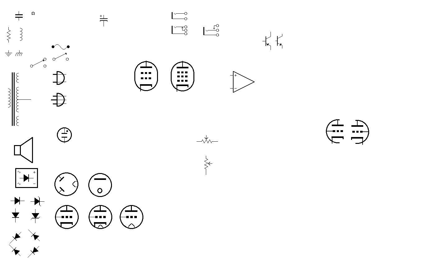

I've been creating my own schematic symbols and building my schematics with Windows Paint.
I posted the symbols that I've created in the hopes that they will help someone else.

Yes nice.
Not many people use tubes these days but good to have i guess.
Yes nice.
You'd be suprised. :)
Audiophiles swear by them. Guitarists would rather lug a tube amp around than a small solid state amp,
simply because they sound better. Also, there are a few guitar pedals that have a bottle in the input stage.
I used the tube templates to design guitar amps.
there's a huge difference between what an audiophile is looking for in an amplifier, and what a guitarist is looking for in an amplifier. except for a small minority of audiophiles, most prefer an amplifier with very little distortion, a flat frequency response, and low noise. a guitarist on the other hand is looking for a particular "sound", which may be somewhat distorted, have a frequency response that is far from flat, and maybe a little bit of noise.
