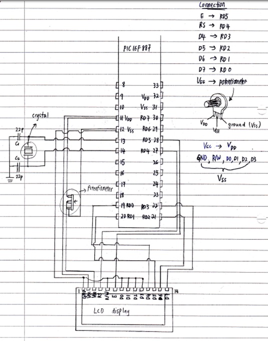

Here is my draft for the connection of the electronic component to the microcontroller. Can anyone help me to see is it correct?
Thanks.
Vivian

Here is my draft for the connection of the electronic component to the microcontroller. Can anyone help me to see is it correct?View attachment 71789

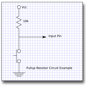

In general, when using pullup resistors for switches it should look like this:
Depending on the LCD you use, you may find you need more pins than you will have available with your current pin usage in your schematic. You can gain additional free pins by multiplexing your additional switches and LEDs into the existing calliper matrix. You could therefore connect all 4 switches and 4 LEDs using only 1 pin rather than 8.

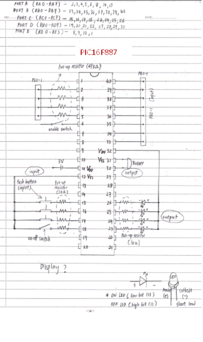

Is the connection of pull-up resistor for PEO-1 is correct?
No, you have drawn series connected resistors. Pullups resistors will connected from the microcontroller pin to VCC, as per the switches.

Hi Doug,
That means all the pull-up resistor need to connect as same as the connection of pull-up resistor for the switch?
Vivian
Yes

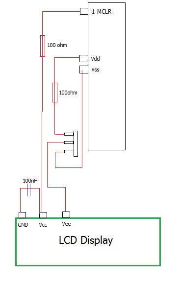

Please help me to see is my connection is right. Thank you.

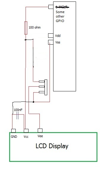

Looks good. Because you wish to have a software ON/OFF function, you need to be able to shutdown all external devices that draw current, e.g. LCD. You can power the LCD via one of the microcontroller pins; a suggestion would be to use a series 100 ohm resistor from the microcontroller output to the LCD VCC (and the positive side of the potentiometer) in addition to a 100nF capacitor across the LCD VCC/GND pins.
Is there any reason you have a crystal oscillator attached? If you don't need high timing accuracy, you can just use the internal oscillator of the PIC (8MHz-125kHz adjustable range 1% accuracy).
Is this what you means?
