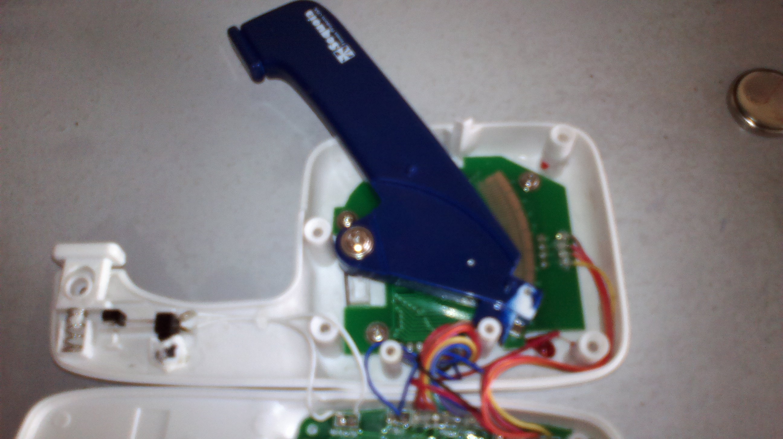

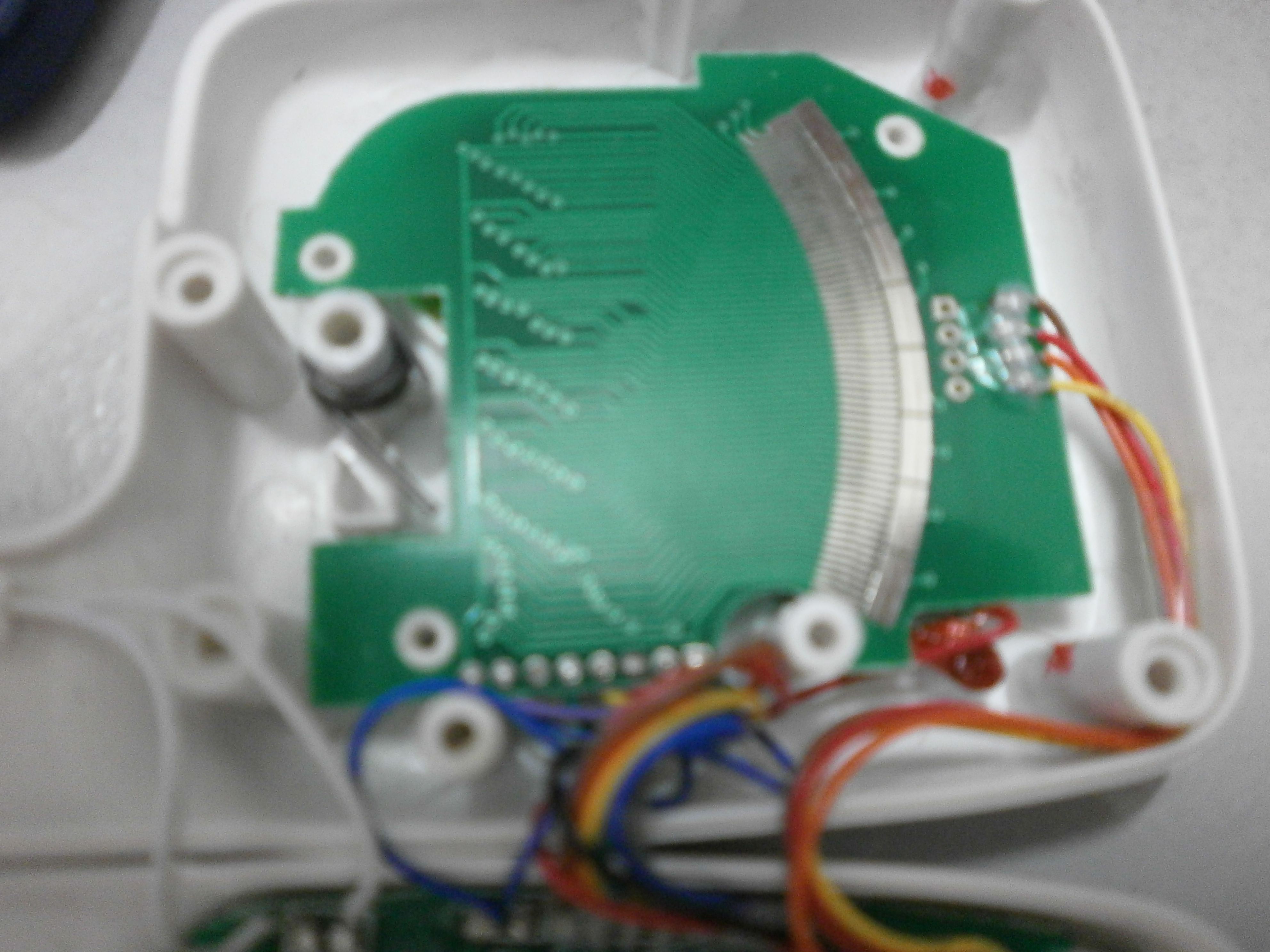

Anyone know what kind of sensor is used in the picture attached?? This is a circuit for digital body fat calliper.
Thanks.
Looks to me as though this is a mostly mechanical device with a straight digital input - presumably to a microprocessor.
There are 8 big pads and each big pad has 8 smaller pads next to it. I would guess that every 8th smaller pad is connected.
So all you need is a micro-controller with two 8-bit ports free for reading calliper position, and some simple code to make it work.
EDIT: ... except that there are only an 8 pin connector and a 4 pin connector to the board - so there must be some kind of multiplexing going on.
... would need to examine the sensor board and the control more carefully to get the full picture.

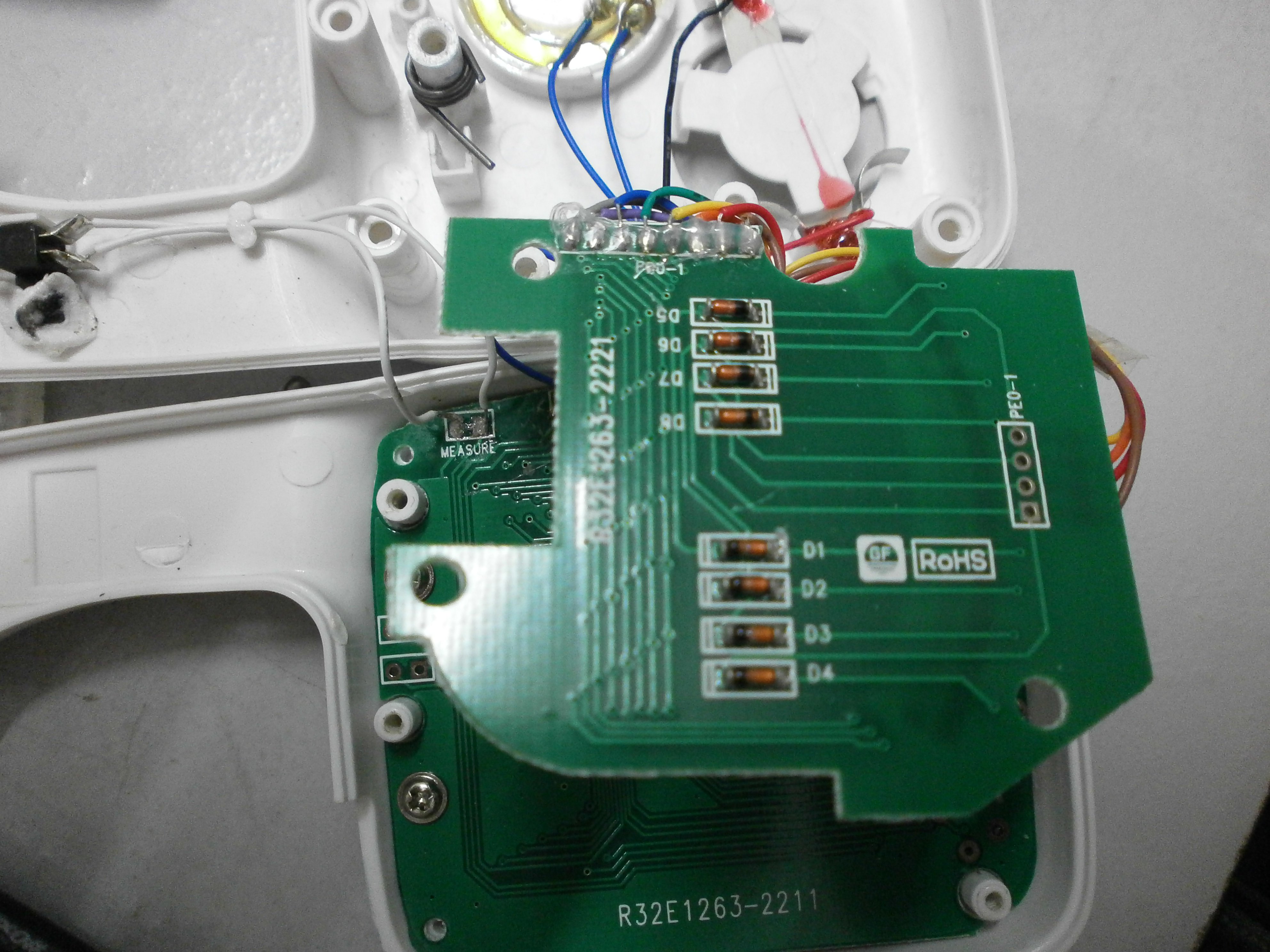

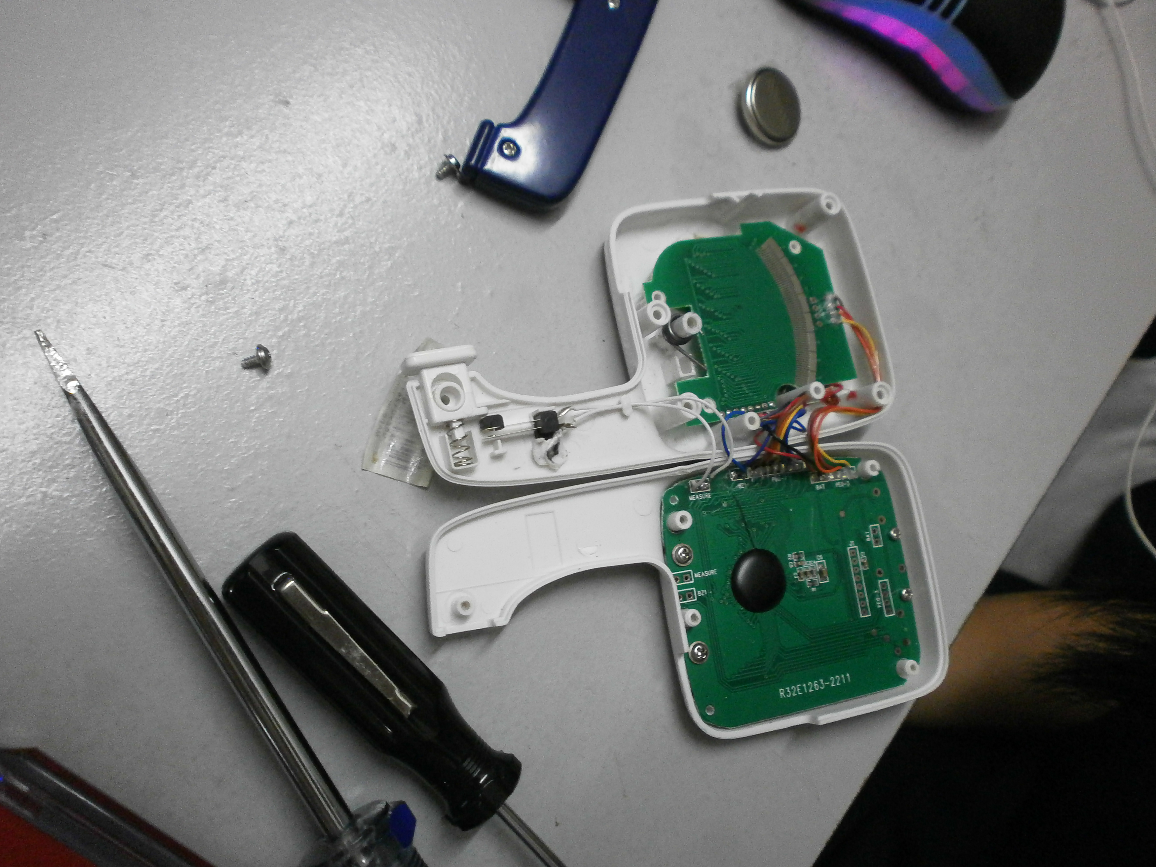

Actually I want to rebuild the digital fat calliper and edit its coding. Here attached is the other part of the circuit of the digital fat caliper. Anyone of you have ideas what is the components that i need to rebuild it?
The top picture is just the pincers for the fat fold and the top side of the PCB shown previously and in the middle photo.
The diodes in the middle image are arranged to suggest that input from the 8 large ranges is by Charlieplexing (i.e, the position of 8 button switches can be read by only 4 wires). That is the way multiplexing suggested by hexreader above seems to have been done. See the example and demonstration about 60% down this page: **broken link removed**
The bottom picture shows the chip-on-board (COB)(i.e., the microcontroller that runs everything is under the blob of black epoxy) and some passive components, mostly small capacitors. As mentioned in an earlier thread, I suspect reading and changing the program in the COB will be impossible without, even if you are lucky, a Herculean effort.

I vaguely remember the other thread. As I recall, one option was to manually record results, but you wanted a more automated system. At the time, we did not know how the sensor worked. With the new information here, we can say that digital information is supplied to the MCU. That is, an A/D converter is not needed.
Rather than try to figure out what is gong on inside the COB, I think it would be easier to start anew. You could use a 16-pin or 18-pin PIC to take the data from the sensor's 12 wires and calculate the slider's (moving contact) position. Then using geometry or a calculated table, determine the distance between the pincer tips. Finally, transmit the data to your data logger and to a serial LCD display. It is probably easier to buy a new display, rather than hack the one on the device you already have. You would need to study the current display more to decide whether it can be hacked.

The hardware for Charlieplexing is already there. That is the one piece of the device you opened that you will certainly be using. The rest is relatively simple coding.
