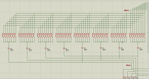

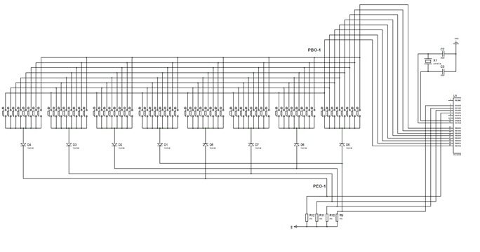

I have question about this fat matrix charliplexing. Assume one of the button in D5 is pressed, how the charlieplexing works in order to send the signal to the microcontroller? How the microcontroller know which of the button is pressed??
I really need to know it, please help me..thanks!

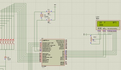

The code can be run now. But the number of button pressed does not display out.
Attached pic is the design when perform the simulation

This is the code that use to simulate the circuit.

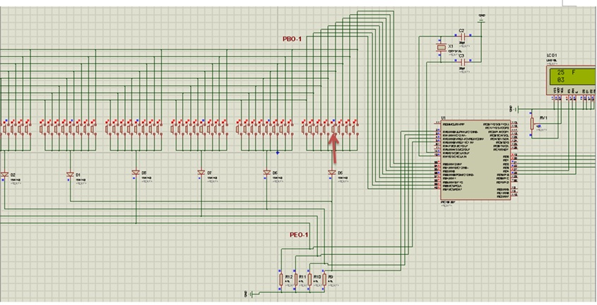

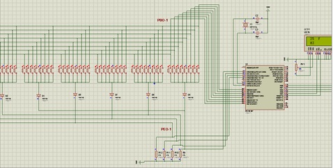

Below is my problem:
1) The number of button pressed will recount start from 0 when reached diode 5-8.
Attached is my edited circuit design:
And this is the picture for the problem occured:
Button on diode 1 is pressed: fd.jpg
Button on diode 5 is pressed: jj.jpg
Below is the code I use to run the simulation:
Hi Vivian,
Sorry, but I can't run the design you provided as there seems to be limitations in the demo version of Proteus.
I can tell you that the resistors connected to PORTA should be connected to 5V and not to ground as you have done. The direction of the diodes should also be corrected.
I will have a look at the code at a later date to see if there are any obvious bugs in the function I provided.
Cheers,
Doug
