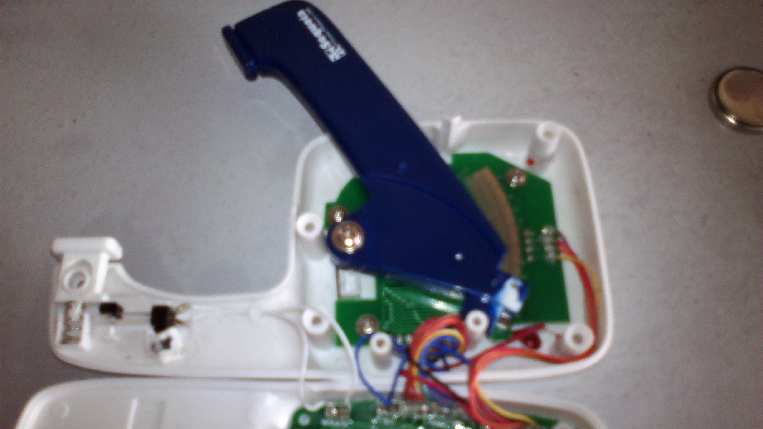

Hi John,
Thanks for the reply. I found that the post #32 that I said the 8 wire is connected with the capacitor and resistor circuit is wrong. So now I still thinking what is the circuit for. Will it be the circuit for the switch?
Vivian
A good, in focus closeup of that part of the board may help, but I don't really see that it is necessary to figure it out. That is at least a double-sided board, and it can be tricky reverse engineering such circuits, particularly when they have a COB and LCD mounted so closely. It is hard to tell what is going on underneath the LCD.
The resistors/capacitors could be part of the MCU power supply, some sort of filter, a negative supply for the LCD, or whatever.

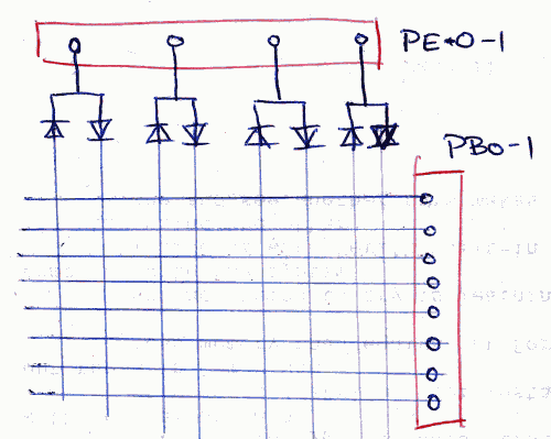

I am confuse with the working of charlieplexing. I not understand how is the charlieplexing work as the input signal in the digital fat caliper. Between, there are 12 wires (8+4), that means all of the 12 wires are needed to connect to the 12 Input pin of the microcontroller?
Vivian
The calliper board doesn't use full charlieplexing, and yes, to use the board as-is, you will need to connect all 12 wires to the PIC. You'll also need a pull-up resistor on each wire (you can use the internal PIC pullups if it has them).
As there is some confusion re what the board does, please have a look at the attached sketch. You'll see the diodes connecting to PE0-1, with the opposite diode end and all the eight wires of PB0-1 entering an 8x8 matrix. Each intersection in the matrix can be connected by the calliper slider contact.
To use the board in the manner in which it was designed, you will need a pull-up resistor (e.g. 47k) on all 12 pins. You will also need to use 12 pins of the PIC. You would then have to scan the matrix to read each of four columns and then each of eight rows to get a single reading.
There are other ways of using the board however. e.g. you can replace the diodes with resistors and add another eight resistors to PB0-1 to allow you to take a reading using a single ADC input of your PIC.
There are other methods too, but the above two are probably the simplest and most reliable.

Is it possible if I direct use the circuit (attached photo) and connect with the microcontroller? If so does, do I still need to add the pull-up resistor?
Vivian
The circuit board with all the contacts (that you've shown) is what I drew the above schematic diagram for. If you connect PB0-1 to PORTB of your '16F877, then you can use the internal pullups in the '877. You will still need 4 resistors to pull up the PE0-1 lines.

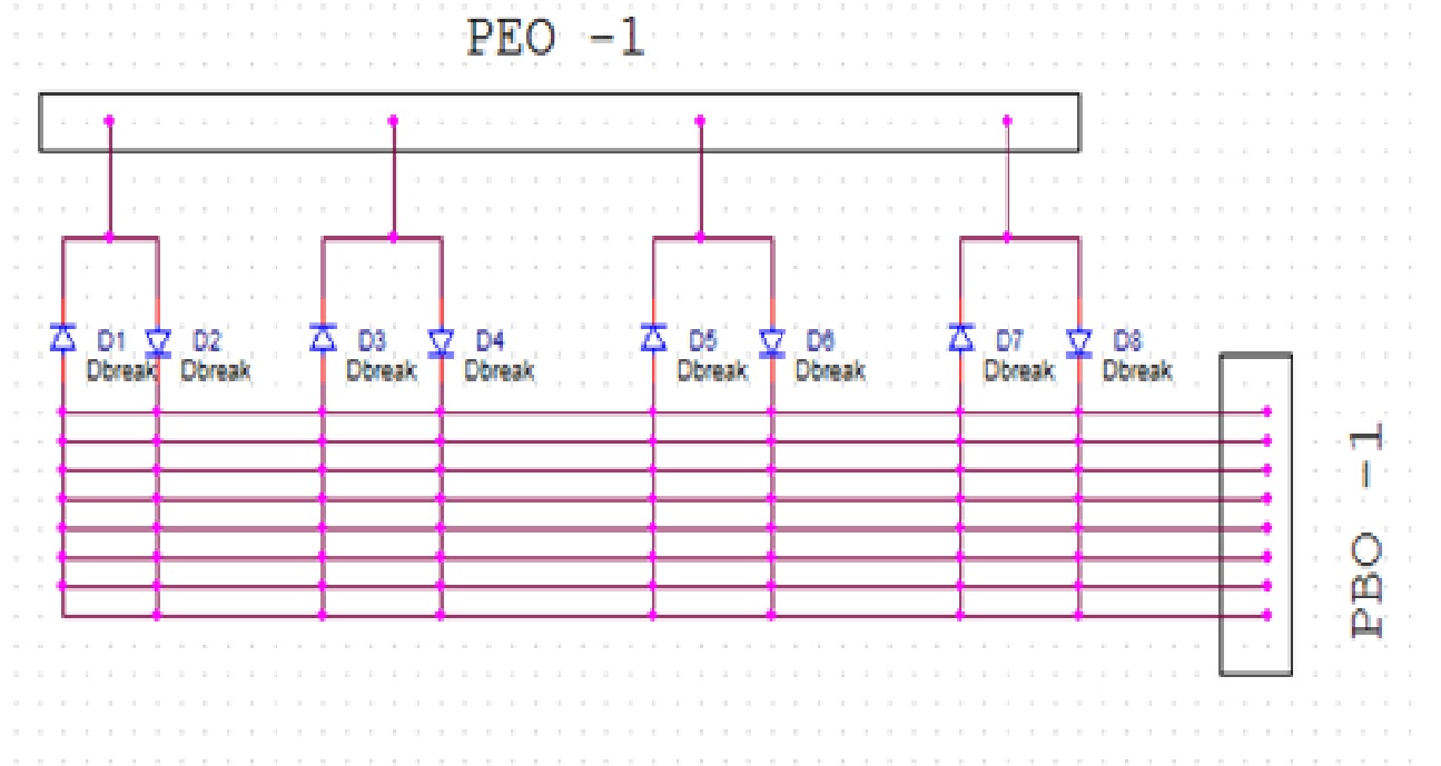

I have some confuse with the circuit that you has attached in post #51. For the wires in PBO-1, is that each of the wire is connected with all the diode? Attached is the circuit that I draw using the Orcade, is that correct?
Vivian
The calliper slider contact can connect one horizontal wire to a single vertical wire at a time. All other wires are disconnected.
