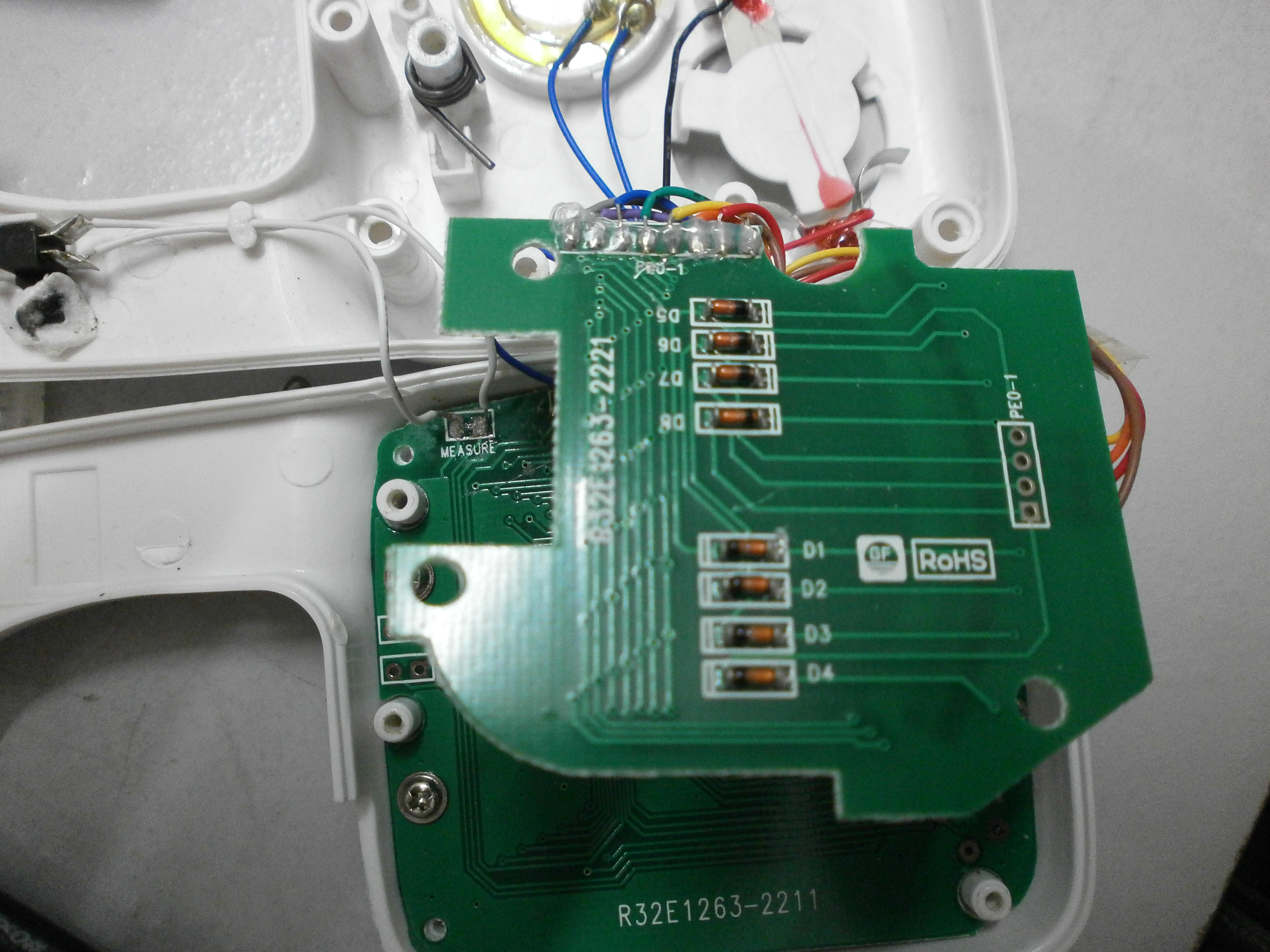

Hi John,
Do you know what is PBO-1 and PEO-1? :confused:
Vivian
The pattern suggests the following:
PEO-1 is the multiplexed output for the 8 ranges to four wires. Using charlieplexing, 4 wires could read 12 positions ((positions = n(n-1)). I suspect it is charlieplexed.
PBO-1 has the eight wires that read the fine divisions withing each range.
Although that pattern seems likely, I would do some testing with an ohmmeter to confirm it. Set the meter to diode test, if it has that function.

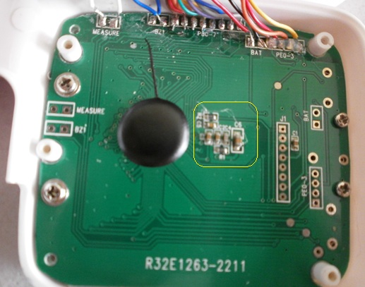

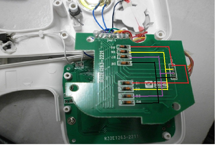

I have perform the diode test, and I found the PEO-1 is same as what you are mention in #26. The connection of the four wires are show in the figure.Untitled.jpg
But for PBO-1, I found that it is not the fine divisions withing each range, i suspect it is connected with the capacitor and resistor circuit as show in the figure below.

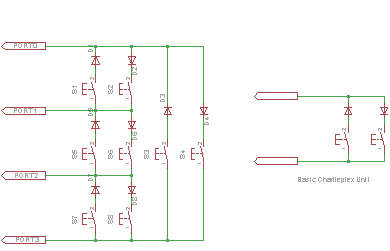

The circuit in post 32 is likely a charlieplex, but there may be other ways to multiplex 8 switches to four wires using 8 diodes. I am neither an expert in multiplexing nor in charlieplexing. The way I look at the circuits is to focus on a single unit (shown on the right), then use that unit to connect different pairs of pins/wires. My concern whether your device is truly charlieplex is related to whether your switches share a common wire.
Since 8 diodes (4x4) will allow 12 switches to be reduced to 4 wires, and you only need 8 switches for the circuit you have, there will be different permutations of how the wires are connected to each switch. With the schematic I have attached and your ohmmeter, you can figure out exactly how each switch pad is connected to each wire.

I don't think those four "charlieplexed" pins/wires carry all of the data. The other eight data pins to which I refer are the 8 wires off on the side. I know they go to some resistors and capacitors on the other board. That could be a way to reduce the number of inputs to the MCU, e.g., the on/off signals could be converted to different voltage levels and read by a single ADC on the MCU. It could also just be for filtering electrical noise. There are a lot of unknowns. With a chip like the 16F887 you could read all 8 wires as a single port.
