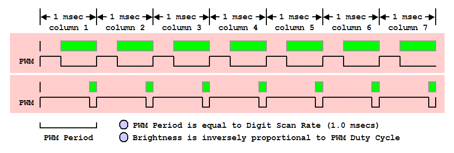

Mike, how can this circuit have brightness control? Can you do a timeing diagram showing the PWM signal in relation to the update signals for setting the segment values?
I use a 1 msec PWM period and I 'scan' the display columns using that 1 msec Timer 2 interrupt. The displays are blanked when the PWM signal is high at the beginning of each interrupt cycle and that's when I borrow the column driver lines RB1 and RB2 to load the MIC5821 shift register. One display column is turned on when the PWM signal goes low. Varying the PWM duty cycle between 2% and 100% provides full fade-to-black brightness control from 98% to 0%, respectively. The interrupt driver (listing below) uses 12 instruction words plus a few instructions later on to setup the SEGDAT and COLPOS variables for the next 'scan' interrupt cycle. You don't see anything in the driver code for brightness control because it's pretty much an invisible background process. Simply change the CCPR1 duty cycle register at any time in your Main program to adjust display brightness.
The green area in the drawing below is the portion of the digit or column scan interval where the display is "on" (during the PWM "off time").
brightness-control-png.15769
;  The seven LED columns are 'scanned' one at a time at 1-msec
;  interrupt intervals for an overall 14.3% LED duty cycle and
;  142.85-Hz refresh rate...
;  A minimum PWM 'on' time of 2% guarantees a minimum window
;  of 20-usecs (80 instruction cycles) at the beginning of
;  each interrupt cycle where PWM drives the <OE> input high
;  (display off)...  This allows me to reuse the RB1 and RB2
;  column driver lines temporarily as '5821 <DAT> and <CLK>
;  lines to load the '5821 (without messing up the display)
;  before RB1 and RB2 resume their column driver duties when
;  PWM drives <OE> low (display on)...
;  The 2% minimum PWM 'on' time limits maximum brightness to
;  98% but the 2% loss of brightness is inperceivable
ISR_LED

ISR_Column
        comf    COLPOS,W        ; invert bits (only 1 bit low)    |B0
        movwf   PORTB           ; setup the column drivers        |B0
Ah i think i see what your doing:
When the PWM goes high
1. Set MIC5821 output to off (linked to PWM signal)
2. Clock in the required 7-seg code into the MIC5821.
3. Enable the next digit RBx line.
When the PWM goes low, the digit is shown. All other digits are off.
Repeat for each digit.
This means that each display is lit up in turn, and is on for 1/7th of the total time required to show all 7 digits as they take it in turn.
In that case, does the current to the display have to be 7 times greater than the normal If ? E.g. a 7-seg element may be rated at 25mA, so it should be driven at 175mA ?
