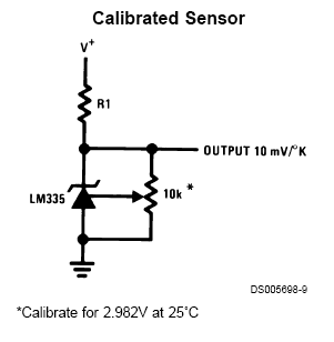

I got a bit sidetracked and I have only just now managed to build and test the circuit Len kindly designed for me. A couple of things are confusing me. Originally I planned on using a voltage divider to give me the reference voltage of 2.532V for the inverting input. My voltage divider had 5V - 9.75K - 10K - Gnd which should give 2.532V. But on Len's design the voltage divider is 5V - 10K - 9.75K - GND with an extra variable 200 in series with the 9.75K, but this only gives me 2.468V - 2.494V. Is there a particular reason for this?
While testing the circuit I am finding that the temp readings are 7 - 8 degrees C too high. Even swapping the resistors in the voltage divider around doesn't change this much. I am trying to get my brain around the circuit and how it works but I am struggling. Would varying the reference voltage to the inverting input be a way of calibrating the circuit? Are the resistances used for the voltage divider (10K and 9.75K) important to making the Thevenin resistances on the + and - inputs equal? Can I replace that part of the circuit with a multiturn trimpot and if so, what value would I need? I have a 10K one, would I need a 20K one instead?
Any advice will be a huge help.

The supply voltage might not be 5 V exactly. You can add another resistor between the trimmer and ground.
You can use the multiturn trimmer to calibrate the LM335 instead. That's what I usually do.
Yes, you are right, it is approx 4.98V.
I was hoping to get away with just 2 wires to the sensor. The sensor is going to be external and I was thinking of using an RCA socket and mount the LM335 on one end of an audio cable. I'll have to do some experimenting, thanks.
I think I have it sorted. I put in a bigger trimmer and adjusted the voltage divider to create a more accurate 2.532V reference and now it is pretty close to correct. Once I make a waterproof sensor I can play with some liquids at different temps and compare it to an accurate thermometer and see how close it gets.

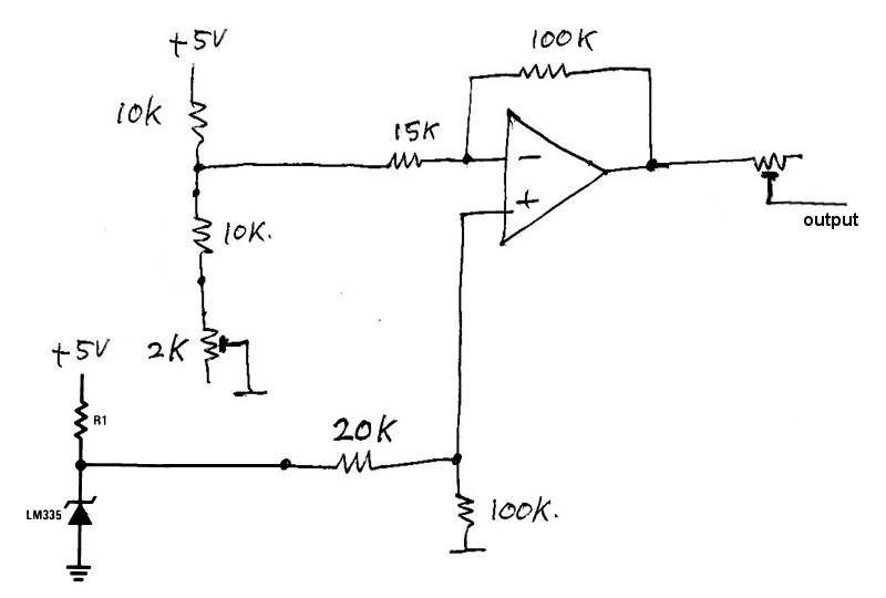

Me again, its taken me a while to make a waterproof LM335 sensor and get another digital thermometer to make some comparisons. Readings are pretty close but I think I would like to try these recommendations above. I have modified the drawing Len did for me and attached it to show what I have and what I think Leftyretro is suggesting.
What I am not sure on, (more stupid questions) what resistors do I need to change to change the gain from 5X to 10X? And what would be a suggested value for the 20 turn trimpot on the output?
If this circuit is correct how would I calibrate it properly? ie how would I set the "zero adjustment" pot and the "range pot"?

To double the gain, you could double the values of the two 100k resistors.
If you connect one end of your output pot to the opamp output and the other end to ground and take your output from the center "wiper" of the pot, any relatively-high value pot should work. With the wiper centered, you would get half the opamp's output voltage swing. Higher resistances generate more noise. So you probably won't want to go overboard; probably something between 10k and 50k would be OK for the pot. Also, your opamp's datasheet might have information about what resistance is best, on its output.
For calibration, someone else will probably have the answer. But conceptually, if you had a signal generator that could produce a waveform with your 1V p-p amplitude, and also provide a DC offset so that the signal generator's output was covering the same range that your temperature sensor would cover, then you could just connect the signal generator in place of your sensor, connect your circuit's output to an oscilloscope, and adjust the pots until the output was covering 0 to 5 Volts. Actually, such a signal generator could be easily and cheaply built, with another opamp or two (and in many other ways).
By the way, there is some very good basic information about the common opamp topologies in https://www.electro-tech-online.com/custompdfs/2007/06/AN-20.pdf and https://www.electro-tech-online.com/custompdfs/2007/06/AN-31.pdf .
You might also want to go to http://www.analog.com and search for AN-273, if you think you might need to use a long cable run, and/or might need to combat the effects of RF noise.
In your circuit, I think I would at least consider placing a 0.1uF (or so) capacitor from the junction of the two 10K resistors to ground. You might also want a few pF in parallel with the 100K (or 200k) feedback resistor, and 0.1uF or so in parallel with the 100K (or 200k) that goes from the opamp's + input to ground. And, naturally, you probably already have 0.1uF and maybe also 10 uF from your opamp's power pin to ground.
If you need high precision and good noise rejection, you should probably consider using a pure differential amp, with 0.1% matched resistor ratios, and a separate opamp for the scaling. Or, maybe better, use an instrumentation amp and the separate scaling opamp. The better topologies are discussed in some of the IC manufacturers' application notes.
Also, it seems like you are at the mercy of the 5V supply level's accuracy and precision. If needed, you might want to consider finding a way to get a better voltage reference.
There are some very good application notes about temperature measurement to be found, by going to national.com, linear.com, and analog.com, et al, and searching for "thermometer", for example.

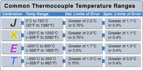

Instead of trying to get the LM335 to do the task why not search for a better temp IC !!!!
Note you cant get 0.1 c accuracy from a device that is not that accuarate ie +-3 degrees if you want the accuaracy got to go a K type thermocouple probe and something like AD595 then you can get what ya want ( i have code and schematics but I was measuring 600 c and higher !

Well actually thermocouples are not all that accurate either. Purity of metals used and quality of construction make only the higher cost lab quality TCs capable of decent accuracy but no where near +/- .01C. TCs strengths are in their wide temp range, ruggedness and lower costs.
RTD sensors are considered much more accurate then TCs but even then +/- 0.1C is probably not obtainable except for selected high cost lab types. In many practical applications good repeatability in a sensor is all that is required and doesn't carry the costs of extreme accuracy specifications.

I am afraid you are wrong on the thermocouple they produce a known voltage per degree the typical value for a K type is 40.44 micro volts/°C if they use impure metals that voltage would not match the specification for a K type as such metal purity is very consistant I have used these devices along with AD595 and can very easily get 0.1 c reading and yes I have had it checked with calibrated meters.
The AD595 converts the 40.44micro volts per degree to a 10millivolt/°C depending on the analog to digital type you will be able to read fractional values of a degree. The errors come into play are caused by chips(AD595 and the ADC) itself not the K type probe( two well specified metal types welded together under controled enviorments) but I conceede there could be manufacturers who make bad ones!
Any chip errors can usually be sorted with a lookup table to correct it.
All thermocouples have a certain error that needs to be compensated in the temperature controller.
There's no way to remove that error from the thermocouple.
Thermocouples are not calibrated against "calibrated meters" like you wrote but needs calibration in a furnace with a reference thermocouple.
That last one has to be calibrated in thermal labs with so called ice bath or fluidized beds.
If you need accurate temperature reading use RTD not thermocouple.

Well your response to my posting borders on being a little rude as well as pretty uninformed. You most likely don't have much real world experience with TCs. I've worked with them for 30 years. Attached is excerpt from Omega Engineering, a leading supplier of TC sensors, cable and supporting equipment. Their site has tons of free publication information that can maybe help better educate you on the subject.
https://www.omega.com/
Lefty
